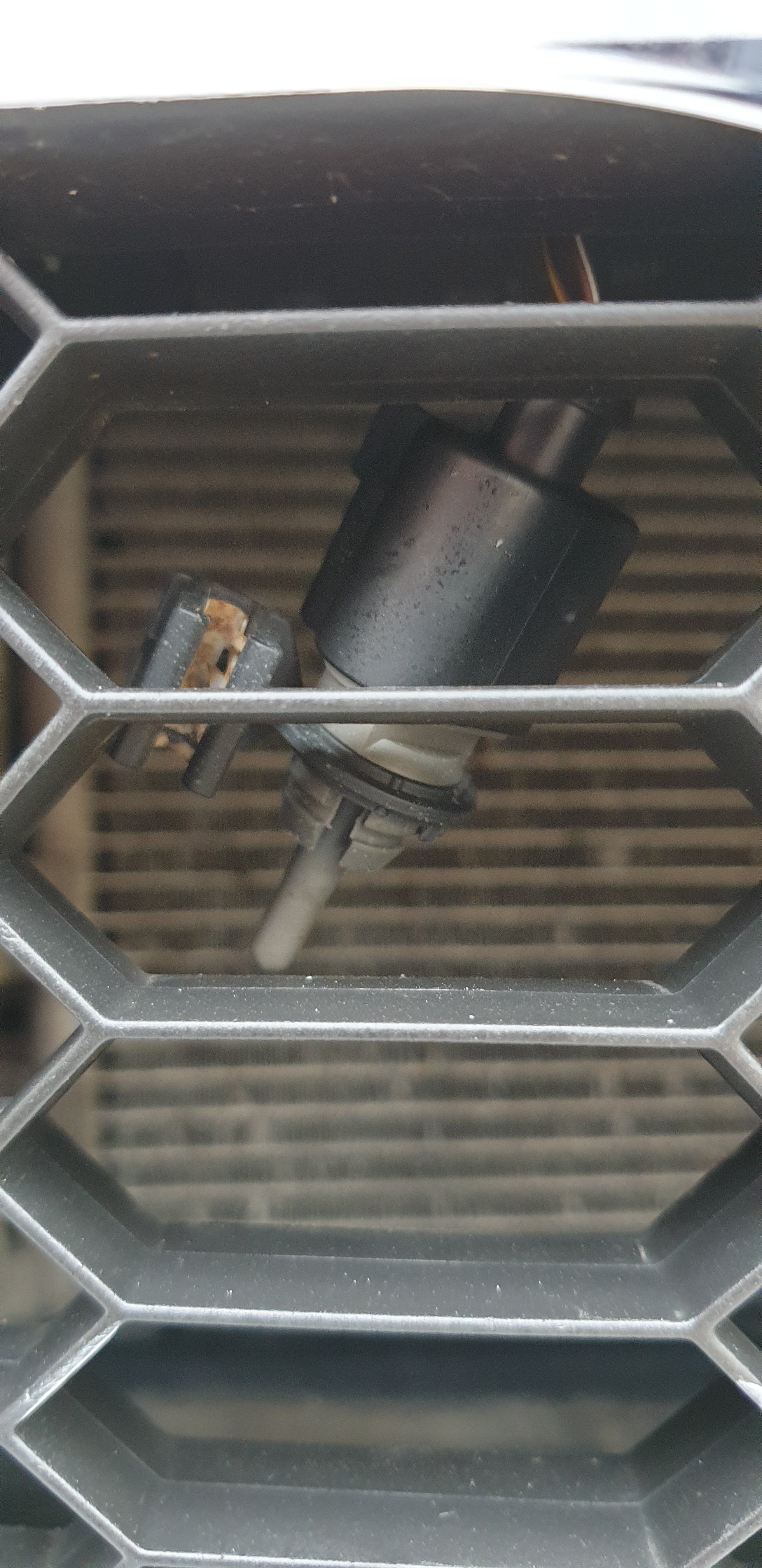

Just cleaning some bird dirt from the front of my car and noticed something dangling behind the front grille of my VRS. I can't see it from under the bonnet so does anyone know what it is? I'm assuming a temp sensor? Cheers

I have the same problem, i have some sensor hanging down behind the grill, my outside temp sensor seems to report -.--  any idea what this sensor is??
octavia vrs..

Looks similar to mine. Clearly it was clipped to something at sometime. Hard to get to thanks to the undertray and plastic covering everything.

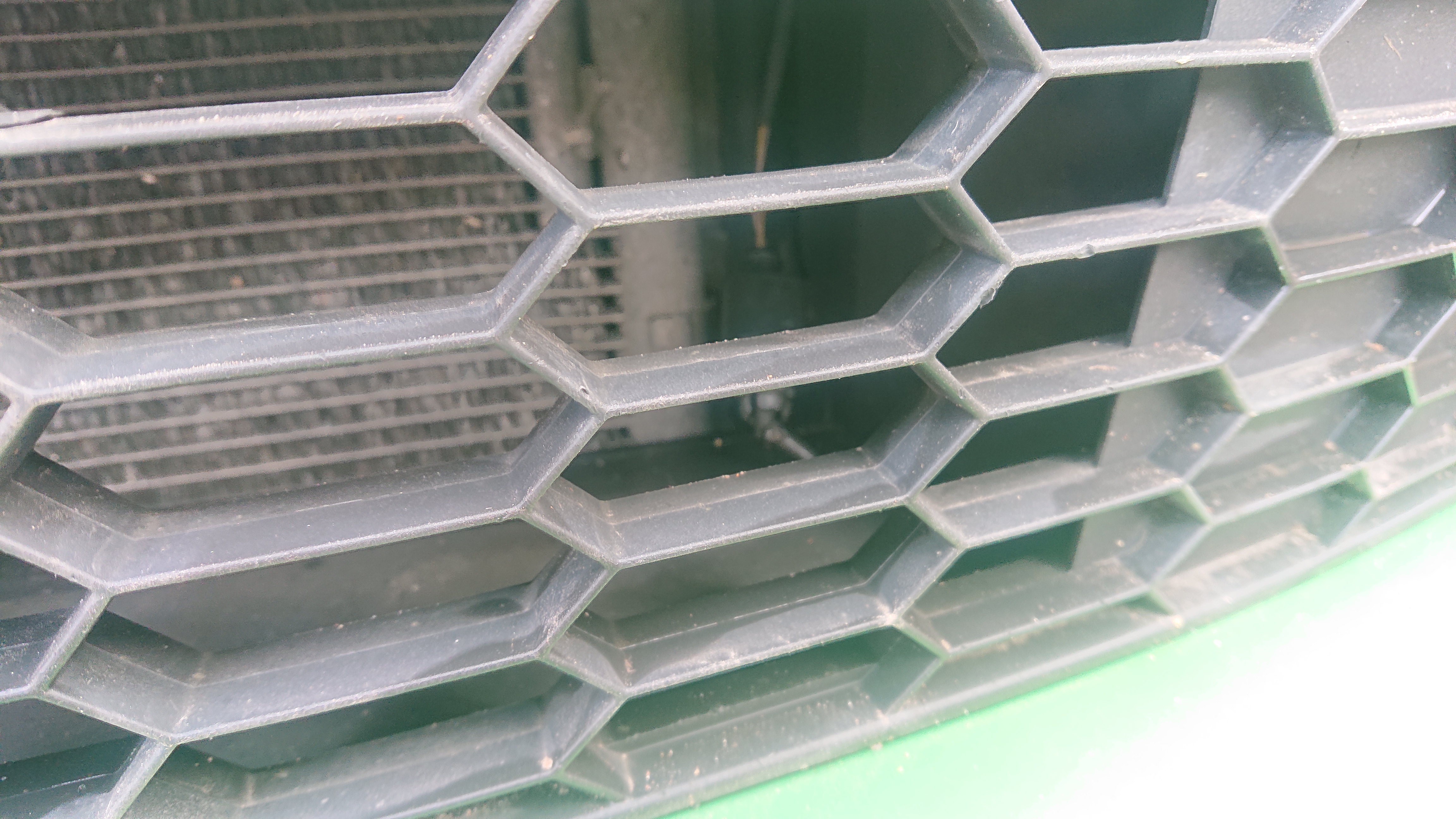

mine seems to have snapped as well,
No clues anyone?
With that in mind, is it easy to remove the undertray so I can have a look? My car is under warranty but not sure this is a warranty item. I'd be happy to re-attach it myself if it was easy to get to.
Pretty sure it's the outdoor temperature sensor you're both seeing. Certainly matches the position on various other VAG cars.
No idea what the easiest way to refit it is I'm afraid.
Yeah, it definitely belongs somewhere and shouldn't be free range. The thin part of that looks like a plunger switch of some sort. Does it move? Bonnet open sensor?  In an ideal world, you Skoda dealer would be kind enough to have a quick look for you.

I think it just clips onto a piece of plastic somewhere.
I'd be tempted to fix it sooner rather than later as flapping around could damage it's wires. It looks like part number 11 on this diagram:

£96? They're good aren't they. :rolleyes: Well, having looked at part 11 in the diagram above and the video posted, I think this could be repaired for about 10p. Whip the undertray off and cable tie it to the cross beam (part2 in the diagram).

Given how close it is to the grill, I would cable tie it to that for now to save it from damage. Perhaps when the weather is warmer, pop the undertray off then.
