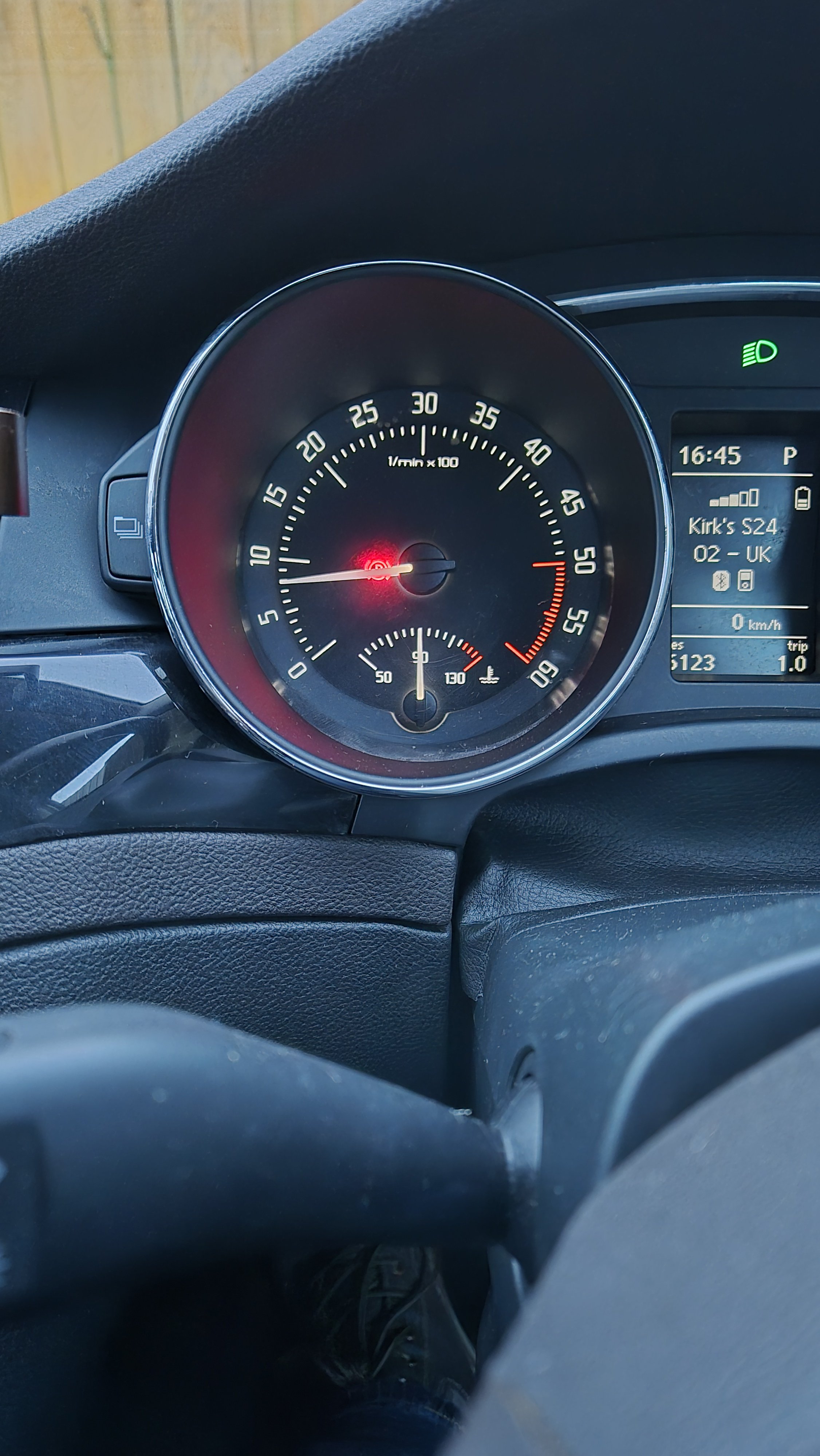

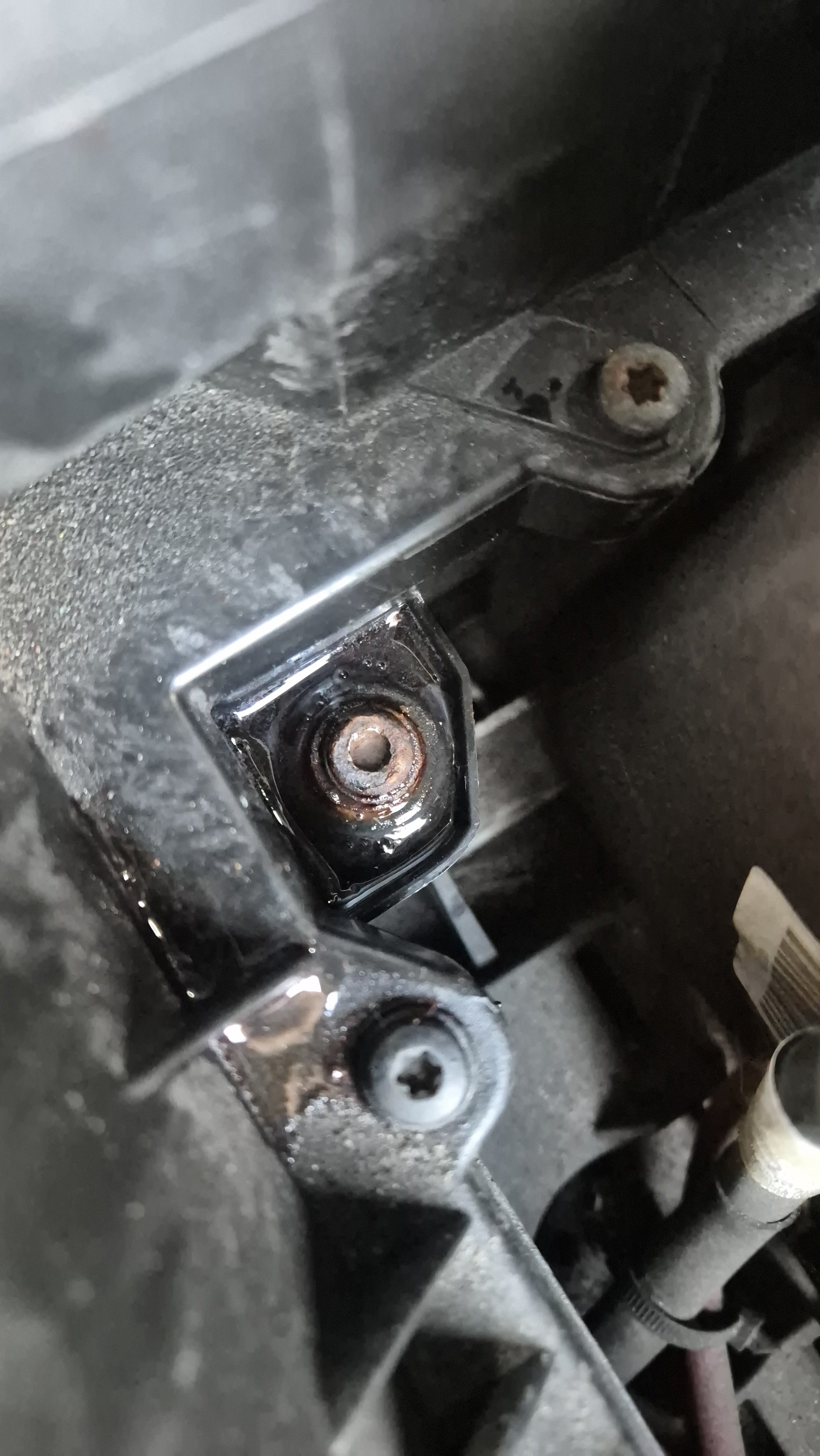

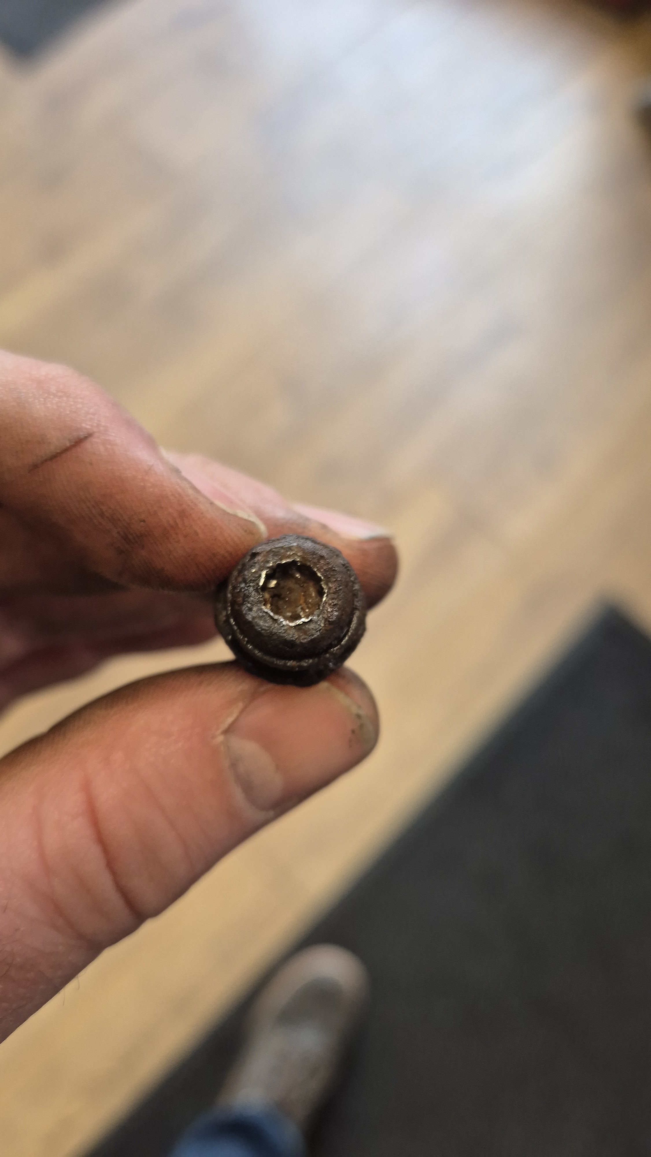

I have done this job today. It wasn't the most straight forward due to the bolt that holds the air box in place being badly corroded. Then the coolant hoses being put on by Thor himself.
Anyway all fine now and car went straight up to temp and is now lovely and warm inside.
I have also notice more power and smoother gear changes. Seriously it feels like it had made a big difference.
