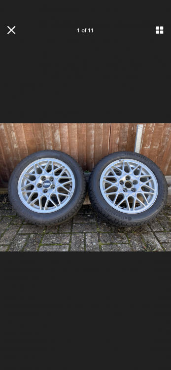

Hi guys I have a 1.2L mk1 fabia and I need to get new wheels to replace my hub caps. I was thinking about getting the wheels I have attached but wasn’t sure if they will fit without having rubbing issues? The tires on them are 205 55 r15. Thanks351430EC-F9F0-4964-A3B2-51E86A1DFEC9.thumb.png.ab9c27b28db837a41fc31b8440a7c361.png

They’re actually 205 50 R15 not 55
What width are the rims? and what offset are the rims?
For example, 6Jx15 ET38 would mean that the rim is 6" wide and the offset is 38mm.
These details will be cast into the back of the alloy rim.
Are they aftermarket rims or VW group rims? ie. VW/Audi/Skoda/Seat. If they are VW group rims, what is the OEM number? This number will also be cast into the back of the rim.
What load index and speed index are the tyres? eg. 205/50R15 86H would mean that the load index is 86 and the speed index is H.
Do the rims have a 5/100 PCD? and do the rims have a 57.1mm centre bore? ie. are they physically capable of being bolted onto the Fabia.
