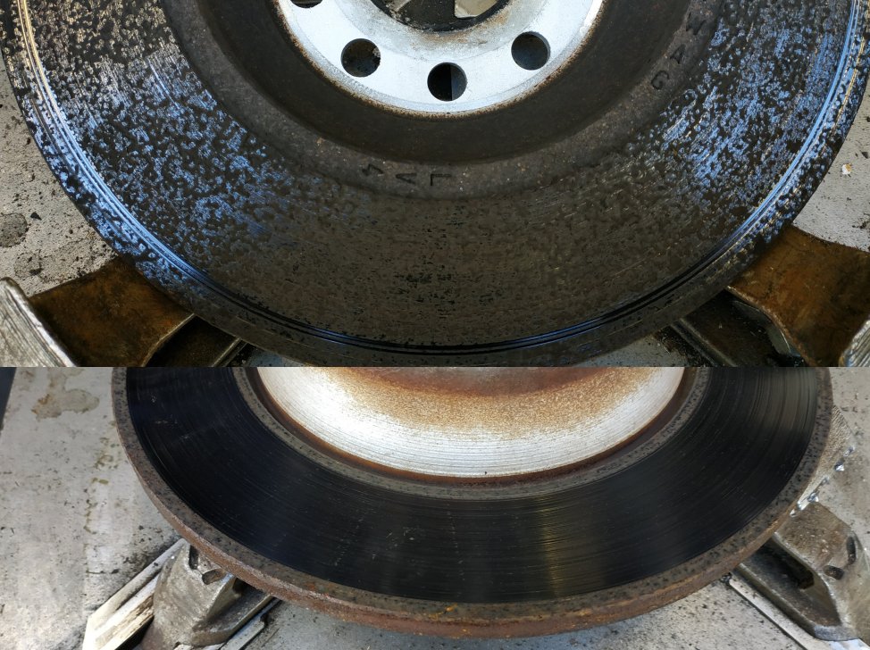

I know it’s only 14k miles total and not being used as much recently, but I'm still out twice a week for city driving. Inside of the discs were quite bad and pads were almost gone:
Edited by Alan_P
All that after only 14000 miles??? You should stop making handbrake turns... :D
