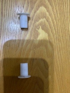

I've attached a picture of the two plastic sheaths which need replacing and fit either side marked number 3 in the Alloy cast marked A.
