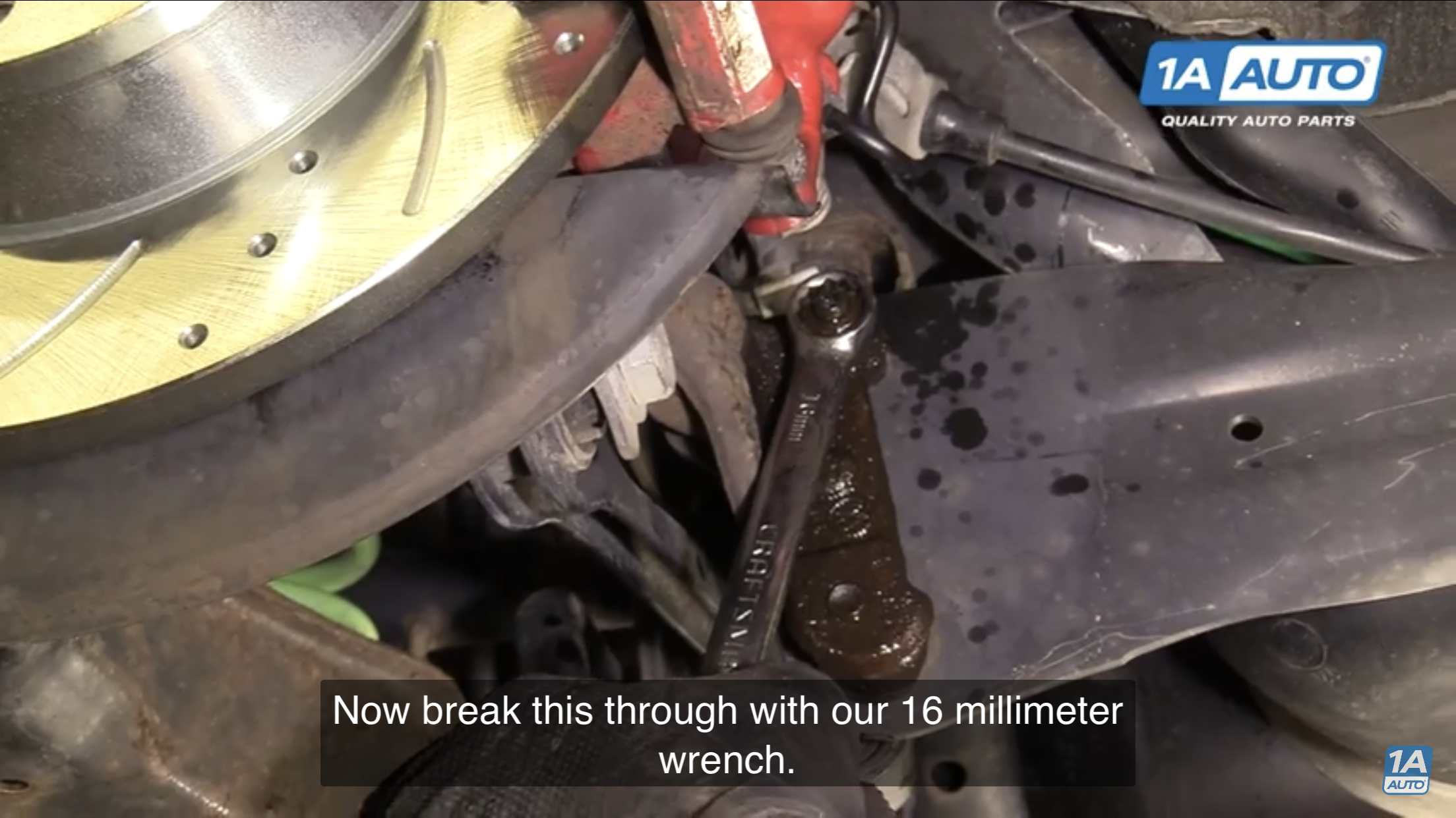

Did the ARB link snap off the ball joint? If so, while I was looking for ways to solve my problem I came across this idea (second half of video) where it shows putting a groove into the ball to get some grip.
