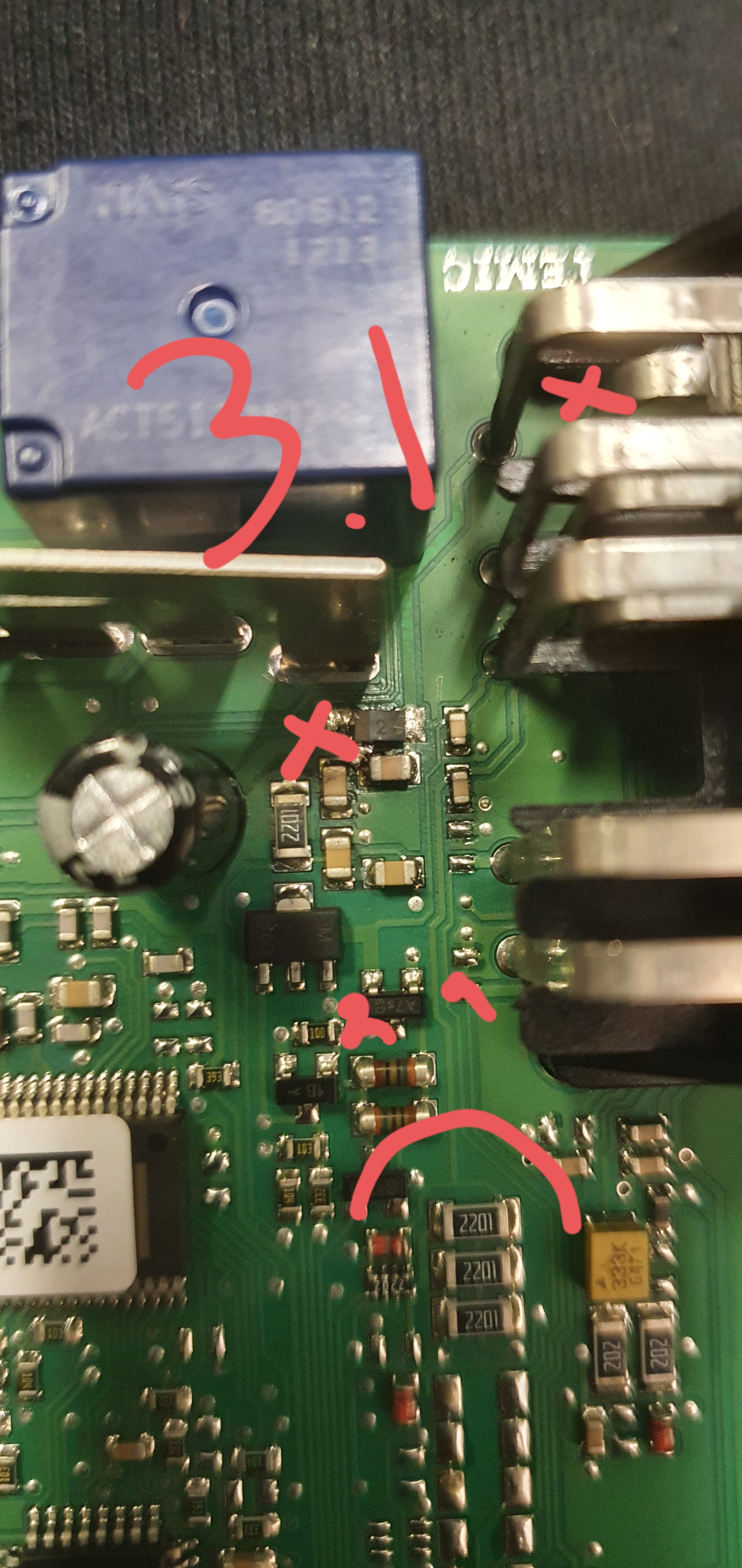

So just as a test I swapped modules from passenger to drivers side. The relay in the PCB is clicking like never before. @Wino I can't get to fix the capacitor on the PCB to get 12. I re-soldered as best as I could but still getting less than 1v.

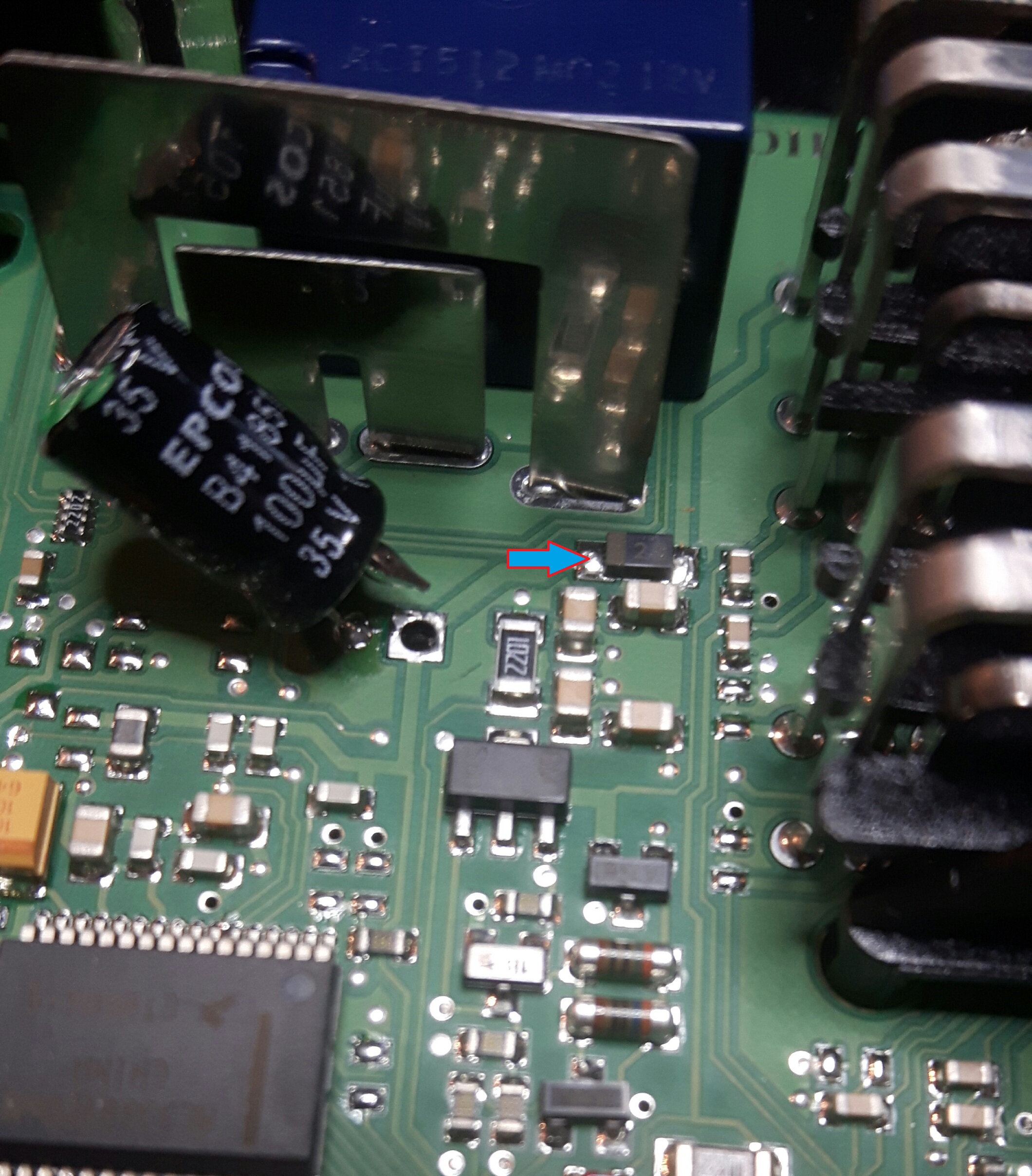

I wonder if the person that swapped that capacitor has damaged the pad that the positive terminal goes to?  I'll just make a little demo of a possible fix for you and post a photo.
  • Sponsor
With the 8-way connector plugged in, measure voltage at the point arrowed here, instead of trying at the capacitor solder joint.  It could be that the component to the right of the arrow  (a diode) has been shorted out and blown up.  You can see the tracks go from that diode to the capacitor and onwards towards other stuff.
Note that tilting the capacitor over like that (as I've done purely to show the tracking under it) is likely to damage the capacitor so don't do it unless you have a spare.
In fact, measure voltage both sides of that diode (red meter probe on each diode solder joint in turn; black probe to the earth connection - the pin that thick brown wire goes to).

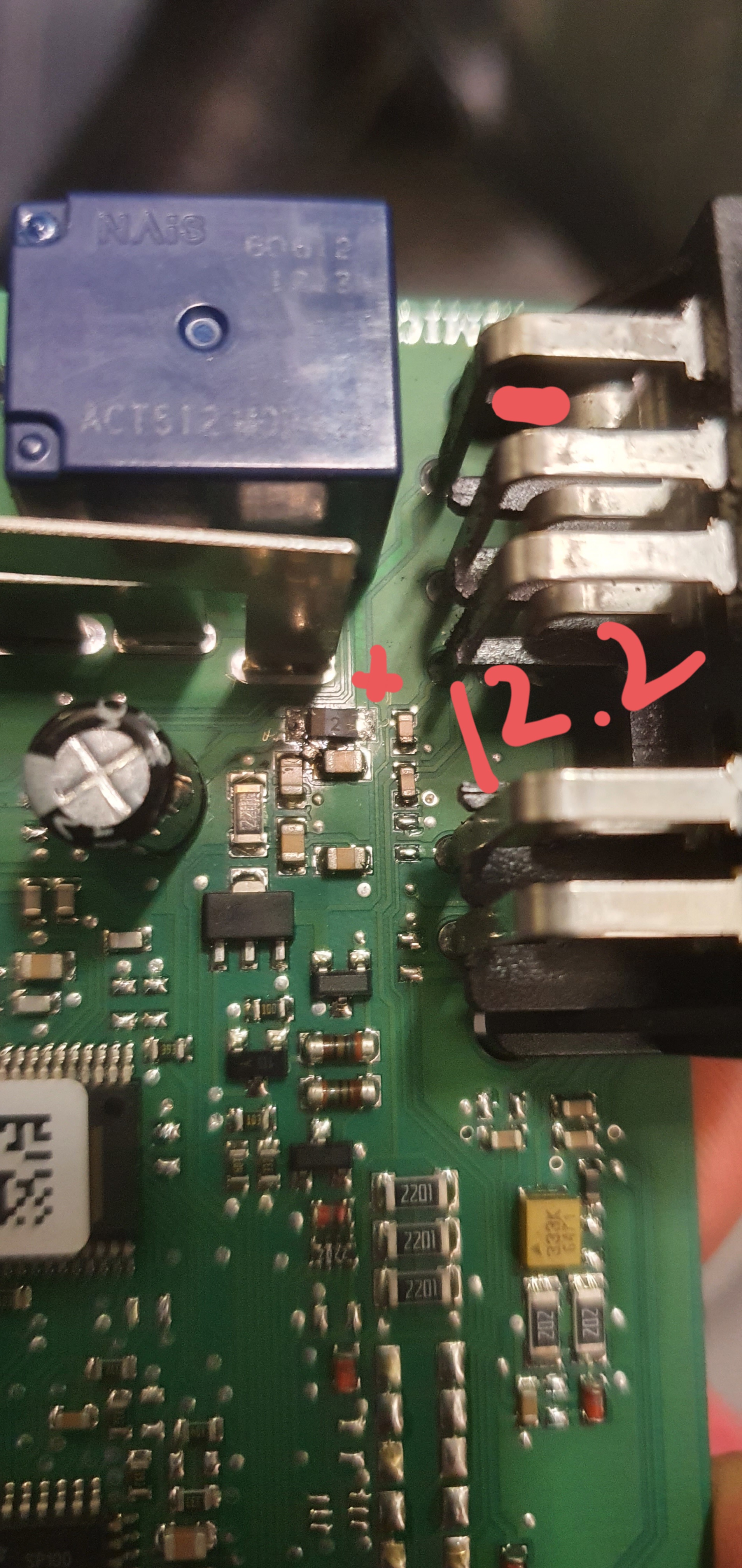

I did - and plus where pointed in the picture. Is that what you mean?

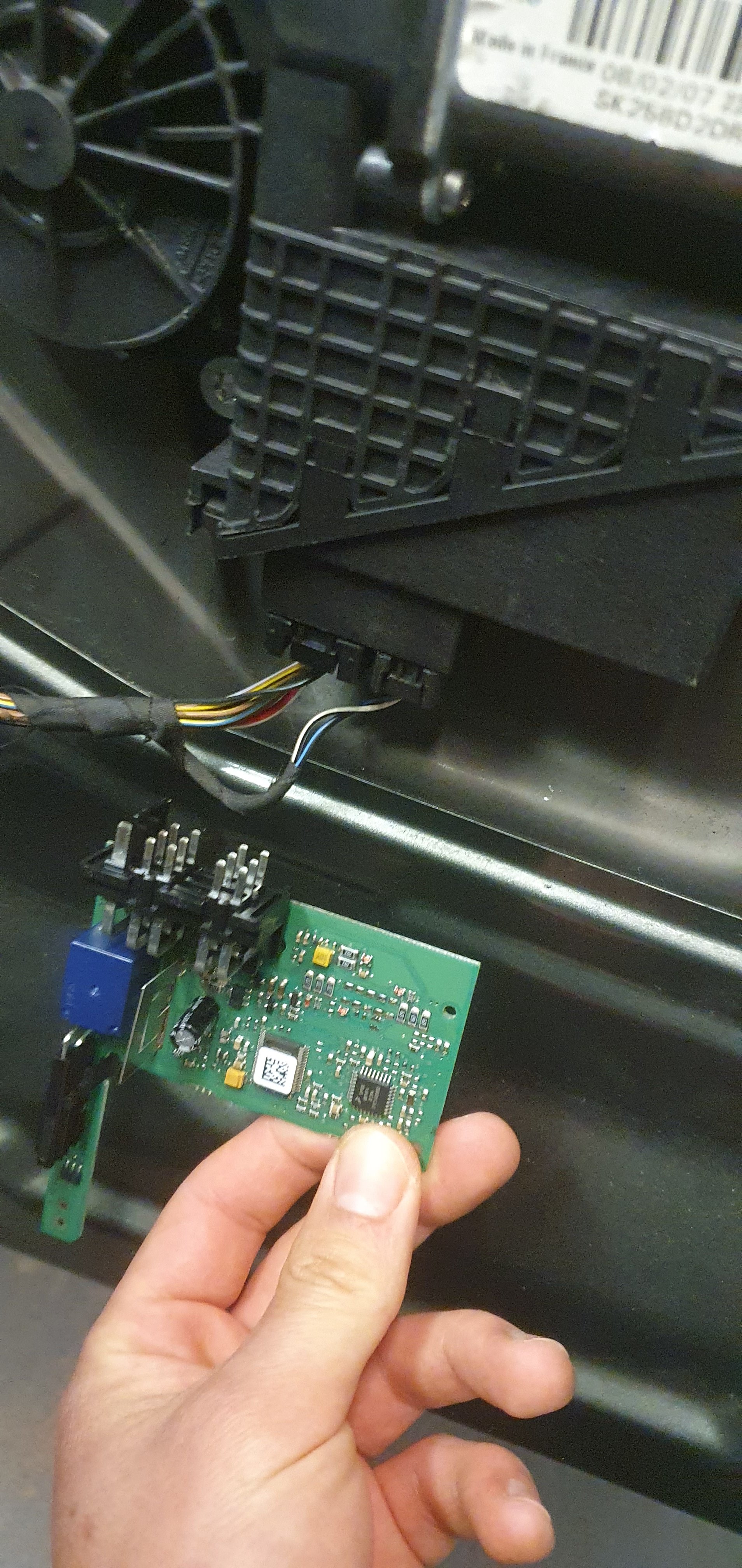

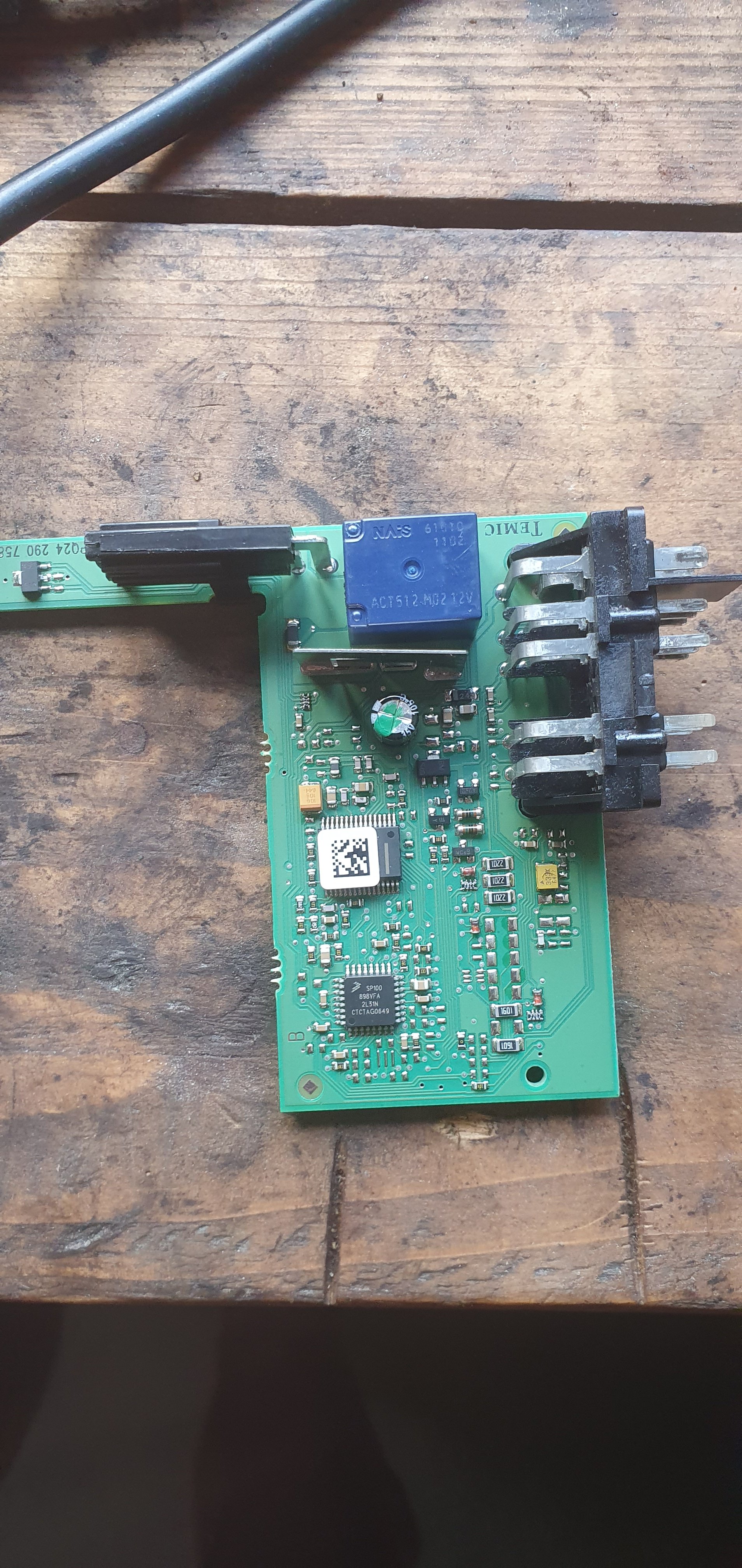

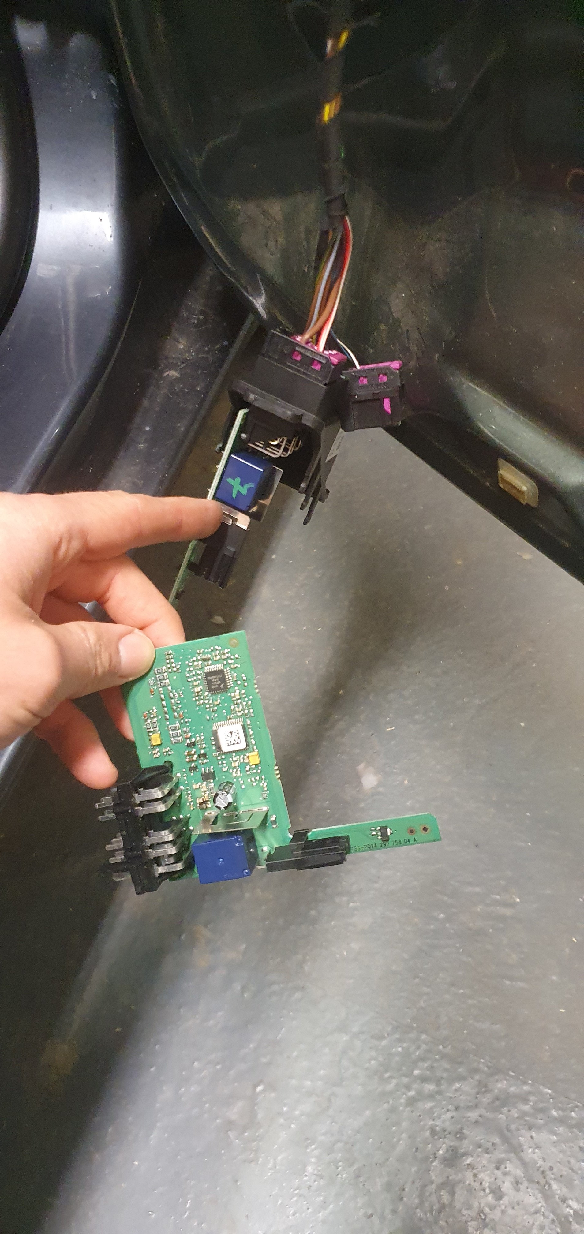

@Bertie90 I'm also curious about the difference(s) between the circuit boards inside the passenger and drivers side window motor modules. I've only got a drivers side one to look at, do you have a photo of a passenger side one? The actual circuit board.  I think some of the photos in this thread may be of the passenger side one from your Roomster, but I want to be sure I know what I'm looking at, rather than assuming.  Everyone says the drivers side is the 'master' unit, so it would be nice if there was some obvious difference, like a simpler circuit board with fewer bits fitted or something on the passenger one, so you could tell just by looking at one.
On 29/04/2021 at 15:09, Wino said:
I'll take a clear picture of the passenger board. Yes there are differences I noticed. It doesn't look like at a first glance but there are.
The early Roomster hasn't got the up/down down windows remote function. I checked with my fake vcds. But the 2013 Fabia does have that module/option which I can select.
Passenger
