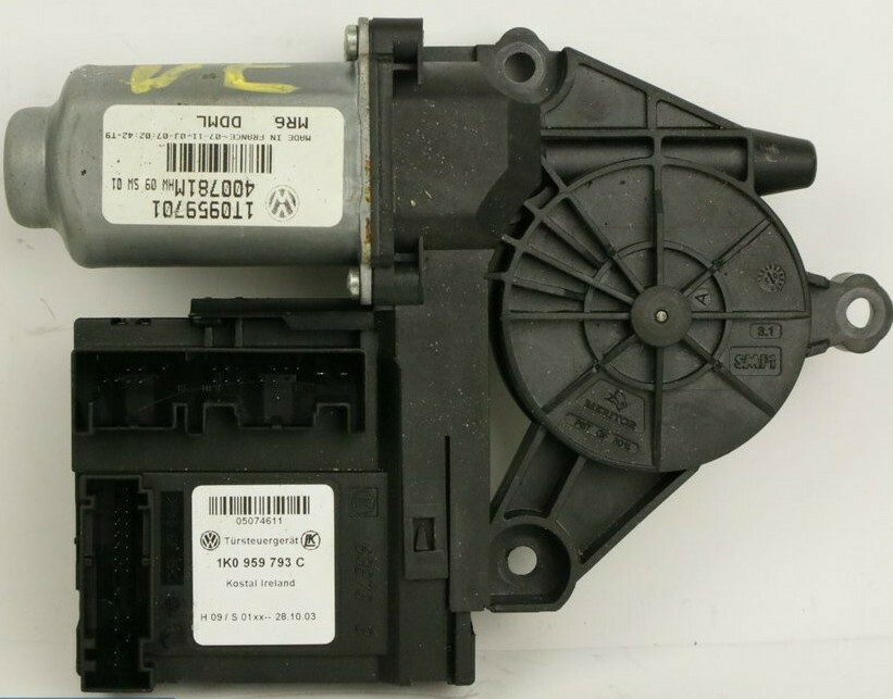

Does a different door  module will need coding by any chance?
Image 1 - VW-SEAT-SKODA-RIGHT-DRIVER-SIDE-FRONT-WINDOW-MOTOR-CONTROL-MODULE-1K0959793C
No.
I don't know where to begin.
I bought another module, with the same part number but somehow it had written 2001-2007 on it. Mine is a 2007. I guessed that they must have been using the same parts from previous models. Anyhow, the connectors look to fit but the module inside looks different. Plugged it in, and didn't work.

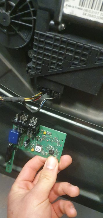

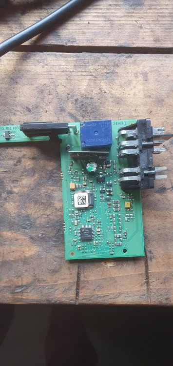

My next thing is to replace the relay and capacitor on the module.
