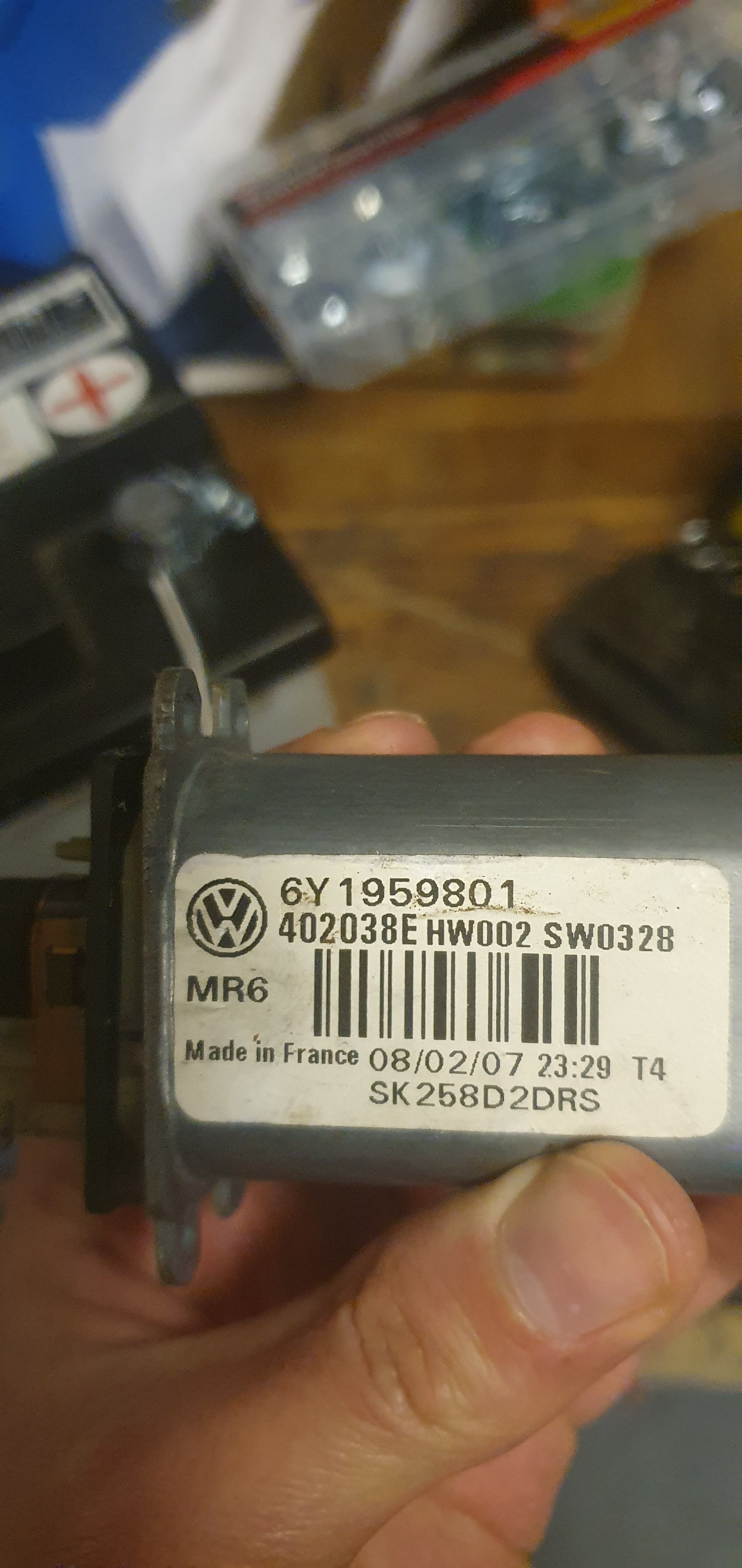

I don't remember the part number for passenger but I will check this evening. This is what's on the driver's side now.

thats the correct one for DRIVERS DOOR RHD...............although the issue could be where its made :D

The bottom line of that part number label has me a little confused.
Looking here, for cars built up to 04/11/07, the full part number (for driver's side RHD) given in ETKA is 6Y1959801 SK3.
The only bit on yours that looks anything like this SK3 suffix actually starts off SK2... on that bottom line.*
This page suggests that the 6Y1959801 SK2 part was only fitted to Roomsters: Buy 6Y1959801SK2 window regulator motor Skoda genuine OEM part (oemwolf.com)
Wait, did you already swap another module into driver's side? This SK2 one? Have you still got the old/previous one? Did that one ever work right?
*Information that I came upon later suggest that this bottom line of info on the sticker probably doesn't have any direct correlation with the "SKn" suffix shown on ETKA pages anyway.

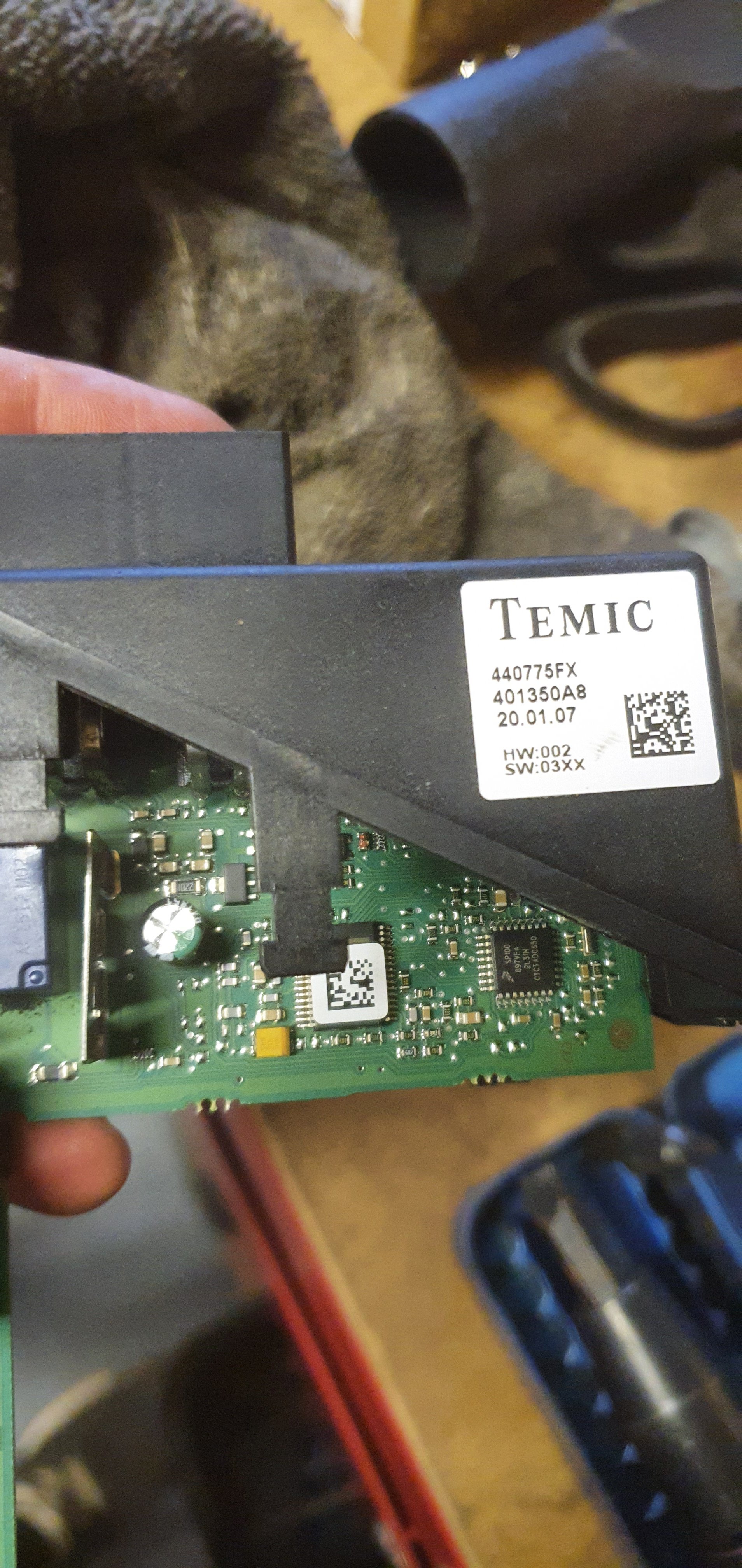

I did buy another one but....for someone reason it didn't work, and it looked different inside the PCB, yet the connectors plugged in fine and had the same part number. Now, when I was plugging back the original, then it worked for a few minutes. Basically the replacement never worked but it didn't something somewhere. I sold the replacement on eBay. So still have the "original"

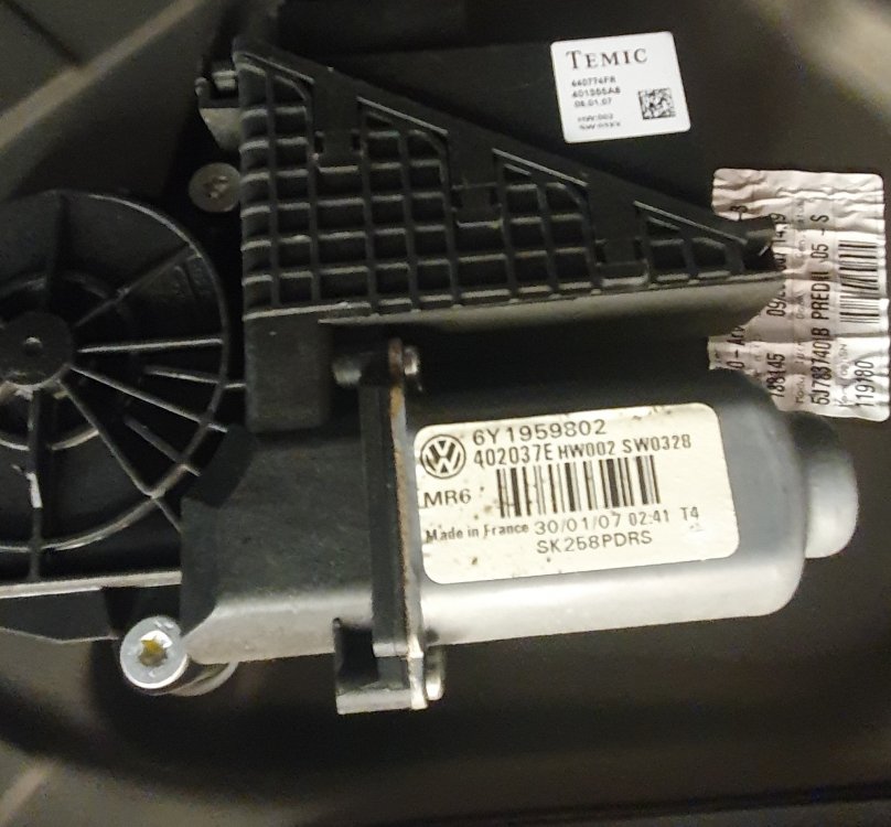

Sorry, of course makes sense. Fyi, this is the part from the passenger door.
