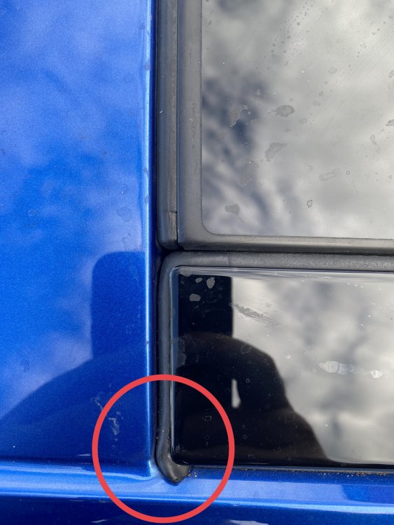

Update on this guys. Might help someone else.
it wasn’t the infamous sunroof hose after all. Which I always doubted anyway as the roof cloth was always bone dry.

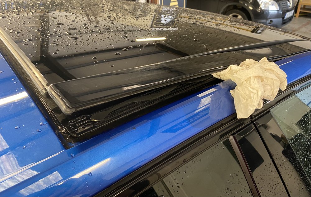

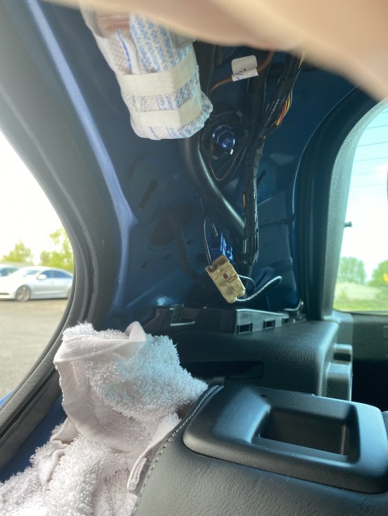

Anyway noticed the rear was soaking again and so decided to do a more thorough investigation.

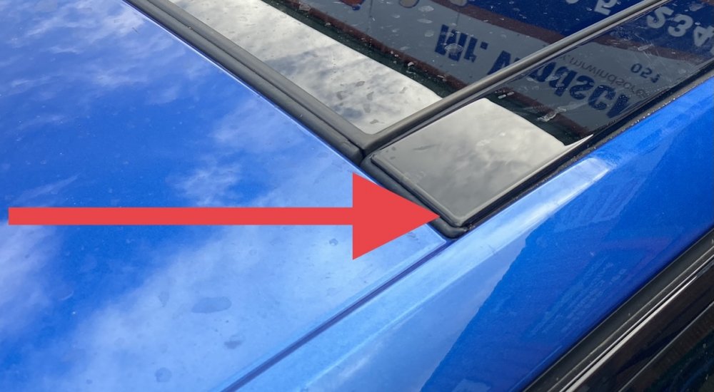

Traced it back to the sunroof area for sure by doing localised water tests and watching for the water coming in ( which was coming in at the right hand rear, in the quarter just behind the door)
Checked all runoff pipes and poured endless amounts of water into the sunroof channels and it came pouring out over the wheel wells as it should. No water coming into through the rear quarter. Closed sunroof again and poured water over it and water coming into the car.
So it must be the sunroof subframe where it’s bonded to the roof. Could be a hole in the seal. That needed removing the plastic surround to get a better look.
Did that and couldn’t see any obvious gap in the seal but when I poured water there it vanished quickly and poured in at the rear quarter- so that was the problem ( we thought). Anyway, primed and sealed the subframe. Left to dry and water tested. Water still coming in 🤦‍♂️🤯

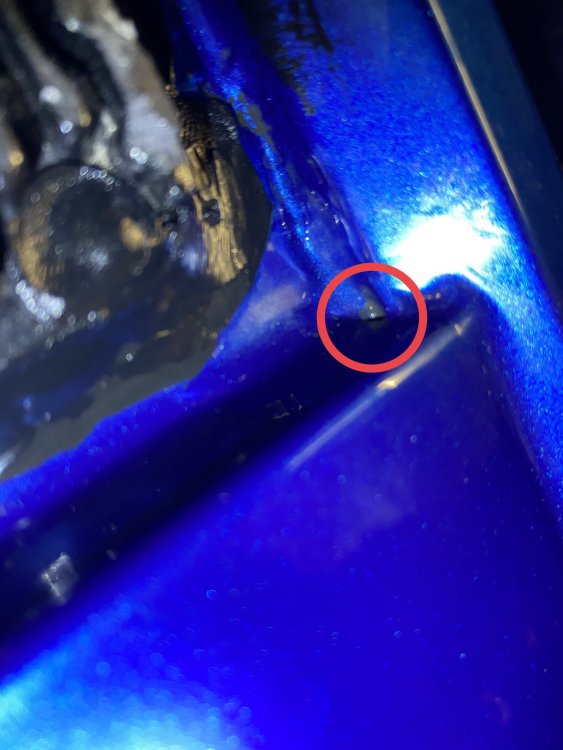

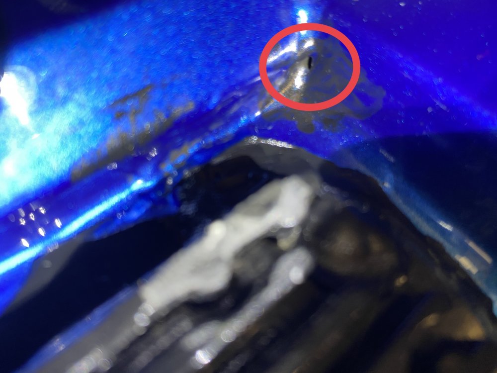

Eventually I found a tiny hole in the body of the car, right in the corner where all water would almost funnel to and then enter the roof skin, travel along the skin until it found an out point which was where some plastic wire holders where clicked into the body frame in that rear quarter panel. Hence why no wet roof cloth.
Sealed the pin hole. Poured water for 20 min - not a drop in anymore. 😎C01B24DB-ECC0-43EA-BAB3-F2E3F38467F0.thumb.jpeg.25be0d8a5cb26c4da4eb9dccf2b8162b.jpeg
