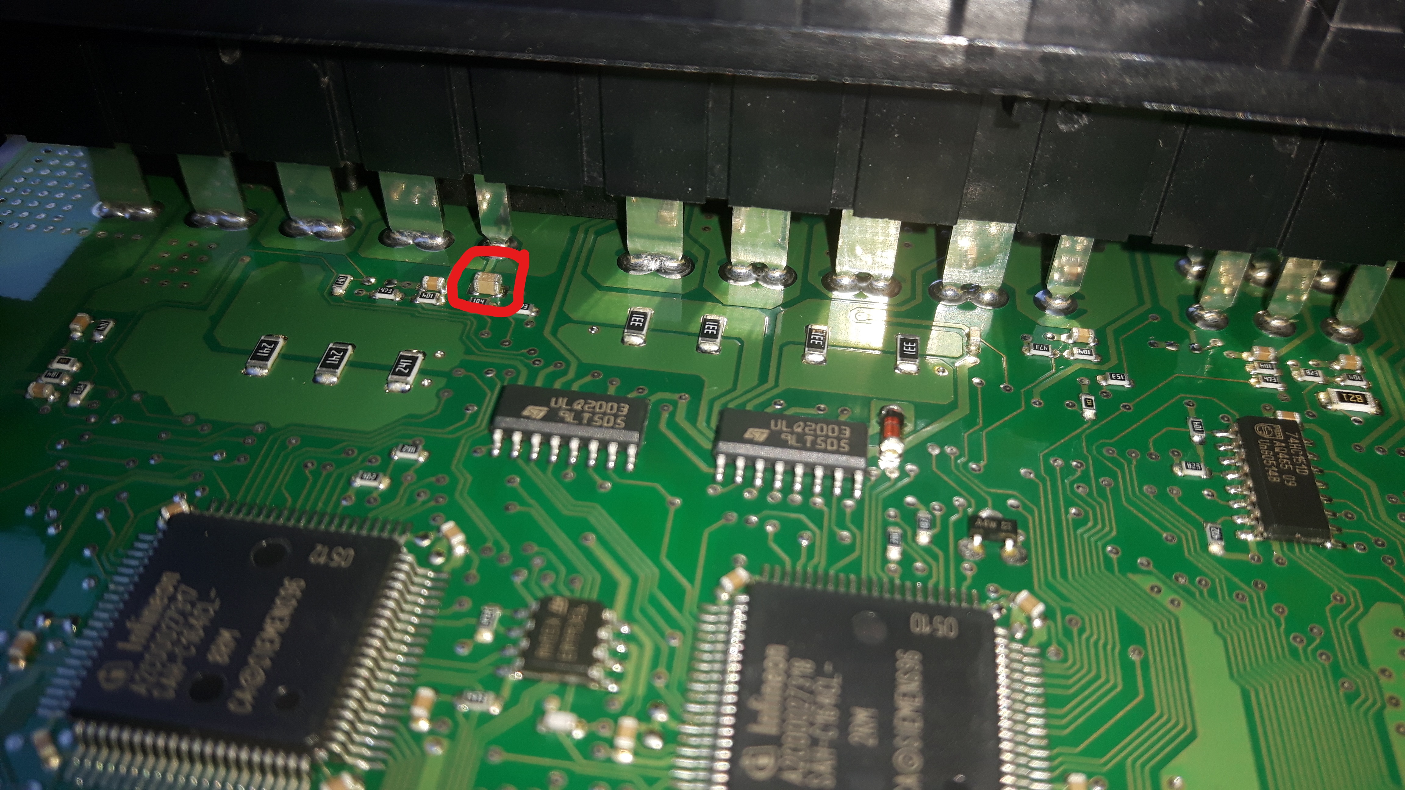

If you do decide that module replacement is the way to go, make sure it has exactly the same part number, as read off yours; and there's one other thing that it would be nice to check, preferably before paying anything to anyone for a secondhand one.
There's a fault that sometimes occurs with a surface-mount capacitor on these modules. It may or may not be related to the relay contact failure, difficult to judge cause and effect I think.  Its role seems to be to filter a feedback signal that tells the relevant microcontroller what state the relay is in.
In extreme cases the capacitor nukes itself and causes a parasitic battery drain problem, either directly or indirectly.
It's here on the board, and the board is pretty straightforward to 'unhouse' from the plastic case:

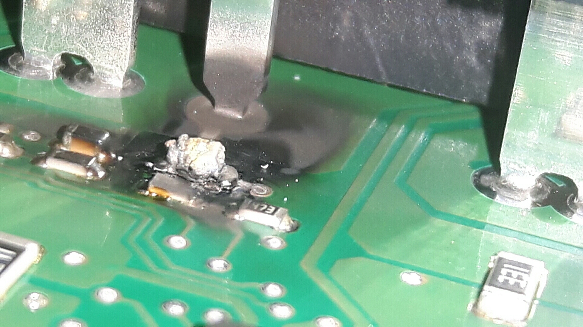

This is a 'well cooked' example:
