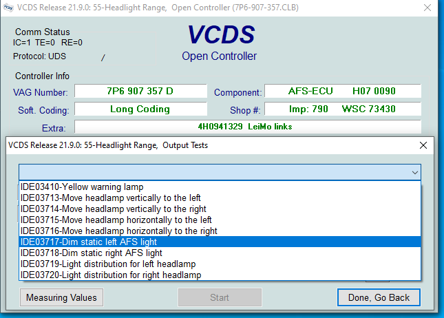

  5. You can use VCDS, module 55, Output tests and the Dim AFS left & right with setting On value.... this had dimmed the fog AFS lights but I noticed It stayed so! I didn't know why, because I didn't change any adaptation or coding. So I tried the test once again with Off value (Dim off = lights on) and it worked, no I have cornering again. I have Dynamic Light Assist and have no option to turn cornering in menu.
