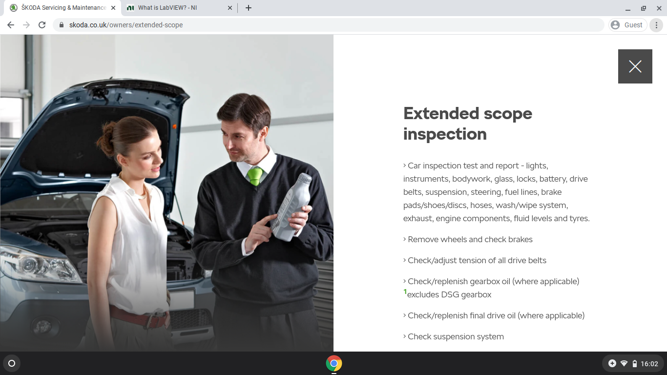

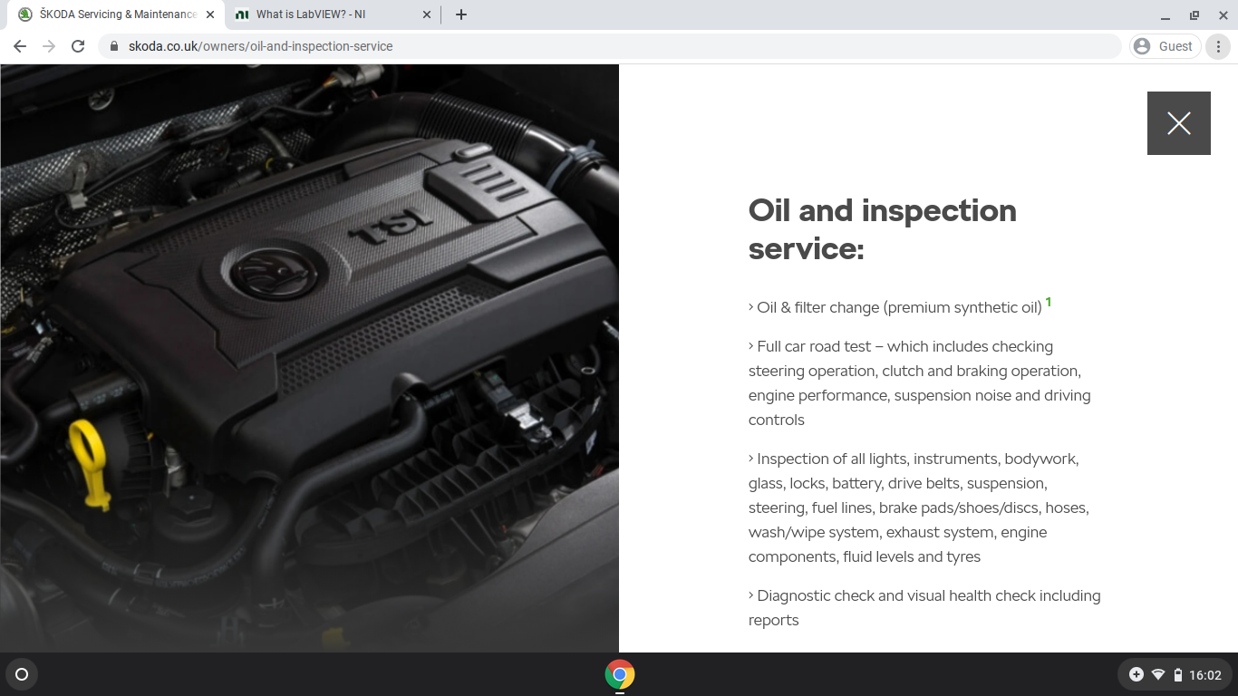

Maybe at Skoda Main Dealers they will be advising 80% wear on brakes and need for new discs and pads.
Did you pay for the brakes to be serviced, if not then maybe they need doing.
Thanks for the idea, but the car has only done 15000 miles and the dealer said the brakes were 20% worn. As this problem is only 500 miles old, the brakes could be binding and not yet worn.

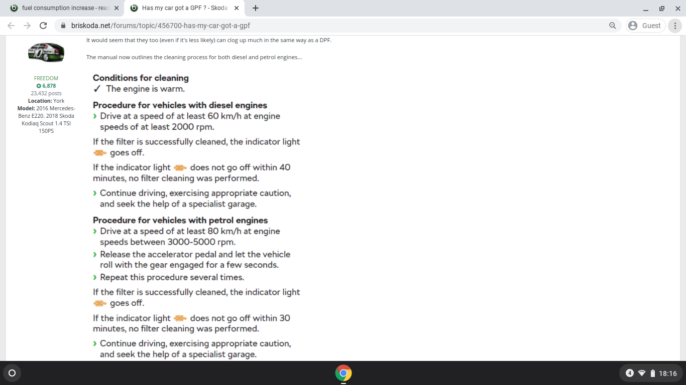

Just a wild crazy idea.  But maybe it is the GPF and it wants to get it's self clean.
That is if your mileage and use has been lower with shorter trips.
I do mean GPF and not DPF.
It's an idea and I will try running it at high revs to see if it makes any difference, although they are not supposed to need cleaning the way that DPFs do. Thanks for the suggestion.
Look in the Air Box and see that the Air Filter is clean.
That was likely not done at the service.
GPF's  are not supposed to need any actions by the driver, and what is actually the facts needs checking really.
http://briskoda.net/forums/topic/476488-octavia-vrs-245-gpfopf
http://briskoda.net/forums/topic/466684-20-tsi-190-gpf-regeneration
http://briskoda.net/forums/topic/479195-car-bahaving-strangely
Read VW's advice on gpf's.
http://briskoda.net/forums/topic/456700-has-my-car-got-a-gpf
