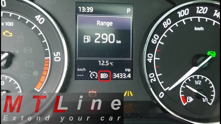

When u turn on ur high beam, do U get a letter A inside a circle logo?
Do u have SLA headlights?
Yes, I get the icon. And yes, I understand the lights have smart functions. I can also switch to left hand drive settings for driving in France.
I got flashed a couple if times on a short winter commute  then realised that I had accidentally switched to constant main beam rather than leaving it on auto. Otherwise I find them very effective as they shape the main beam away from oncoming traffic rather than just dipping automatically. I presume your windscreen light sensors aren't blocked
Thanks. Where are the sensors please?
Clustered around your mirror, ensure your windscreen is clean. Otherwise I am not sure why it wouldn't work properly.
I've never been flashed with my high beams on my SLA headlights.
They react and mask very well.
As @Redboymentioned, make sure U haven't gone past the auto high beam function, to manual high beam.  U'll know this is the case if u see the blue high beam icon on ur dash.
