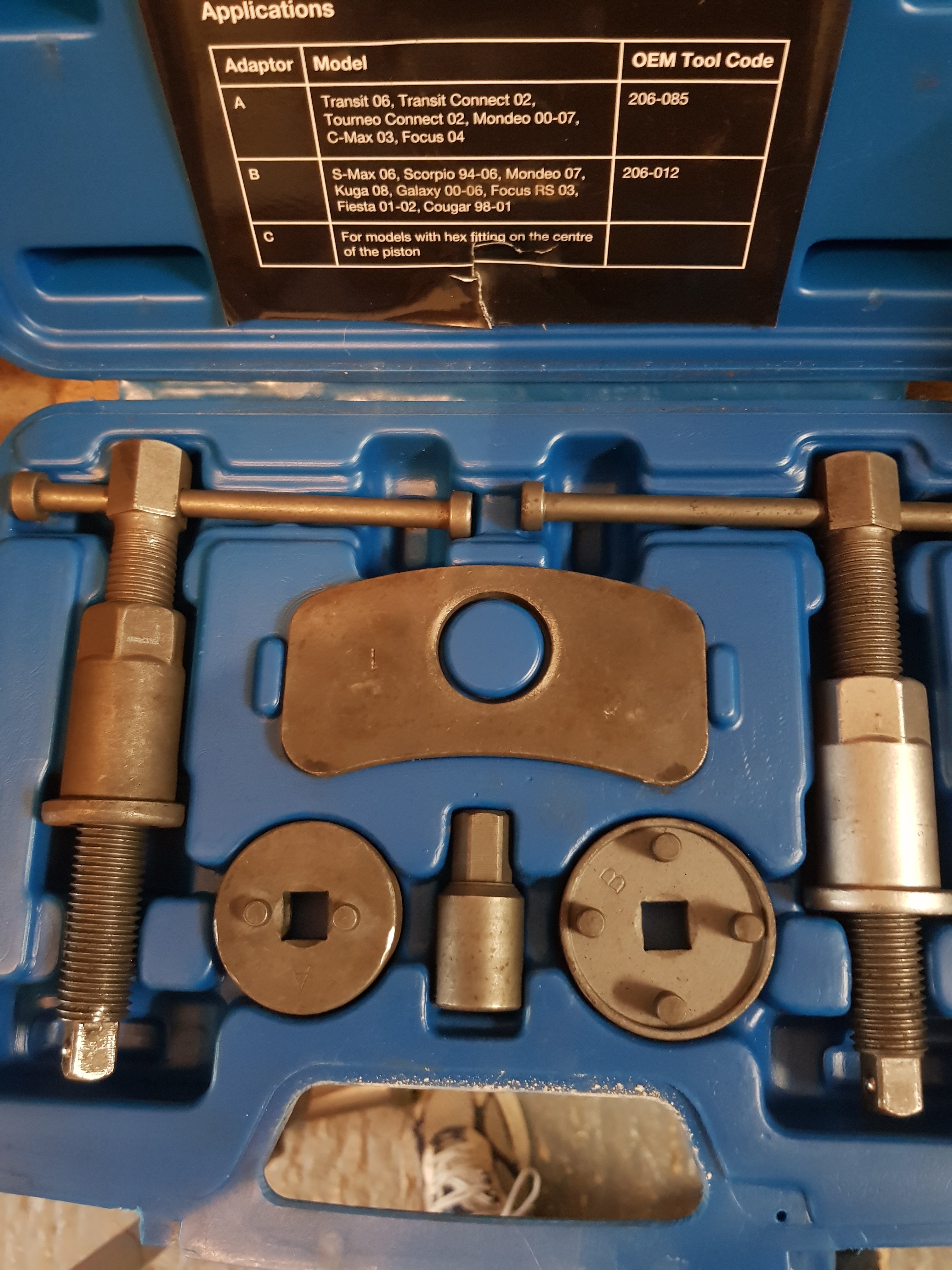

Cheers TheClient, I was just being a skinflint as i got a £10 Halfords voucher by email.have a Laser windback that fits Fords but the adaptors dont match my Octy pistons. Both are 3/8" drive so might use a cube with the driver handles off this!

Looked at mine. I just have the one adaptor with two choices of face. One has two pins inward, the other they are towards the outside.  Works for my bosch rear calipers but contrary to what I said earlier the trw piston is probably, almost certainly different.

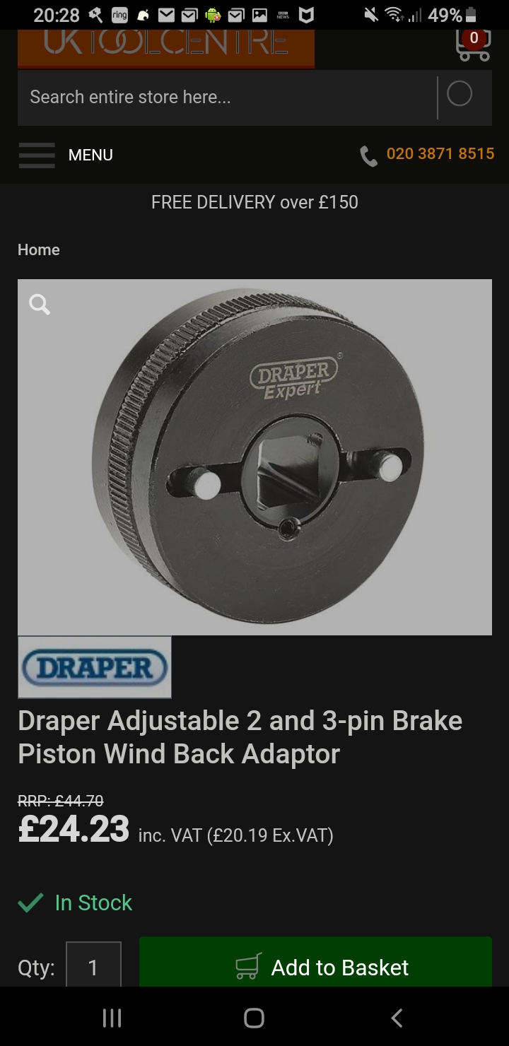

Can't remember if it is Draper or Sealed, but you can get an adapter plate for your tool that has a pair of pins that are automatically adjustable. Thay widen or get narrower as you turn it. Quite fine but strong pins fit all sorts.
Cheers Me-109, Found one of those,that looks like a neat idea
Aye, that's the thing. My brother has one that I've used a few times. The pins look worryingly thin, but they are very strong. I've a rewind kit with about 20 adaptors yet sometimes none of them fit.
