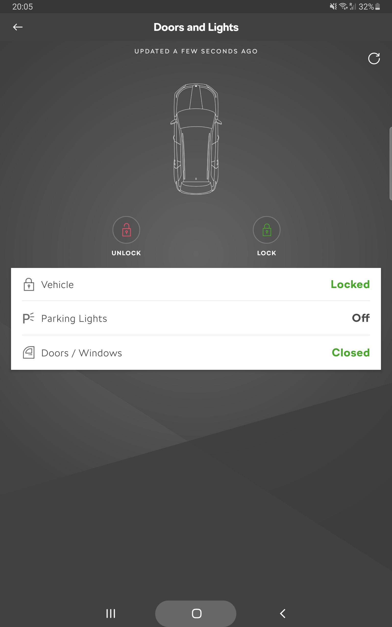

What status does the app say - locked or unlocked? Can you lock/unlock via the app?

I mean the MySkoda app, not an OBD2 dongle/app. You can check the status of the car (doors, windows, lights) and lock/unlock the car remotely, even sound the horn and flash the lights. Depending on what you can/cannot do via the app, it might help to narrow down the issue.
