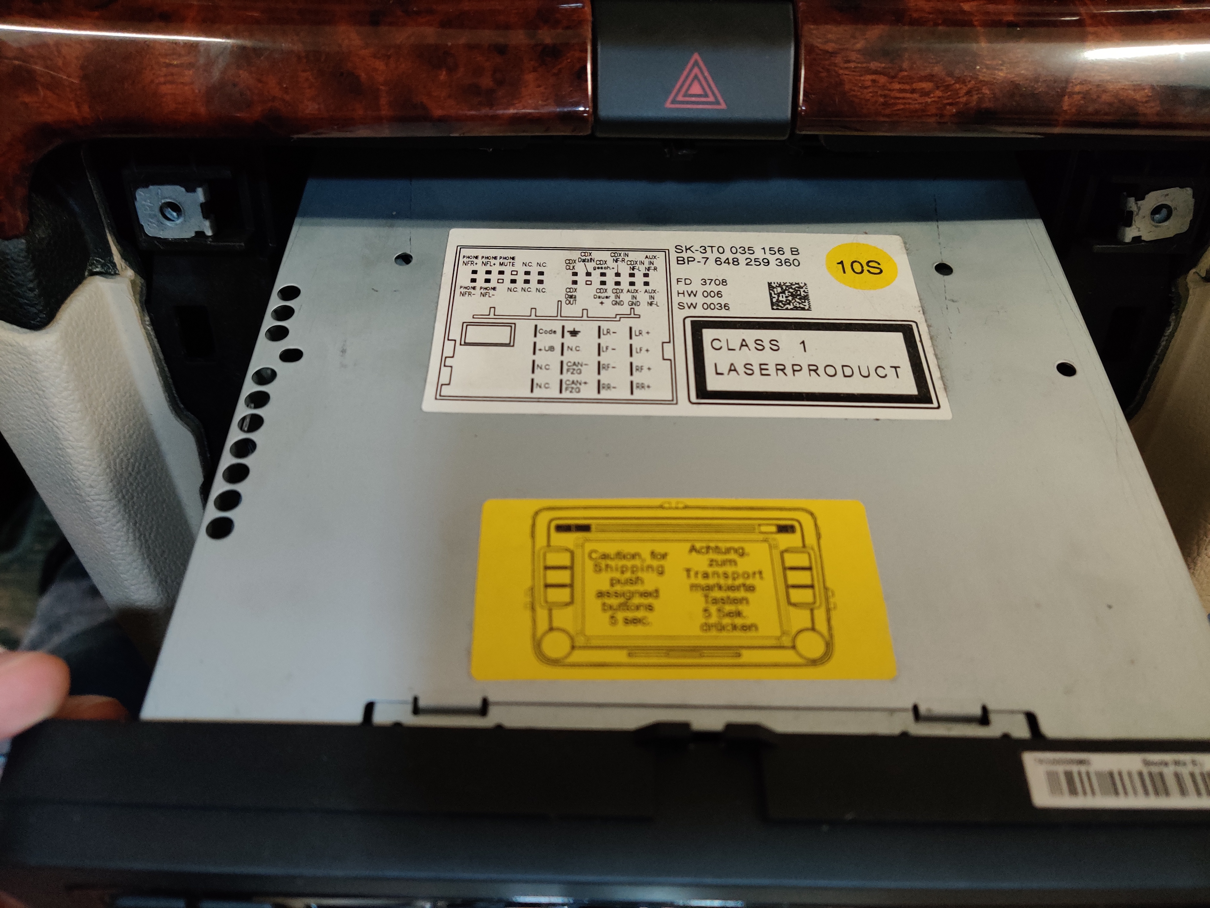

I have a Bolero unit on my '09 Superb Elegance. Where can I download a firmware update for my head unit? There seems to be a lot of information about updating Columbus unit but no so much about Bolero. I believe my unit has the original firmware version. Holding the setup button will not show the firmware version.

The reason I'm asking is I upgraded the bluetooth unit and would like to be able to control music with steering wheel buttons or head unit. Currently the head unit is not showing the track that is played via bluetooth. Could this be resolved with VCDS or is it just something that would require replacing the whole unit?

I'm quite certain it's the original firmware from 2009..

Like it says in the original post, this doesn't work on my unit. I've read somewhere that the old firmwares don't support this function.
