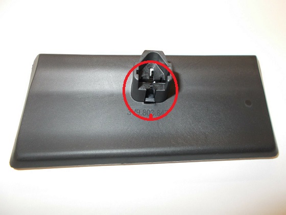

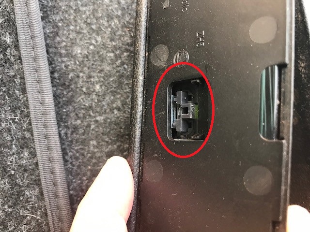

it the part for the factory fitted tow-bar.  The small clip inside (circled) which you can see if you remove the chrome cover has broken and the bowden cable that releases the tow-bar keeps slipping out.  Is it a whole new handle and does that include this clip (?) or can you get this clip on its own?
TIA

Just had a look and that part does not appear to be removable.
Is your part number 3v9 803 847? Might say 9b9 somewhere too.
Thats listed as satin black though so not sure if the chrome part is removable or just listed wrong.
£30.17 for a new one anyway, if you’ve got a different part number post it and i’ll have a look
Yes, that's the one.  The part number has really helped (Thanks) as I can see on that number it does include the little clip on the underside to attached the cable.  ebay.de is showing that as a chrome piece, so will take my chance and order locally.  Thanks
