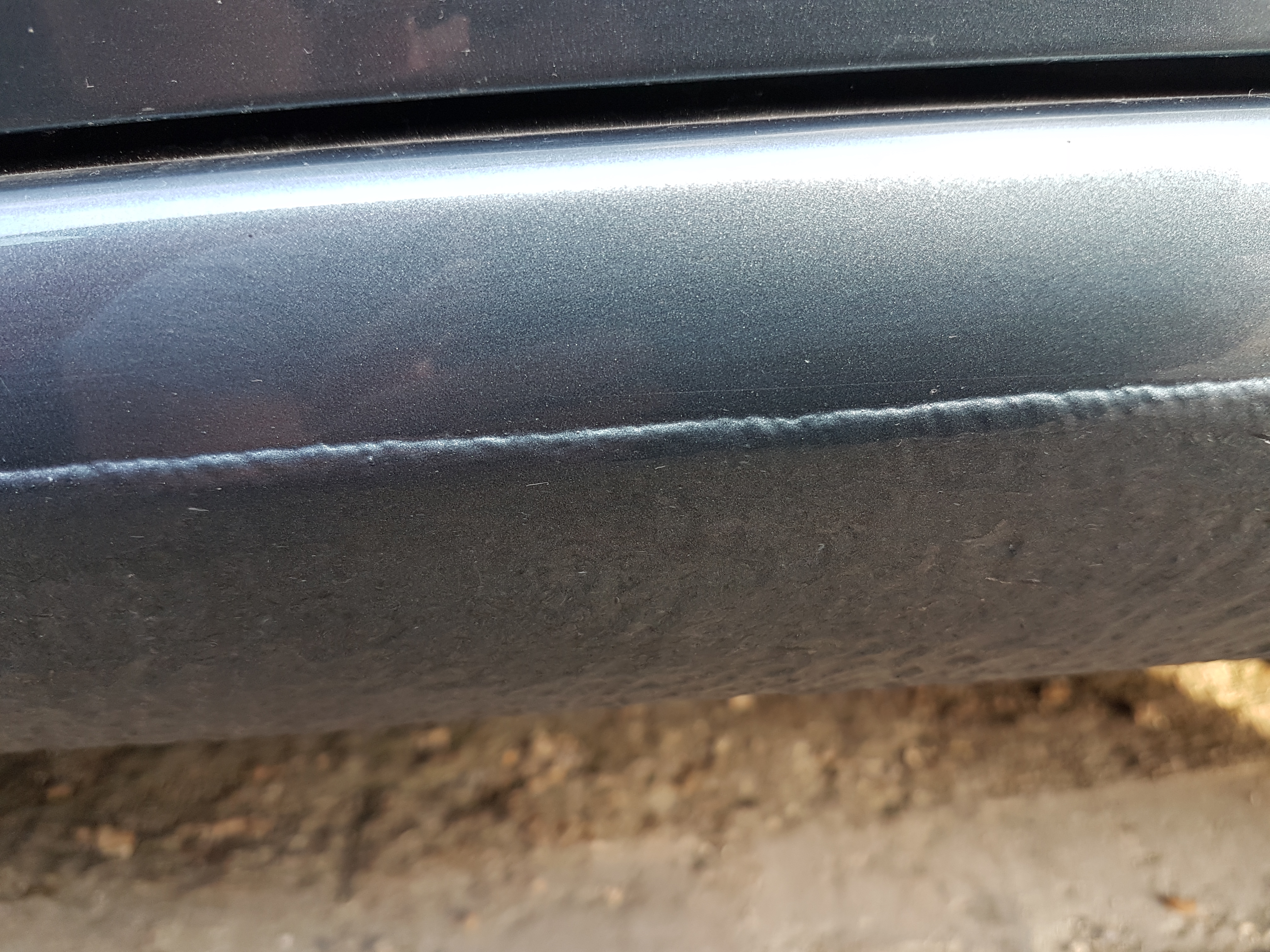

I am looking at a 2017 VRS diesel in a local dealership and was concerned by the amount of underseal for want of a better word on the sills of the car.
This stuff looks to be around 4mm thick ?? Is this correct?

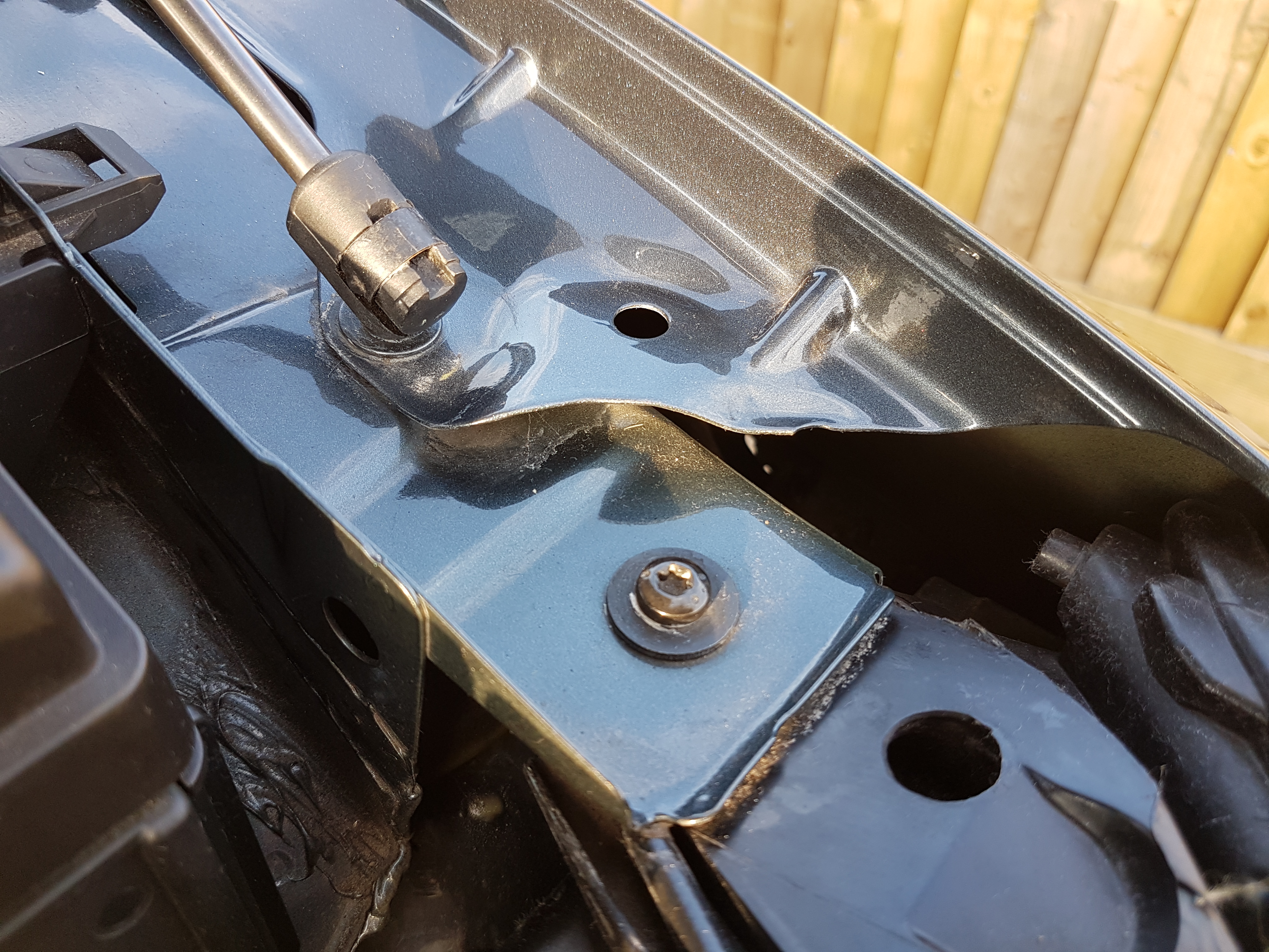

Also at the very front of the wings under the bonnet they seem to have run out of body coloured paint and there is primer showing ??

Sounds very suspect to me. Maybe the car has been poorly fixed after a crash. The underseal you speak of comes 2 thirds up the sills, but is thin, although in the photo it does appear thicker and is colour coded in as per photo. It's more of a rough hard surface protection than underseal.  I took a photo of the front corner of the wing underneath the bonnet and as you can see, all nicely painted the cars colour.

The sills do appear to be the same but the wing definitely isn't.
Also primer is on view on the inner wing just in front of your strut mount, just as it rolls over towards the outer wing.
Think I'll be walking away from this one.

The photos posted by @roaddetective look like what I would expect. The underseal on the sills is noticeable, and has an edge line, but not ridiculously thick. Guess I'd have to see some photos of the vehicle you are looking at.  Even then, it may be hard to detect what your are talking about without being there in person.
