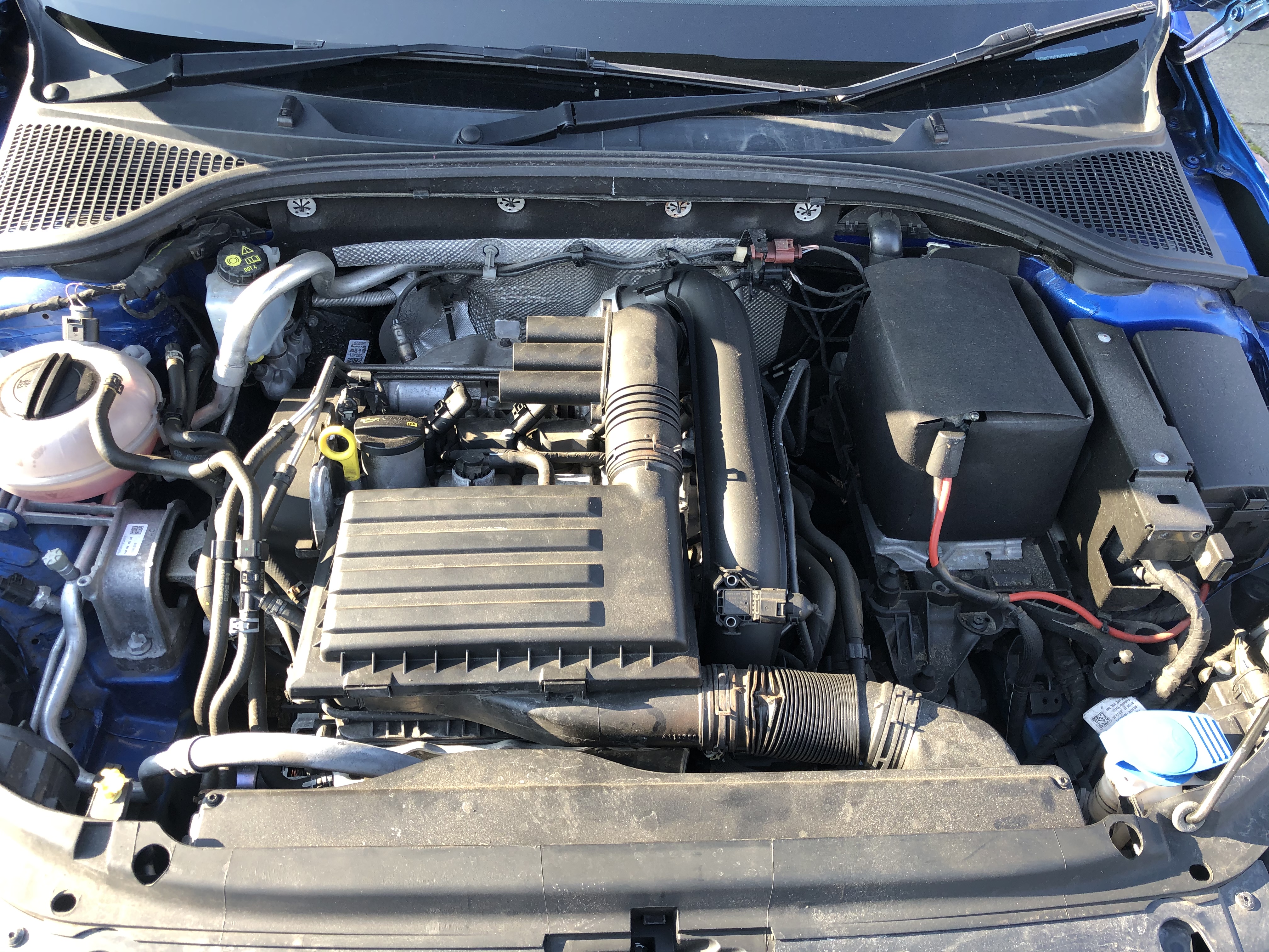

I’m not sure :blush: I will attach pic of my engine bay and see if anyone knows

Judging by that picture, no.
Yeah that's a no. Take the filter out and measure it. You may also be able to make your own setup. Probably the way I'd go. Make it up with off the shelf parts. If you can do it from the same manufacturer they may give you a discount for trying a kit out?

It depends what you want.  I would predict that the 1.4 doesn't breath enough to make a huge difference with a full inlet kit let alone a drop in filter.  If you are looking at doing it on the cheap you should probably take a look at what you have and see if there are any restrictions.
For example the 2.0 inlet has:
half of the start of the inlet blocked off,
half the back side of the inlet opening is open to the engine bay
a snow guard in the air box
Fix these things and you should notice an improvement at least in noise.  The 1.4 may have similar restrictions.  Those sausage shape things are apparently there to damp the noise so remove/blank those may a starting point.  Just don't mess with any sensors.
