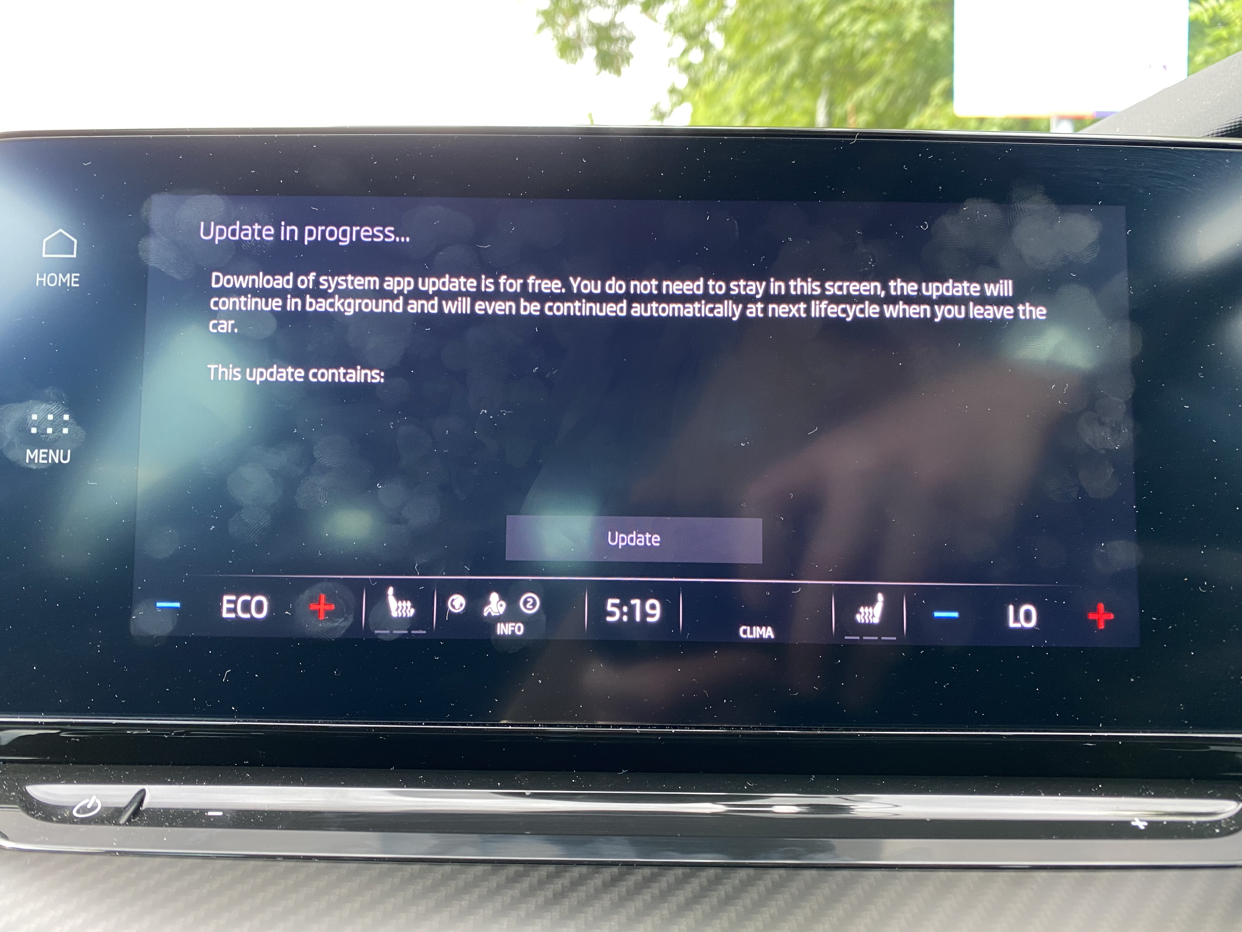

It's all gone quiet on here ,has the silver bullet arrived from VW whilst I was snoozing ?
I have 1803 SW and just seen an update over the air. It did not say what it was , it did however have a space to tell you what the update was but no one at Skoda bothered to list the changes. Ill do their beta testing again.
So far tho 1803 is near prob free apart from sat nav forgetting and climate 22 degrees forgetting

I’ll let you know, the photo has just happened on mine!!!

Nothing major is included in this update. Already updated mine this morning.
No, infact it’s even more laggy on screens that previously had no issues. Such as the charge and drive modes screen.
