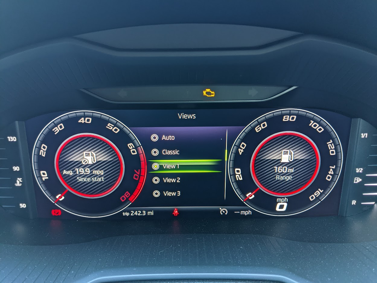

So everything can be done still without the view button, just different methods
Not quite.
You can't access this menu to change what's shown in the two middle circles:
You can do this via the headunit, it's just much less convenient as it's quite a few button presses via the headunit rather than holding the view button.

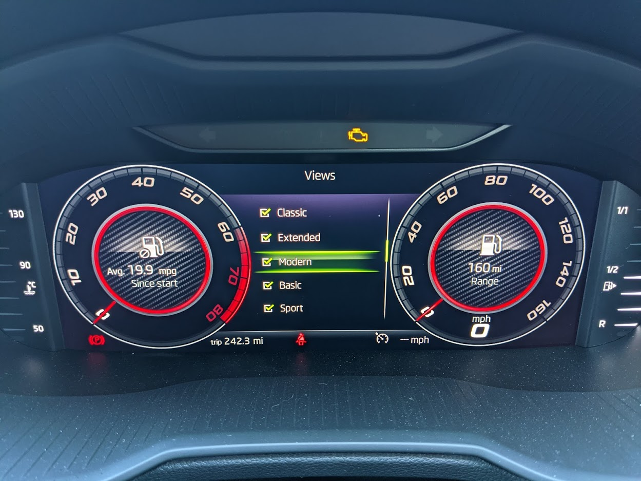

This menu won't be shown either which enables/disables display modes:
AFAIK, there is no other way of changing this, you need to have the correct buttons.

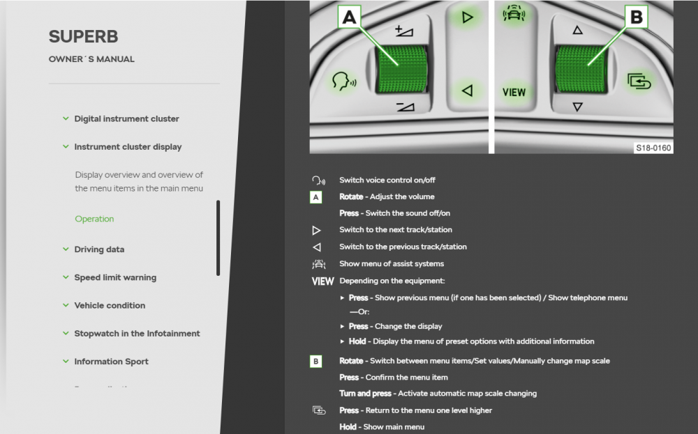

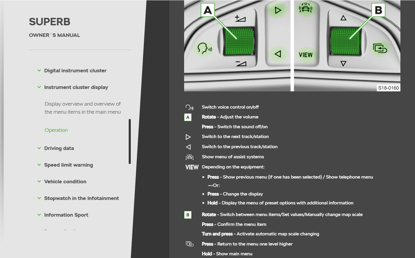

My 2019 car has the view button but no VC. It does control the phone. If you have VC fitted does the view button stop controlling the phone as well?
From a 2019 Superb owners manual:
So no, there is no phone control when fitted with a VC as far as I know :)

I must be missing something here...  The View button does exactly that by long pressing it: Switch between the 5 available dial arrangements of which 3 are actually Custom ones set by the user and labelled View 1, 2, 3. as shown in the 1st picture by langers2k a few posts above.
