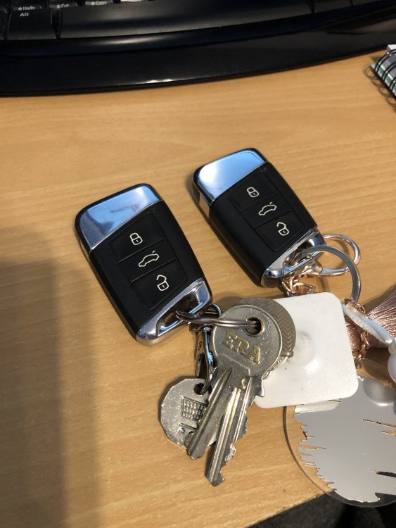

I did this mod recently to get a 2nd key fob as the main one.
I've bought one from aliexpress for few quids and all is fine! ;)
Left = Before / Right = After:
I just took the logo from one of the 2 original plastic key fobs. The one from Ali was for a VW model indeed...

Hi,
I only bought the key fob housing. There was no electronic board in it. I had to retrieve the electronic part, battery and 'key blade' (sorry I don't find how to translate properly, hope you can catch what I mean) from my original plactic key fob.
You got it for the logo. You need to warm it gently to ease the removal. But you rather have to retrieve it once the original shell is empty to avoid potential damage on the electronic board components due to overheat exposure. ;)

Thanks @Bap33, I've just ordered a shell, when it arrives I'll likely use this as the main, and then transfer the original to my wife's key.
I'm still after a way to remove the PCB from the plastic body. Haven't tried hard really, just opened it quickly the other day and thought of letting it aside until I have a solid approach so if anyone can share some tips at some point i'd be great.
@Bap33  so you bought the full shell (plastic body + metal bits) but only replaced the bits, did I get that right?
Yes, that's it. Just used the 'ali' one as a "donor". Grabbed the upper and lower metallic parts to install them on the OEM key fob.
Mine arrived today, but the top part of the original key I cannot figure out how to remove, it appears bonded to the core part of the key, either that or how do you retrieve the electronic part of the key?
Never mind, whilst it is bonded, a bit of prising with a flat head screwdriver soon released it. Just need to heat up the small Skoda badge to transfer it.

On the original plastic cover you're removing, I found if you heat it gently with a hair dryer, and gently prize it comes apart without stressing the plastic. I'd even suggest using a plastic prize tool instead of a metal driver to further reduce the risk. I guess it all depends on how precious you are of the original plastic elements that you're replacing.
The integral part of the key doesn't risk damage, just the plastic hood that you're replacing.

I used a small torx screwdriver to undo the screw at the bottom, in terms of the top, I was 'upgrading' a secondary key (my wifes) from plastic to metal. So was swapping the plastic parts from the genuine key, and adding the metal parts from the donor key. I'd imagine prizing off the top part of the key would be a lot easier when its metal, as you don't risk stressing the plastic.
