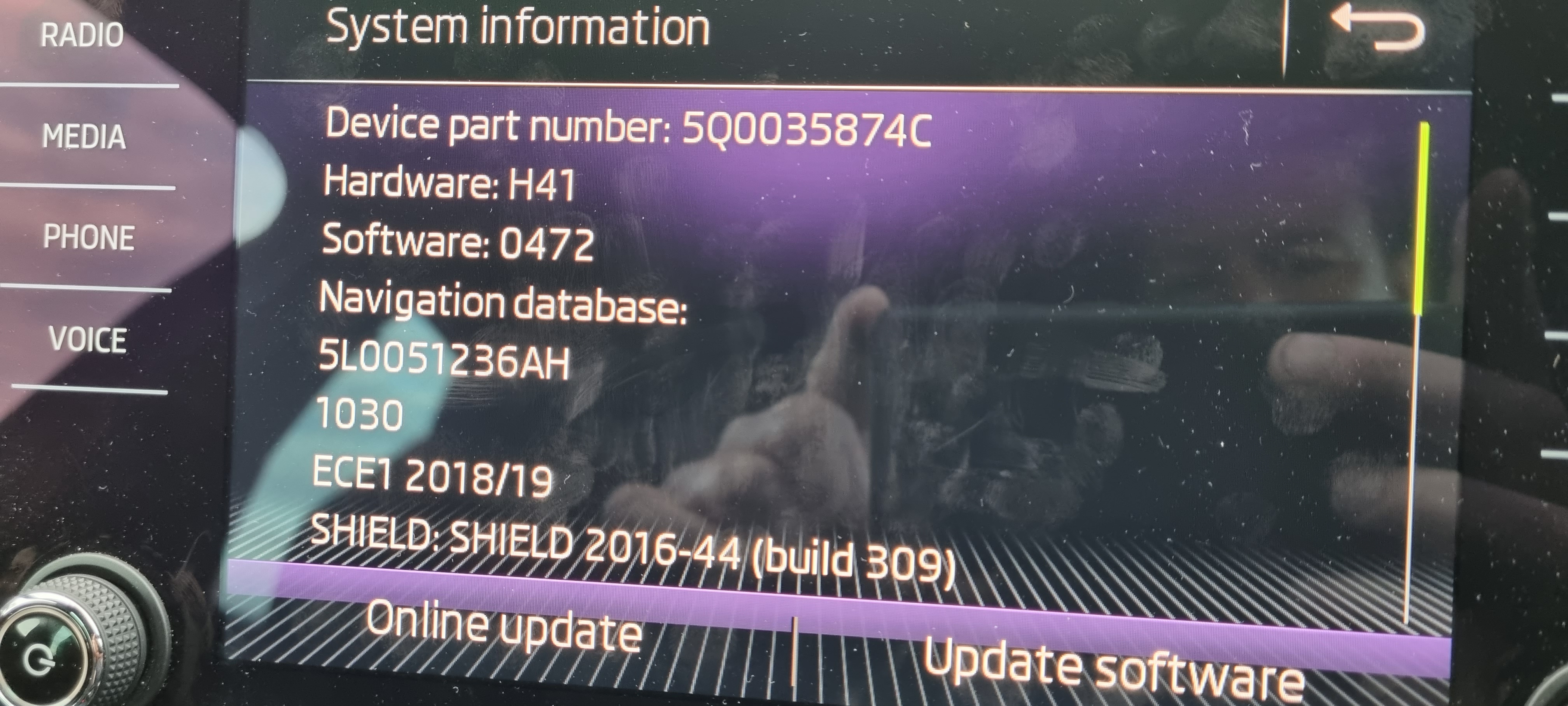

@varaderoguy Hi, do you have a software update for this please.
Regards Paul
I can get the nav updates on the portal, but not the unit.

Yes there should be an update to 0478. @pab567will confirm.
Btw - your maps are also showing out of date. Go to the Entertainment section on Briskoda and download the latest 2021 maps from VW onto your Amundsen SD Maps card
Download link sent via PM

Thanks very much will try it later today.
Again thanks to @varaderoguyfor the help and the walkthrough was perfect.
And @pab567 for the software update. Much appreciated guys.👏👏
Just one more question since the update I've lost the pictures for the radio stations as my ideas?
1) try tuning in and resaving the stations. Icons should reappear.
2) Go to https://updateportal.skoda-auto.com/
And update your icons from there (download them and follow instructions)

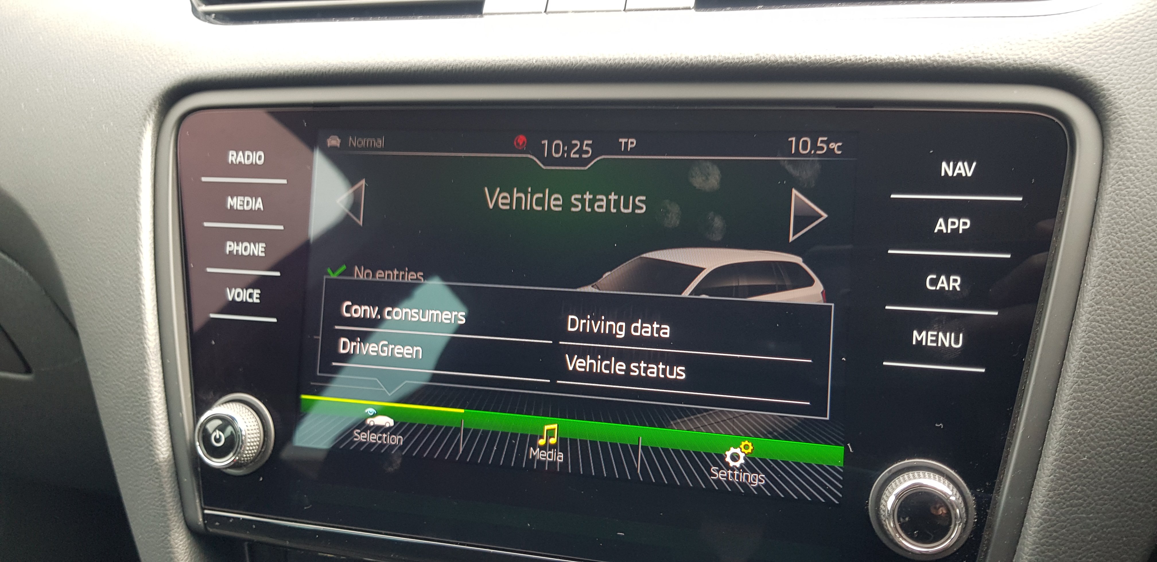

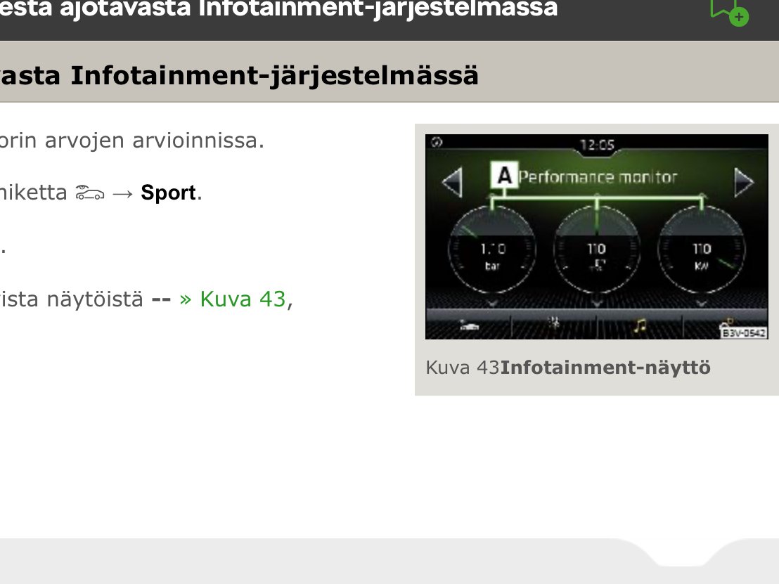

Okay, quick update. Here's a photo of my infotainment unit and the software version, as well as a shot of the 'selection' menu, which lacks a 'sport' option.
I've managed to get the route directions up on the Maxidot display, that was my fault for not having a route set! However, there isn't a lap time option.
