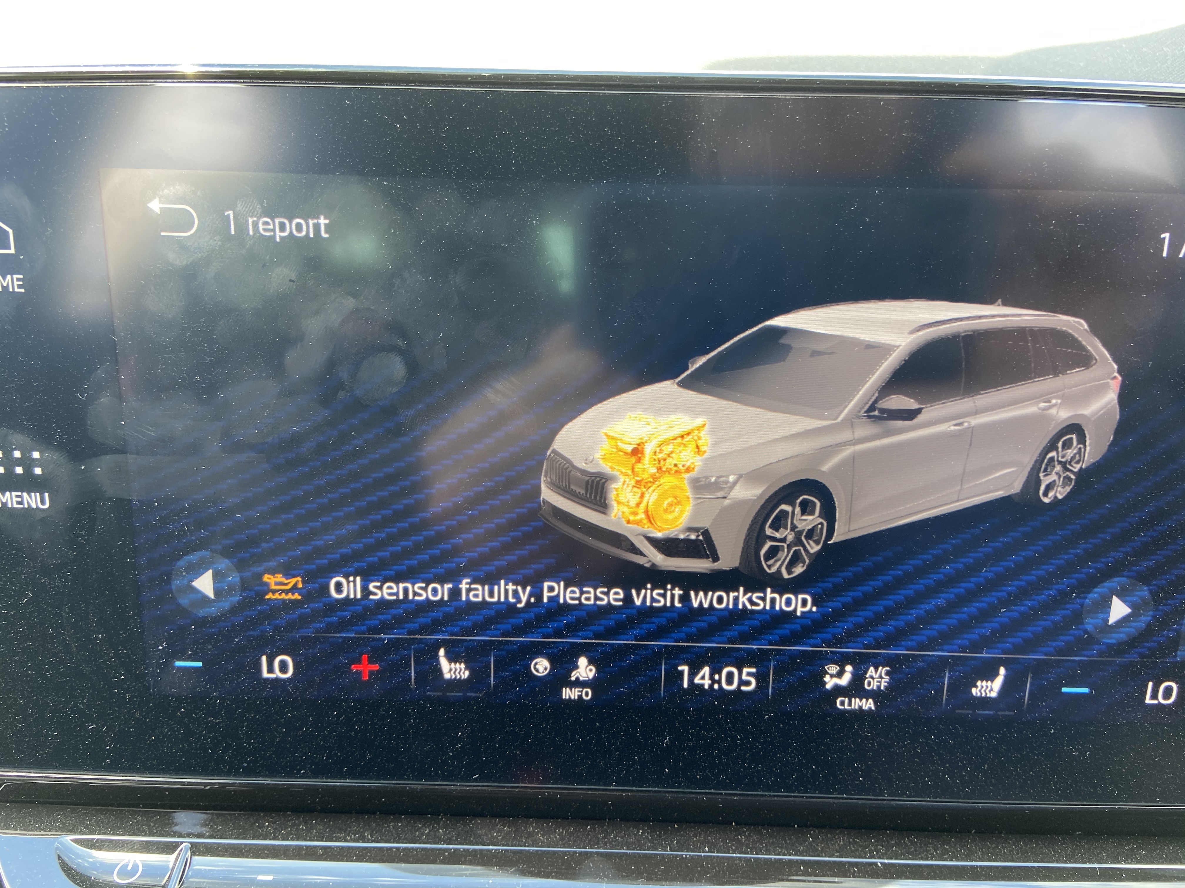

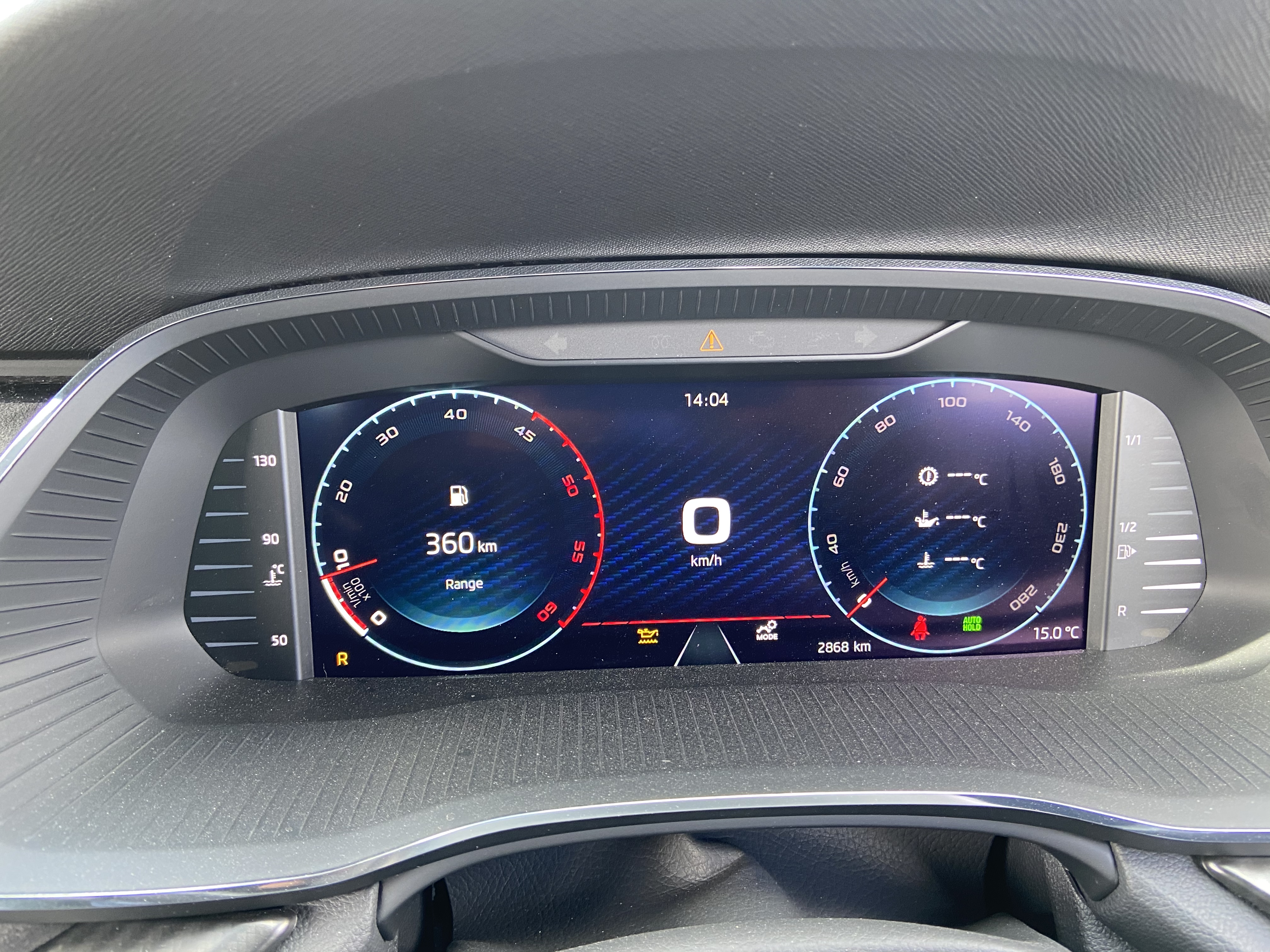

At 2 months/4k miles it's going in for a couple of early issues though and was wondering if anyone else has had/fixed these :-
1. Yellow warning light come on for oil sensor faulty - running fine and oil and water temperatures are normal.

I have had number 1, but my car was an absolute mess by the time I rejected it and it was but one of many error messages and faults happening over a two day period.
I doubt it even was a sensor failure and more likely just the car's frazzled brain not having a clue what was going on.

Oil sensor faulty light - had gone off and they couldn't find anything. Could someone check for me if you get a 'oil symbol warning check light' come on when you put the ignition on please ? I've noticed mine doesn't show that symbol when you put the ignition on, but not sure if it used to or not.
Mine does that, it’s not a VRS though. I had the same on a previous Arona and Fabia so I think the VAG seat adjusters are just really weak, and slowly undo under the drivers weight
Just had the oil sensor warning. 16 June they are going to look at it!!!!

I had 5 oil sensors replaced on my last RS (Mk3), I don't know what the hell was wrong with the damned thing, also the infotainment system & cockpit went blank, and a whole host of very irritating & irrational faults kept popping up on a regular basis.
In the end the "jury rigged" the wiring harnesses to stop the faults, but I was quite glad to get rid of it in the end. This one has had some odd faults, like parking distance and others which have come & gone with software updates. But I think this one will be dispatched early next year for something that doesn't have as much tech on it.
