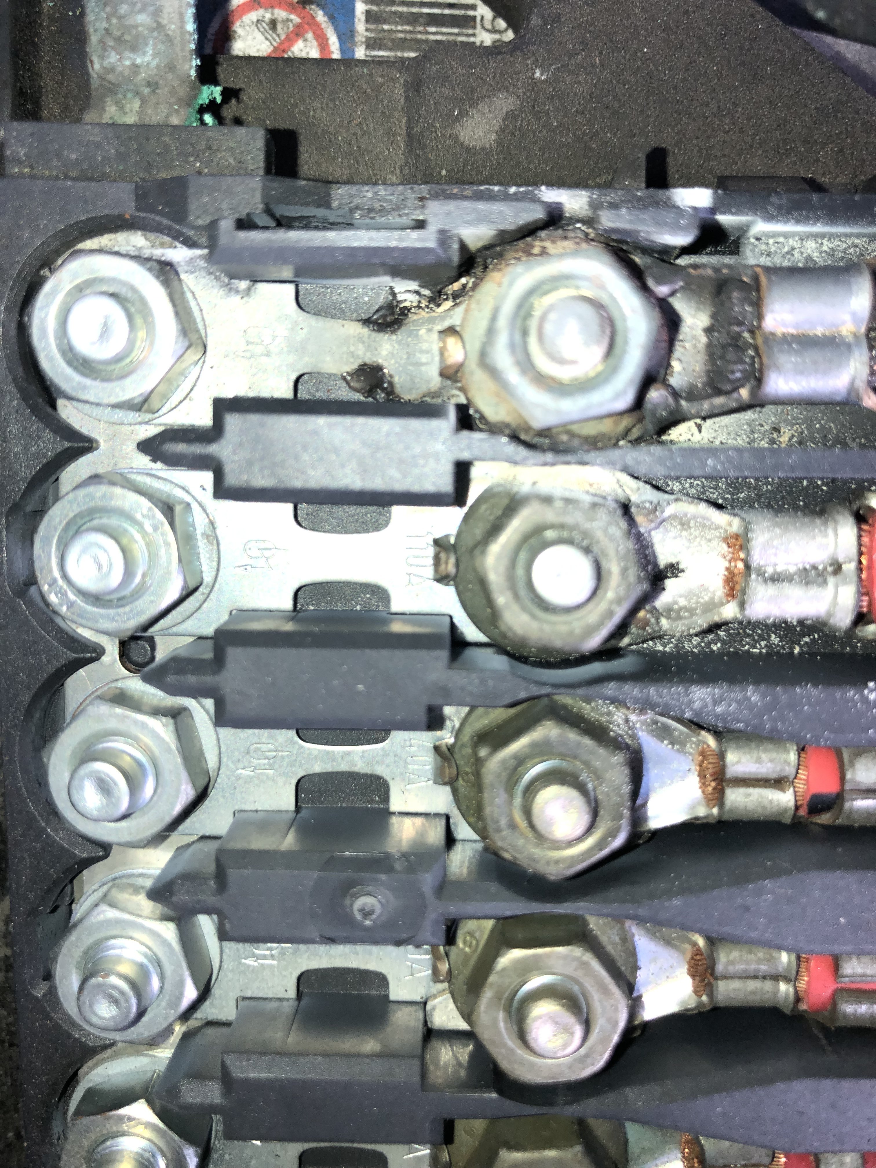

I switched out both fans to new ones, changed the three fuses on top of the battery, changed thermocontact on the radiator.
They wont run at all now, might be the relay being dead? Next is cable broken due to all the fiddling around in the engine compartment. Ideas?

in both cases my right fan didn’t rotate, but if I moved it by hand it wanted to go, so the connection was there. I also found the main black alternator ground on the battery top almost melted through.

Be careful with that 'main black alternator ground' because I'm pretty sure that's the 12V connection; got a photo?
Yes I’ve ordered a new fuse box. Not driving much at the mo so time to fix these niggles.
  • Sponsor
Yep that's the positive connection. May need a new crimp on the end of that wire, that's probably what caused the overheat.
Yes I will treat with care.
Trying to think how long it's been like this. Perhaps a couple of years back, lengthy traffic jam in sweltering weather resulted in engine becoming very odd, multiple warning lights and no power, limped to destination. This odd behaviour has never repeated, but may have been when the fan end-of-lifed and caused that current increase...
