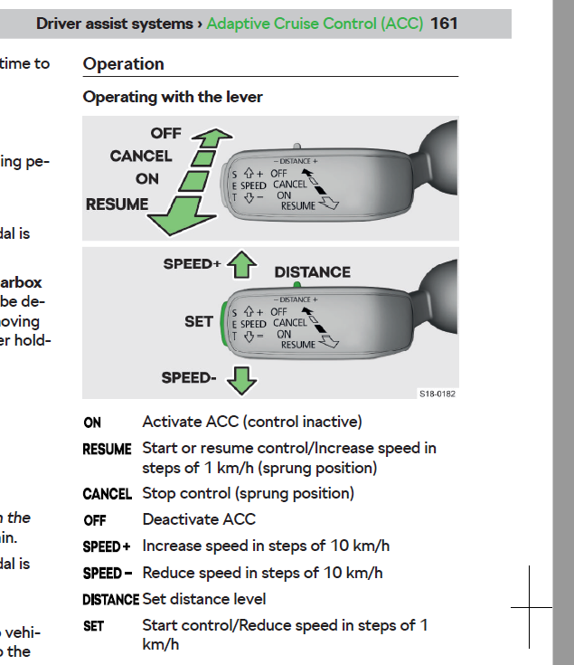

after reading this topic, damn, seems that reading car manual and common sense is not popular in 2021.
