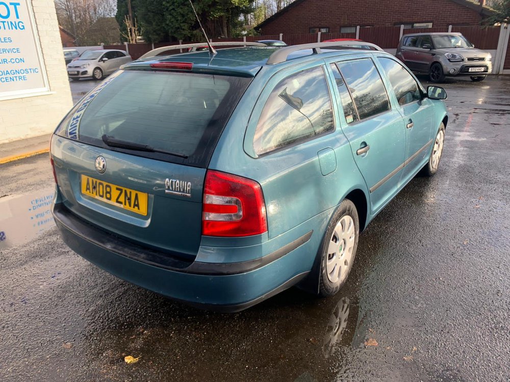

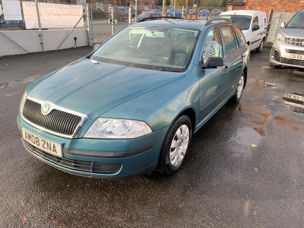

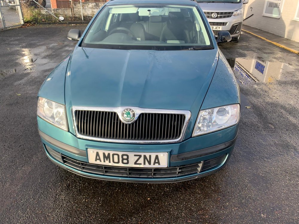

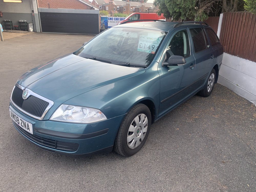

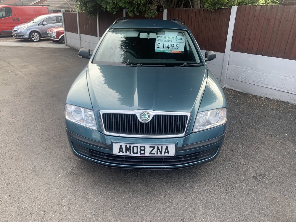

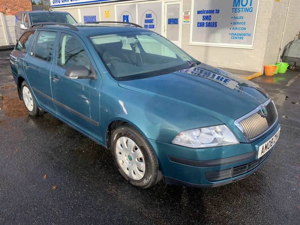

General comments: car looks clean and key items seem to have been covered (full service history, 4 new tyres, waterpump, cambelt, brake pads and discs all round, new shocks and springs all round); have a good lookast the service history to see if it was regular, at what intervals and by whom.  This may also tell you if the car was a taxi, in which case look for higher wear.  The other big maintenance item is the dual mass flywheel.  If that's been done, you will save around £500 in garage charges.  Listen to the engine ticking over and check for noises like metal scraping on metal (try a youtube search for examples) which would suggest an imminent failure of the DMF. Cosmetically, is that a scrape or a reflection on the driver's door?  Also, the left hand door mirror is missing a cover.  No piccies of the back end?  You should check for rust on the tailgate around the number plate lights.  As long as it hasn't penetrated the metal it can be touched up (and it's not normally visible) but it is a known weakness.

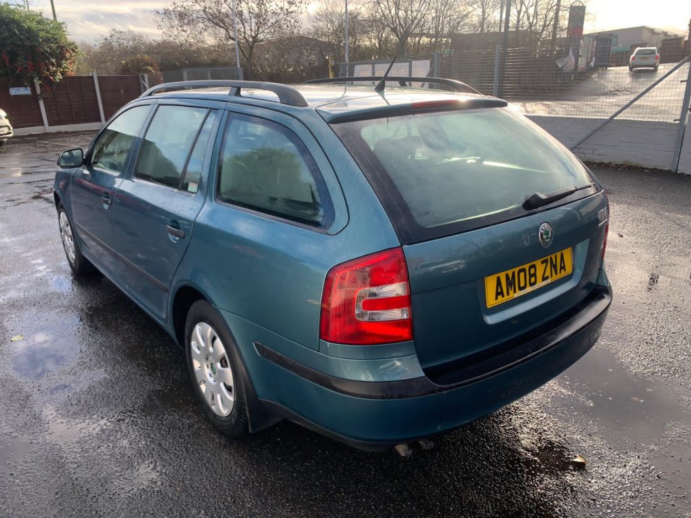

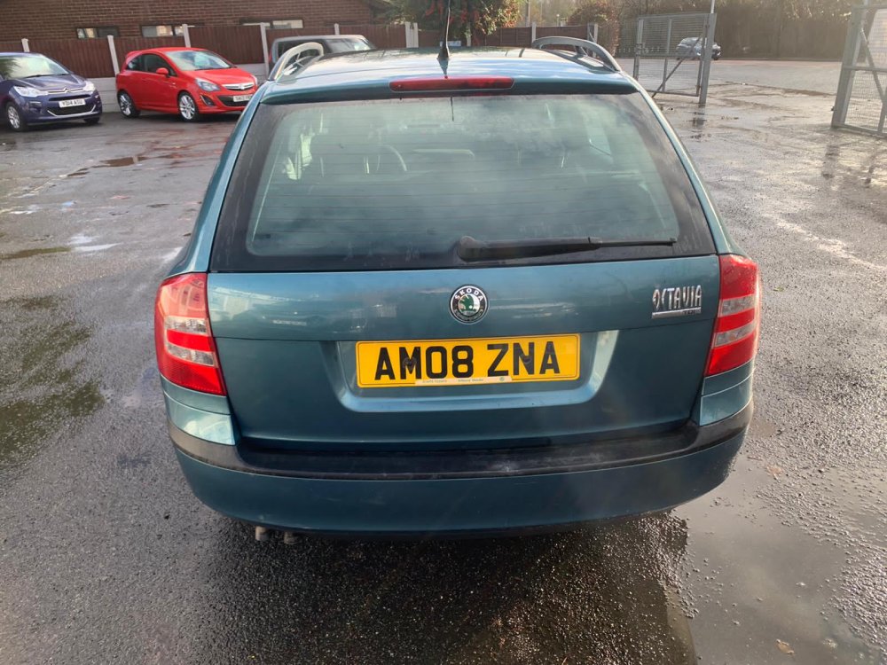

The door on the drivers side looks like a reflection. I’ve some images of the rear.

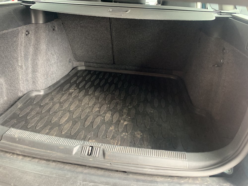

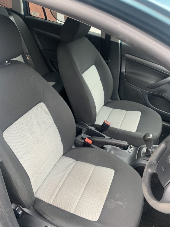

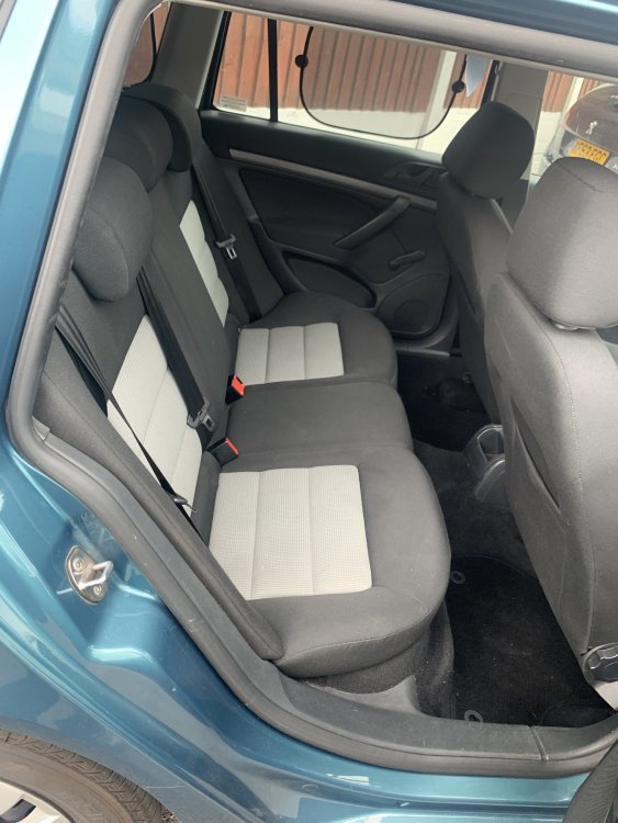

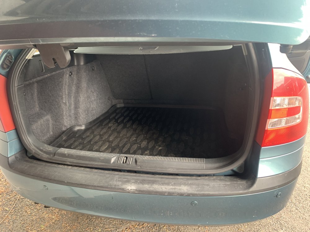

Looks clean all round.  Cloth seats, some compression wear on the driver's seat squab plus (I hope!) some coffee dribble marks.  Manual rear windows, can't see for the fronts.  Boot space clean and cover present.  BXE motor is pretty solid as long as it gets regular oil changes with the proper VW grade oil - check the service records.  Wrong or insufficient oil leads to camshaft wear - noisy valves and/or irregular engine note can indicate this.

Just taken a quick look in the brochure for this period. The colour is Island Green. The non-body coloured door mirrors and door handles are features of the Classic model. Equipment highlights are that the front windows should be electric, the door mirrors should be powered and heated, standard fit ICE was the Stream with single CD, MP3-capable and 4 speakers, central locking (not remote), and height adjustable driver's seat. For a 13 year old car, the body looks remarkably tidy in those pics.
