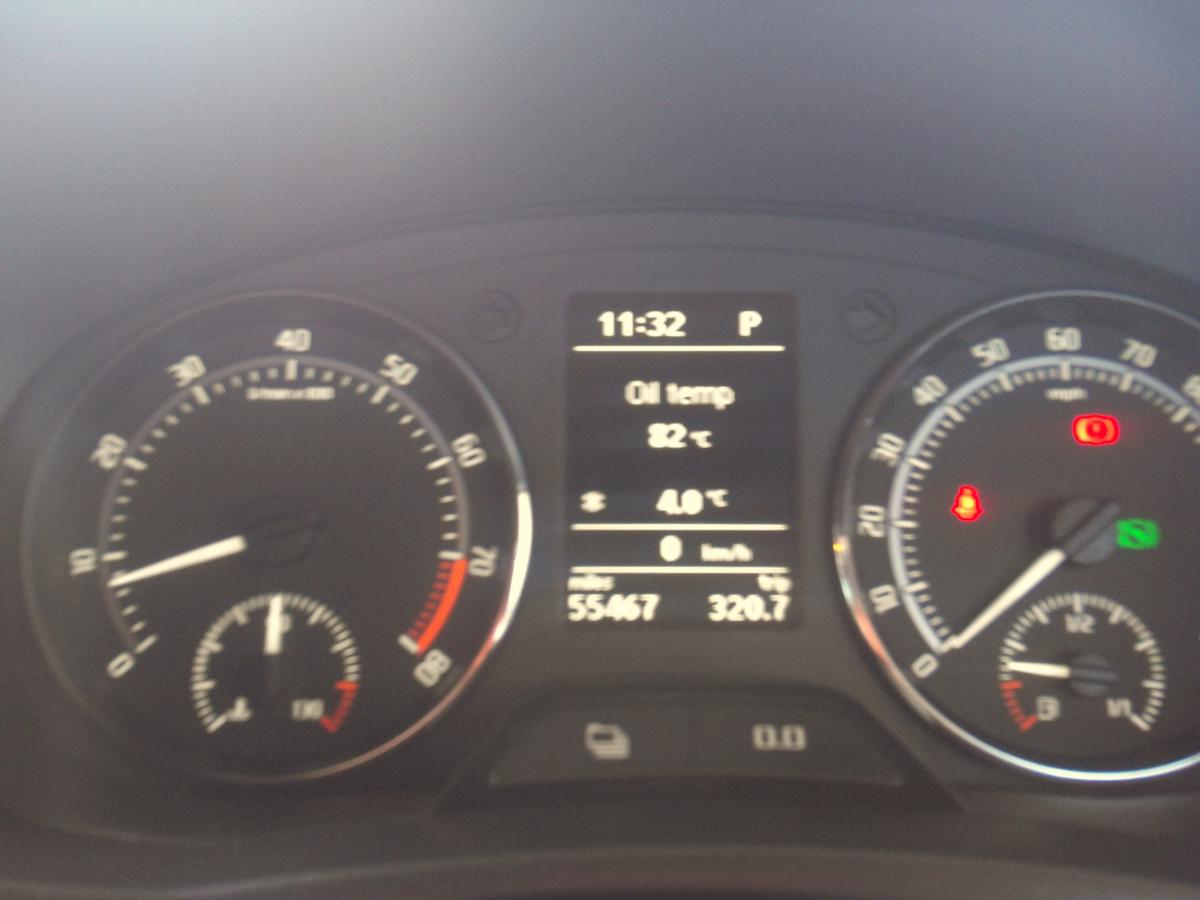

Hello just bought estate. Running fine for a month then oil temp warning came on 86 of? Is it a problem ? Only 90 half way on clock.

Hello , no oil light , just warning letters and 86 in the middle info cluster.

Turned engine back on after five mins 84 , probably just saying it’s temp. Was normal white letters :)
  • Sponsor
An oil temperature of 86 is not remotely warning-worthy; so you probably just accidentally switched something to make it display oil temperature. Relax.

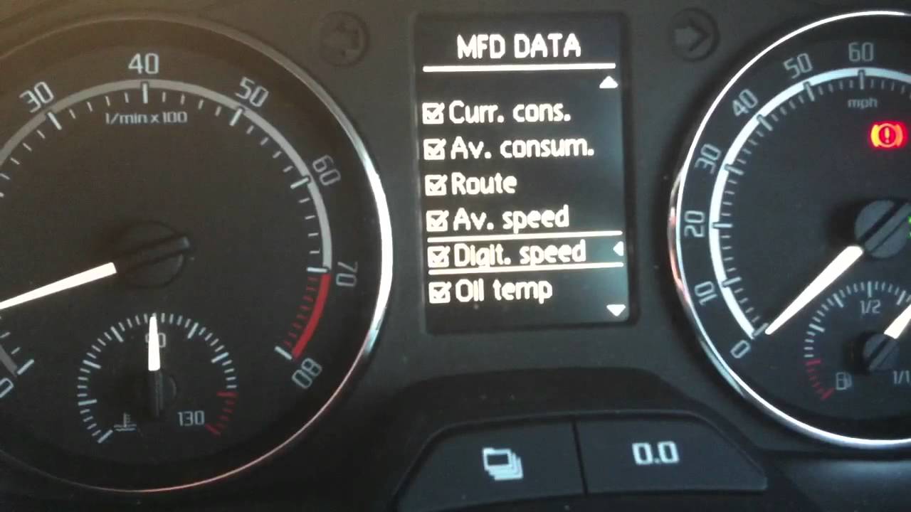

You must have gone to a different setting on the maxidot if not usually on Oil Temperature.

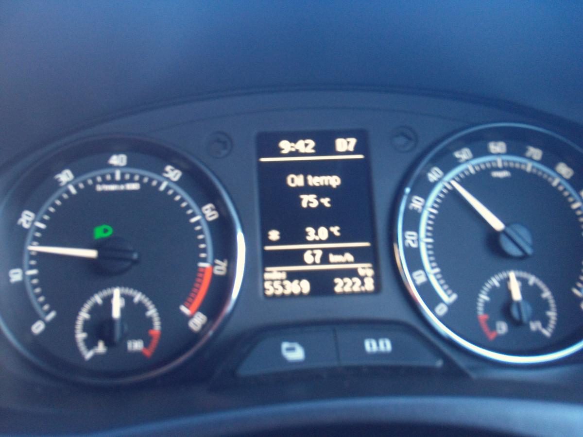

Oil temp once up to temp is usually 92 on a Twincharger, goes between 90-92 when just trucking along, can go up to 115 + when driving hard and spirited, and then should drop as you slow down.
What were the warning letters?      The Coolant gauge is different.
Car getting up to temp and then oil at near normal operating temp for trundling along in winter with 5w 40 FS oil .

Oil temp does not come on until 50*oC then gets up to the 90*oC etc eventually.  You can leave that showing on the dash if you want it, or the fuel average consumption 1 or 2, or range etc.
That must be it , I just never seen it on the screen.
