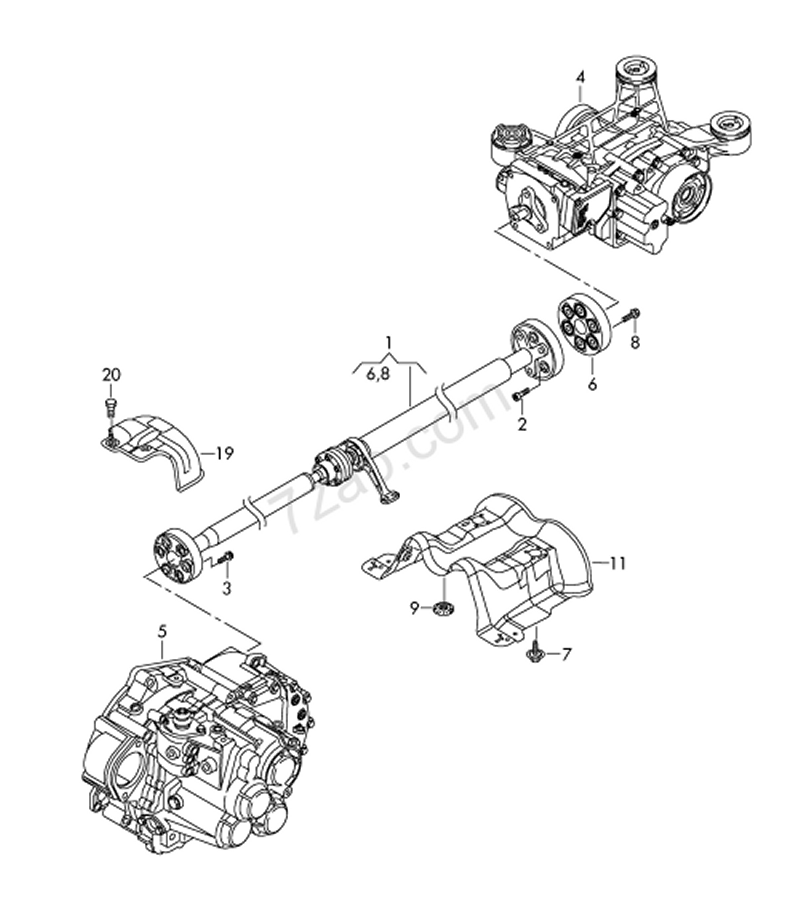

I was wondering if the flexible coupling connecting prop shaft to diff is causing the trouble?
looks like an effort to change!

Could it be part number 6  here?
Hello
That has been my thought for some time now.
Unfortunately not something I can change out working on my back.  My Yeti has the one piece prop.
Looking at the manual it seems to be a bit of a job?
Regards.
No, not a whirring sound. If you want to be 100% sure then remove the propshaft and road test.
