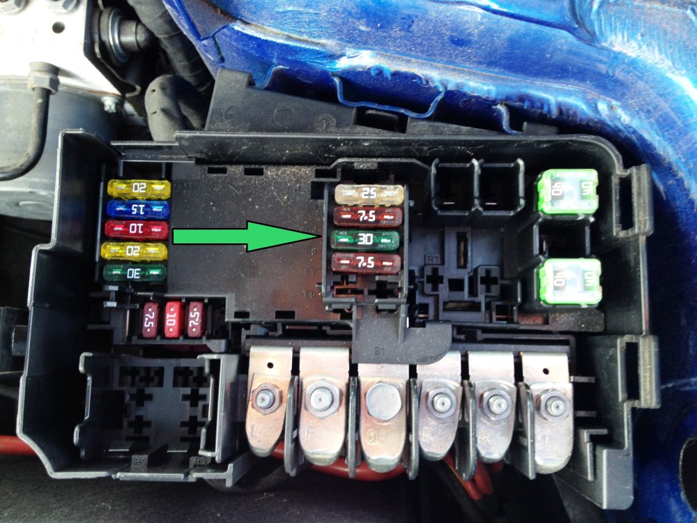

Plus show where the fuse for the wipers (30 amp) actually is rather than the confusing diagram in the driver's instruction handbook 'OPERATING INSTRUCTIONS'.  - http://manual.skoda-auto.com/004/en-com/Model/Fabia_NJ

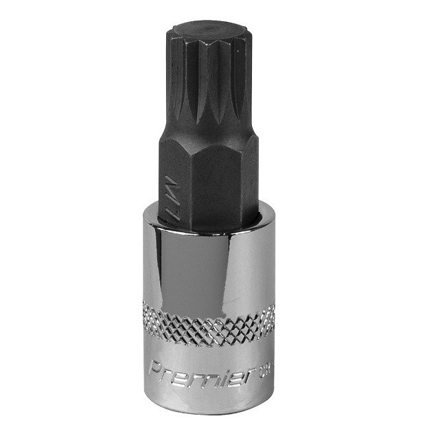

As well as general tools you will need to have or beg or borrow an M12 Triple Square XZN Spline tool bit for the big screw that holds the steering wheel on - and I'd add some thread lock back on that screw when putting it back and T25, T15, T10 Torx screwdrivers, and a small pick is useful to raise the orange locking tab bit on the airgbag connector plus a can of good quality contact cleaner.  After cleaning for contact switch lubrication I use Servisol Super 10 Switch Cleaning Lubricant.
