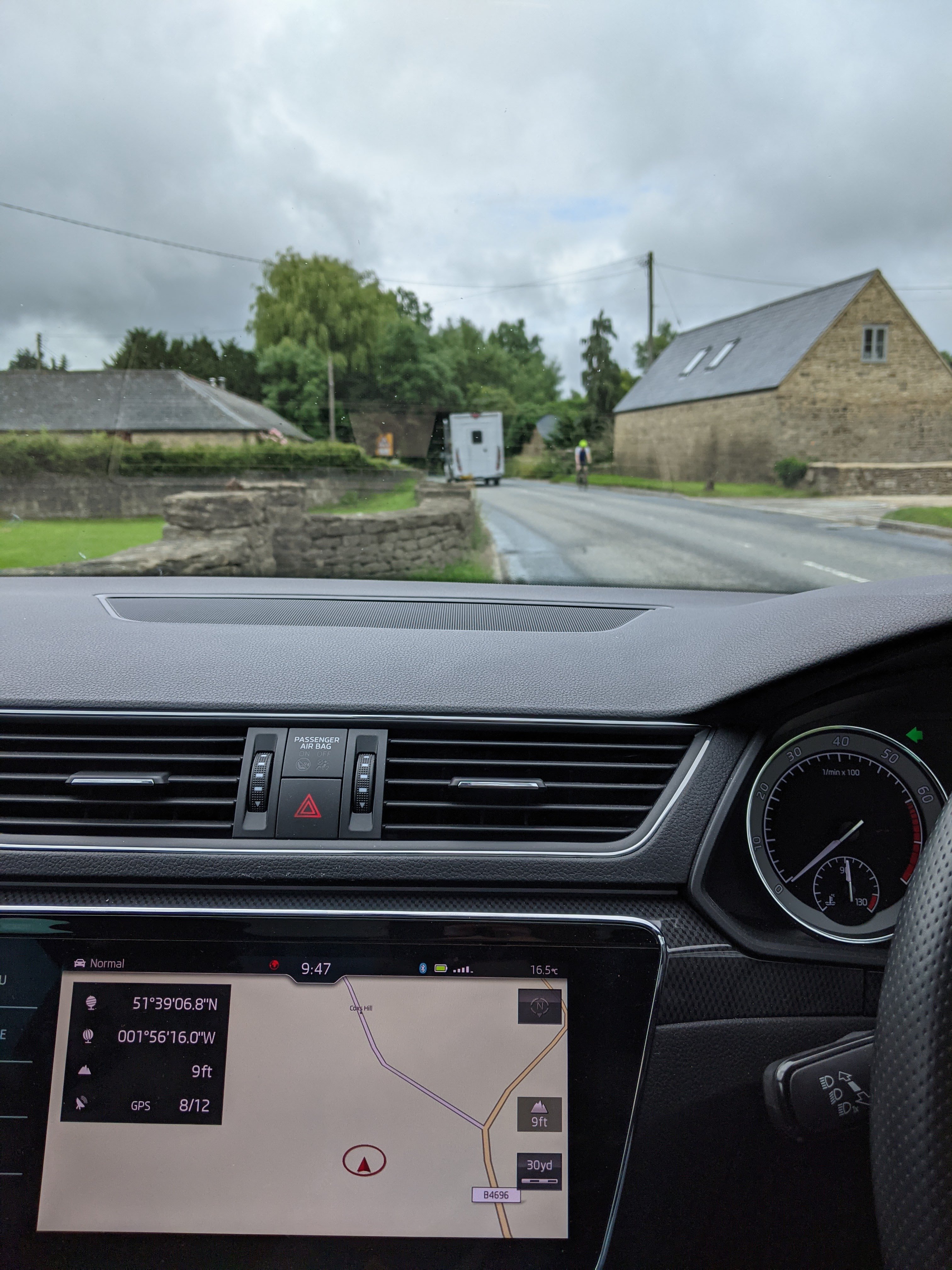

Whilst the navigation system works, the location is sometimes a fair way away from where it should be. By which I mean if I'm driving along, the system might place me somewhere adjacent to where I actually am. It doesn't happen constantly, but it does happen a lot.
In the example here, the car things that I'm off road about 50m away from my actual position (shown by the black arrow)
https://i.imgur.com/GSB40fo.jpg
Whilst I can generally work out where I actually am this can be quite frustrating when I'm perhaps driving along a main road quite happily and the system is going mad trying to navigate me out of the adjacent housing estate.

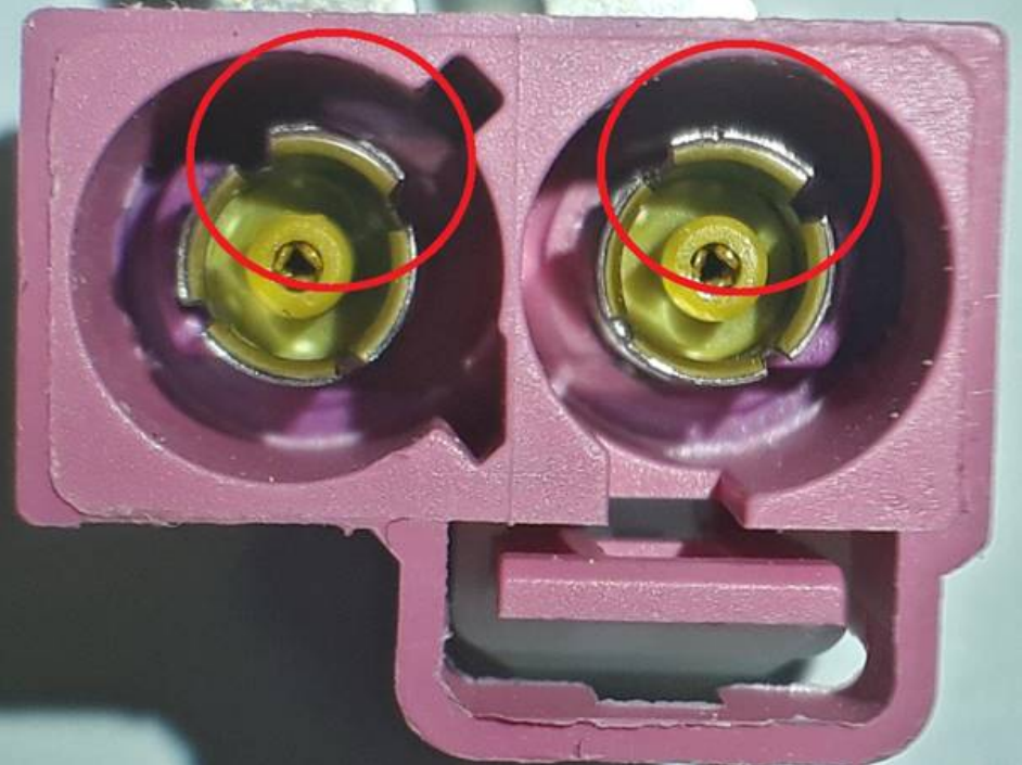

Oh, actually, I just remembered a TPI regarding damaged GSM/GPS fakra connectors - so check those are in good condition too. In the example below, the circled tangs need pushing inwards to repair the connector:

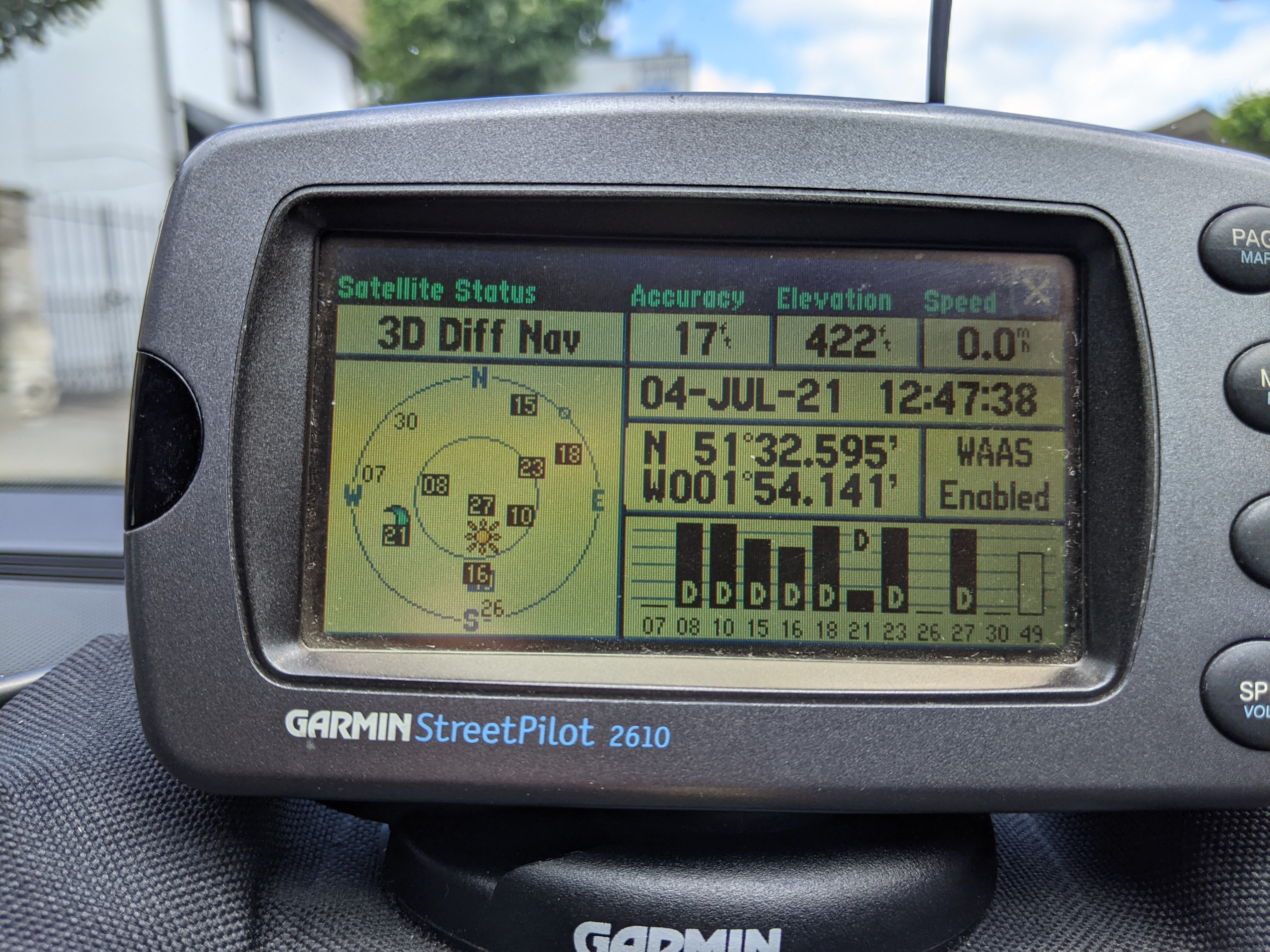

Both the car and the Garmin seem to be identifying the same number of satellites (and it's still 8+ when the location is wrong), however the Garmin handily says what the accuracy is. Not sure if there's a hidden menu on the head unit that provides that.

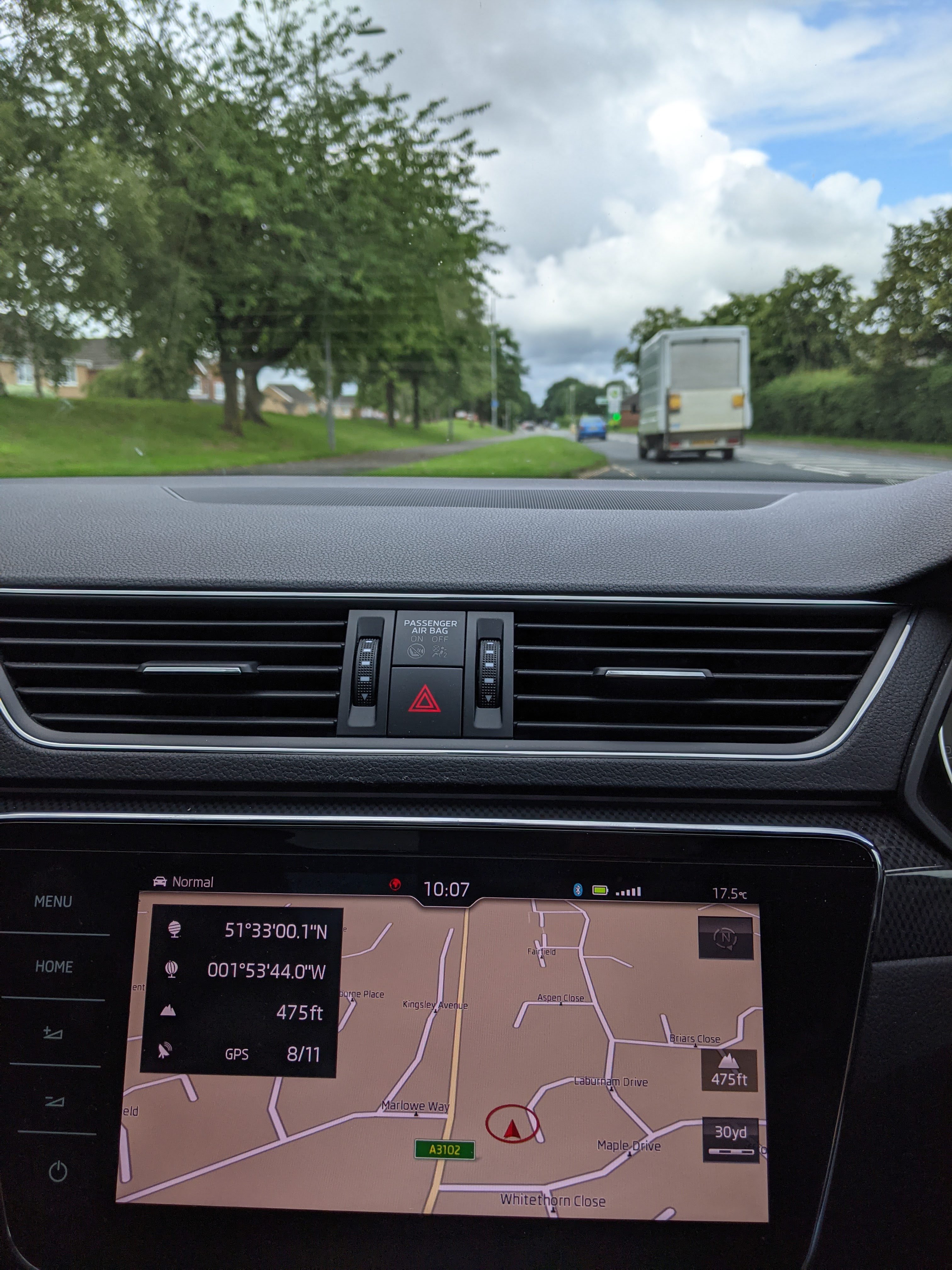

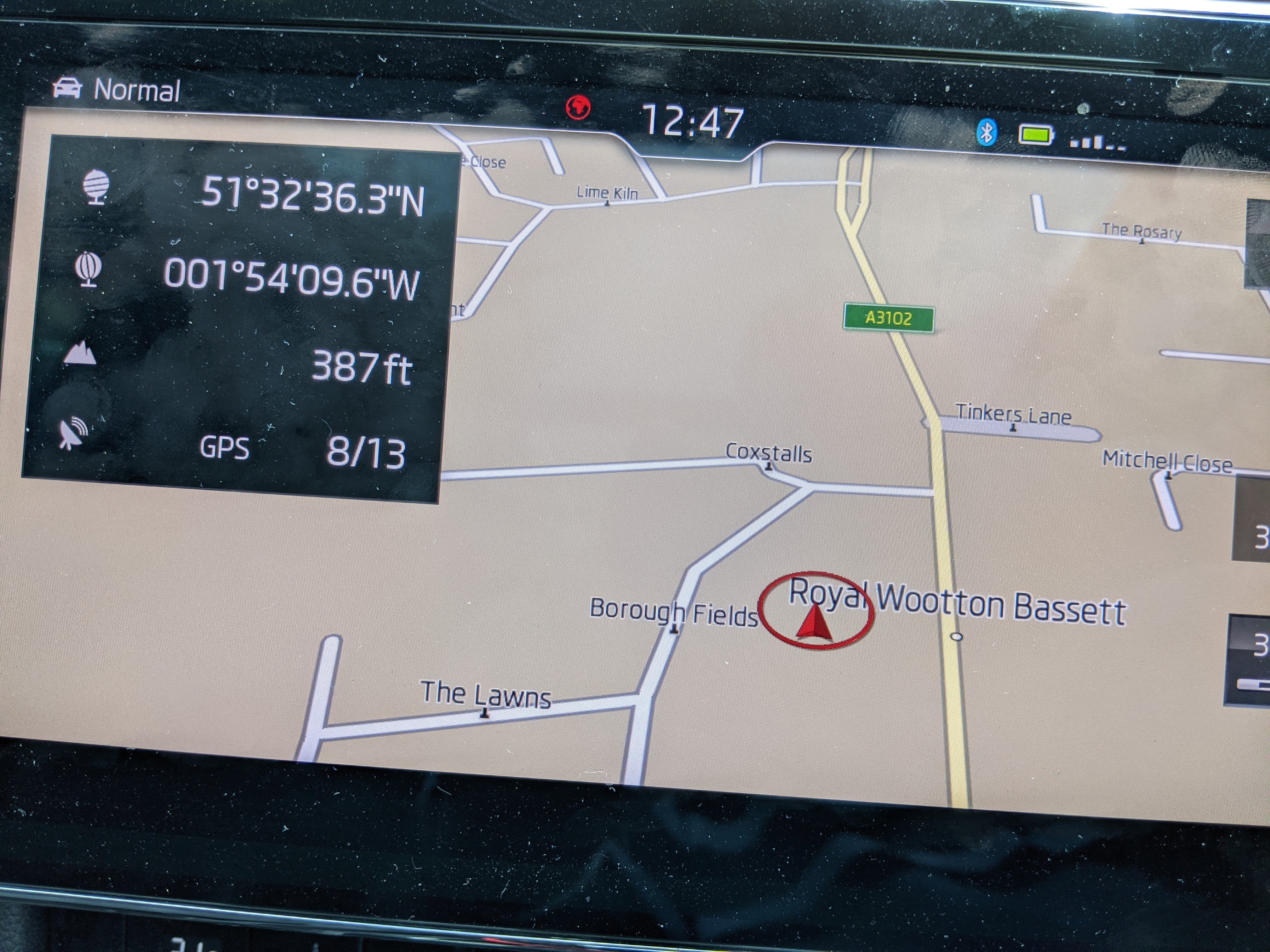

Oh, I might be doing the photos right...
I pulled into the side of the road for the photo. I'm actually on the B road, just before (lower) than it's shown on the map
Here I'm parked on the A3102, just past Marlow Way
On the return journey, still on the A3102, pretty much on the dot under Wootton
Note that heading both directions, it's placed me to the North(ish) of the road that I'm on

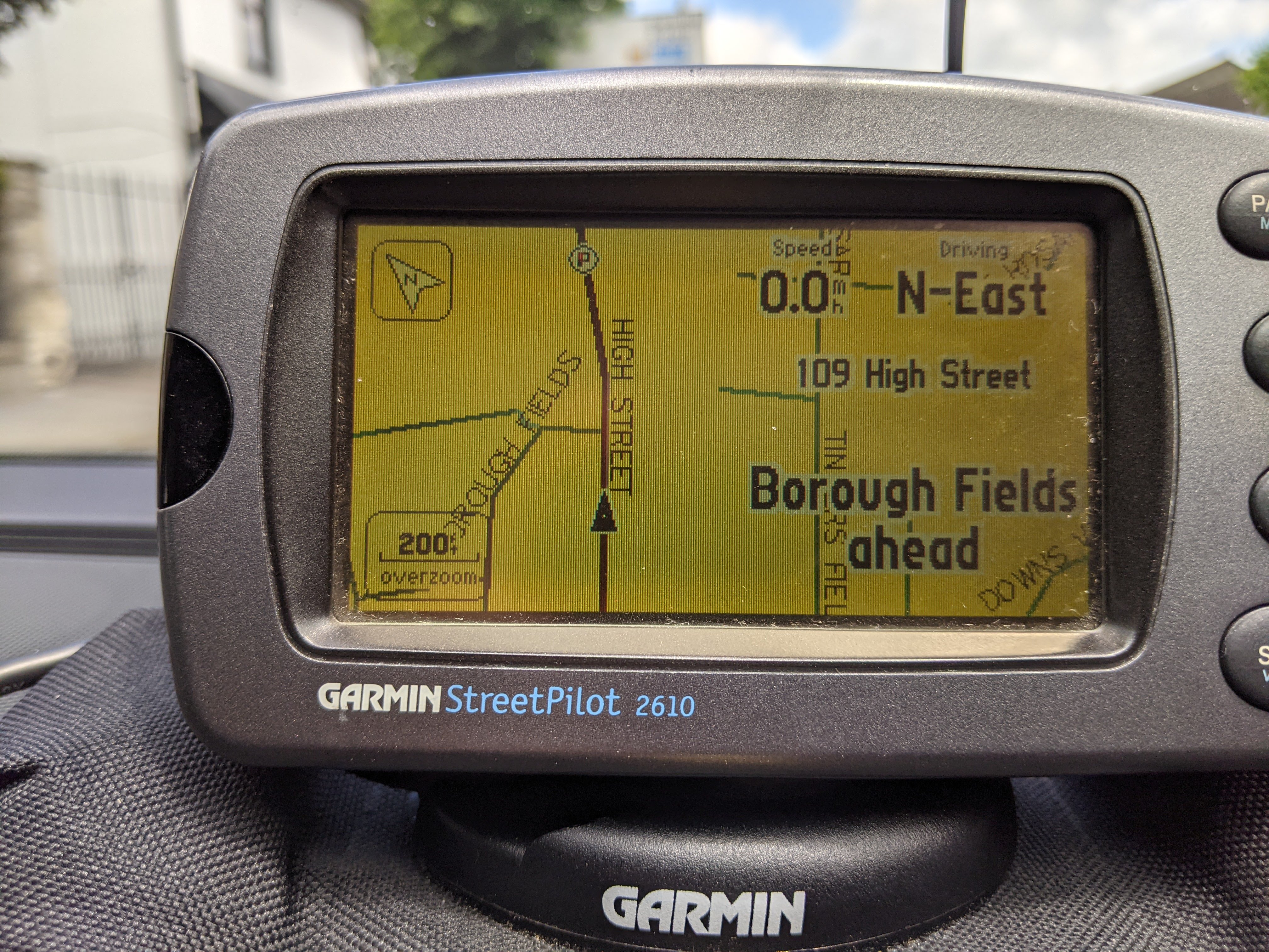

For the last one, here's where the trusty Garmin put me
