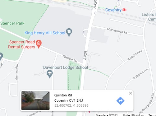

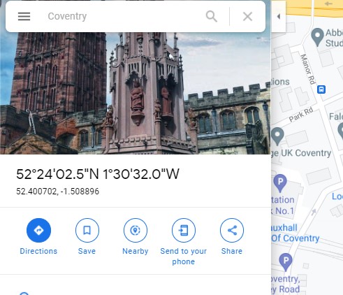

These days, if I'm going somewhere I haven't been before, I use google maps to locate the site, streetview to find the entrance to the car park, or whatever, then drop a pin in the map at that point.  That then generates digital co-ordinates (first pic) and if you click on them, it gives another box with DMS co-ordinates.
