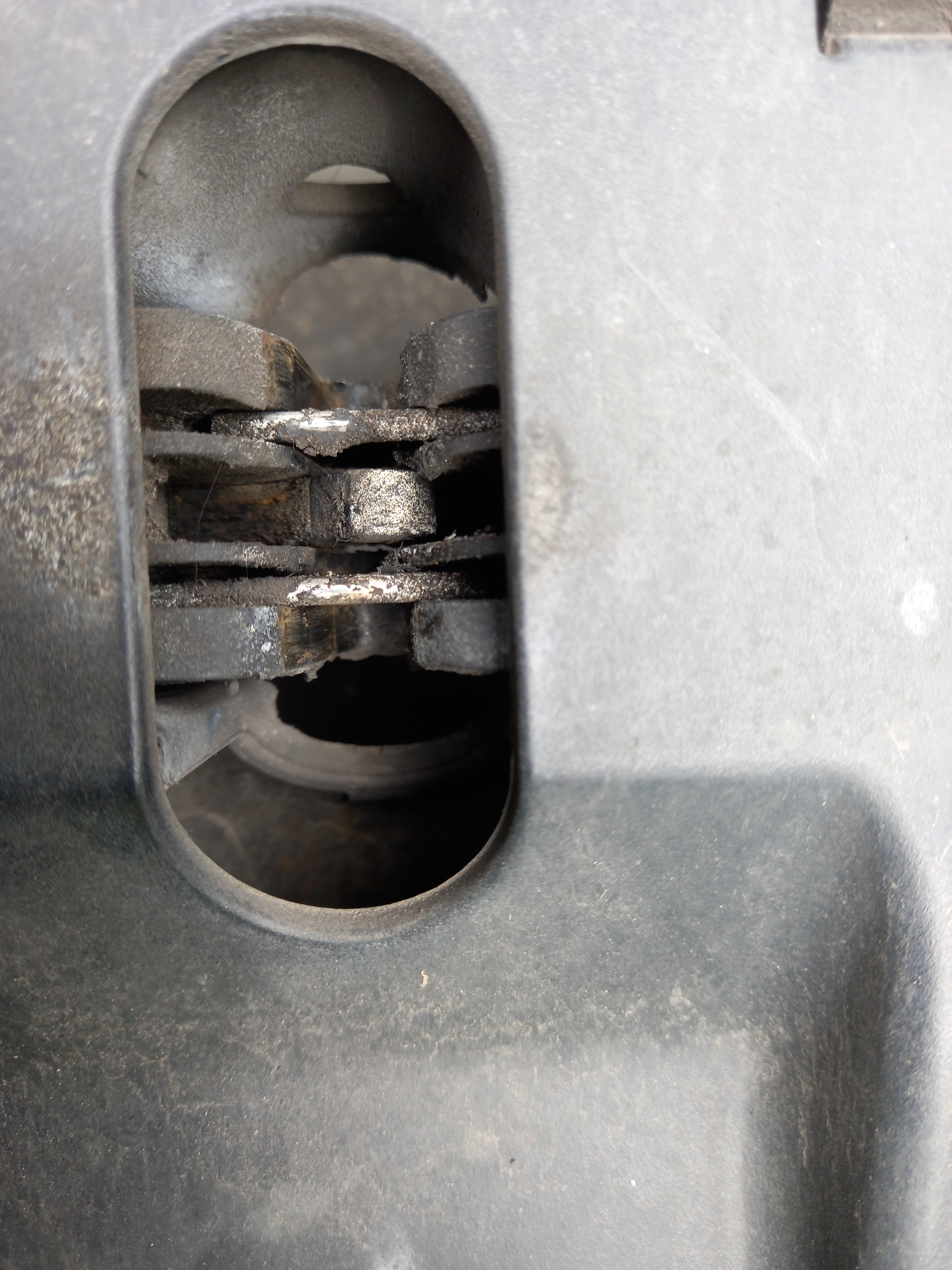

Start by opening the bonnet. Then push the bonnet latch down (like it would be if you let the bonnet drop again). Use a screwdriver or similar:
Now the car won't think the bonnet is open even though it is.

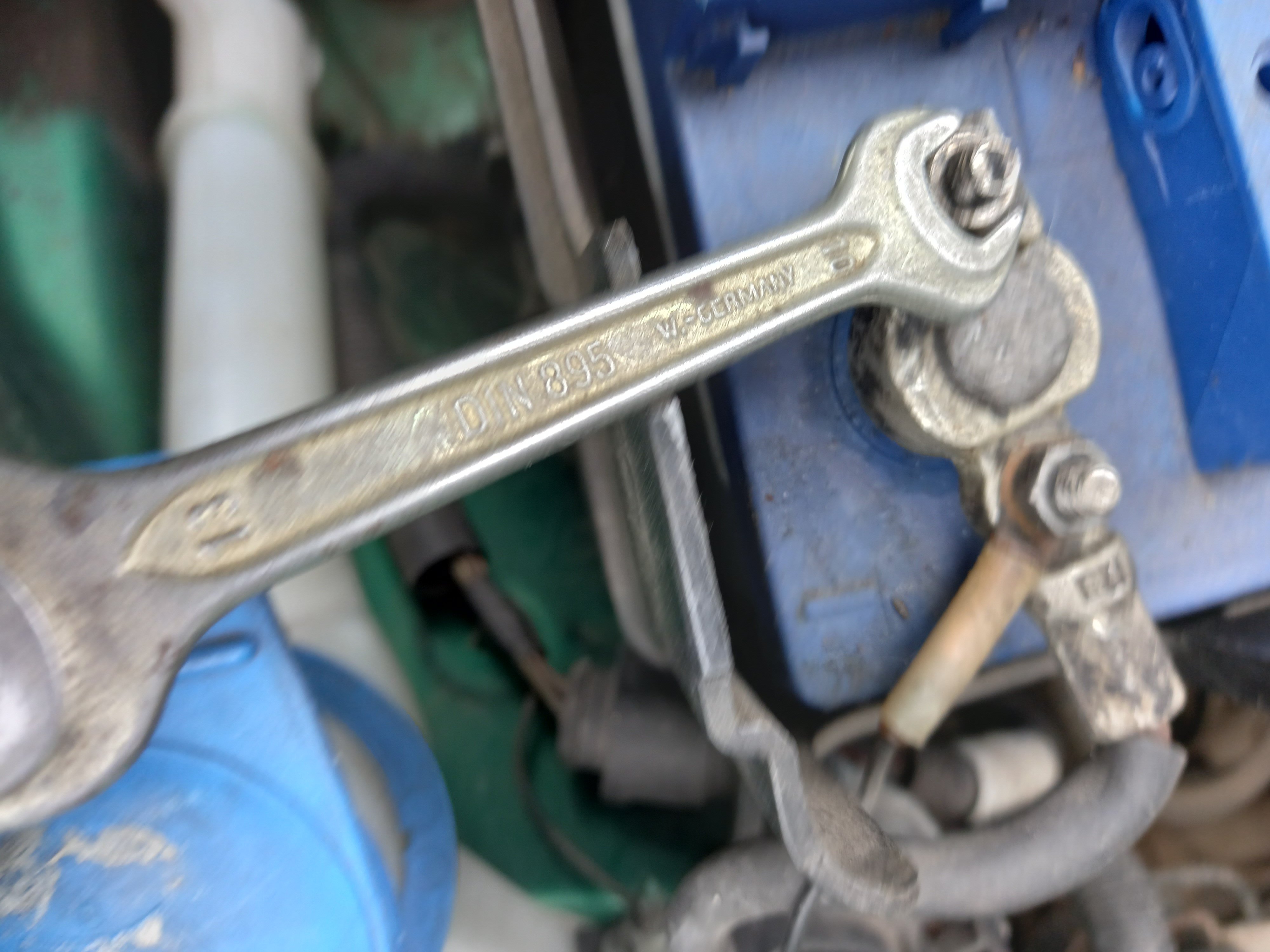

Loosen the battery negative terminal so that it can be pulled off vertically very easily, but then leave it fully down/connected:

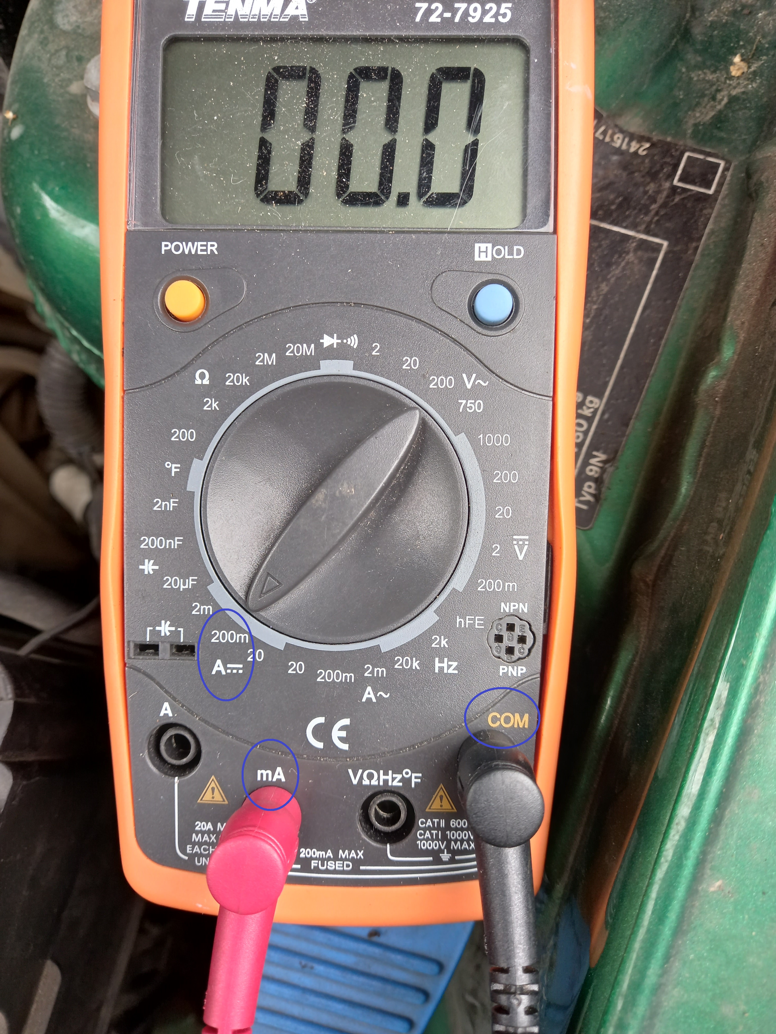

Set your meter up ready to make a measurement. Dial set to a range like 200mA DC and the probes in the appropriate holes:

Didn't the bonnet being open stop the car locking and shutting down properly?
  • Sponsor
That's why you flick the bonnet latch over, so the car sees it as shut.
