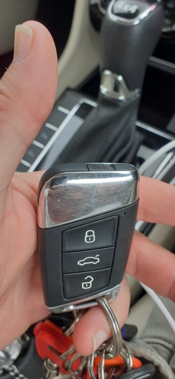

Hopefully a quickie, the key fob battery needs replacing it tells me.
Can you tell how to get to the battery in the fob with the removable slide key, it's the black and chrome type fob.
Also, what battery type I need.
Many thanks
You need to take the key out and use a thin screwdriver to pop the rear off from the place where the key has just come from. The battery is either a 2025 or 2032 but they are in essence interchangeable.
@Corbarwolf- how to video below.
It's quite easy to remove the back cover, and get the battery out.
Correct battery is CR2032.
CR2025 is a thinner battery.
https://youtu.be/Z0rhA9LqEGk
Brilliant, thank you gents.
I changed mine again the other day (it seems to eat Duracell CR2032s) and I can just unclip it at the side with a plastic trim tool without pressing anything down the emergency key slot or taking the emergency key out.
