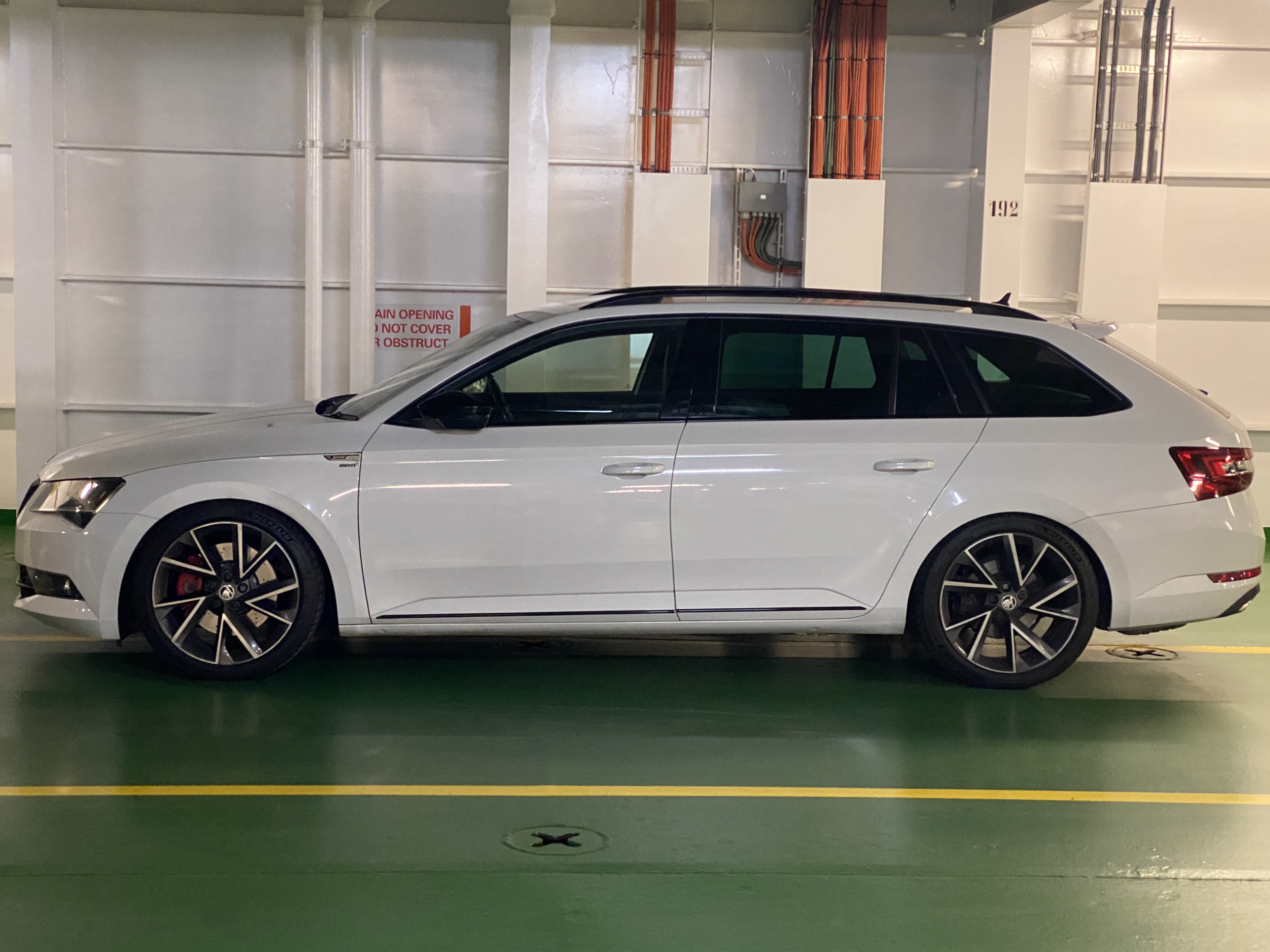

I’ve gone with koni special actives. Massive difference. But I am also lowered on H&R
Nice setup!
What top strut mounts have you used?

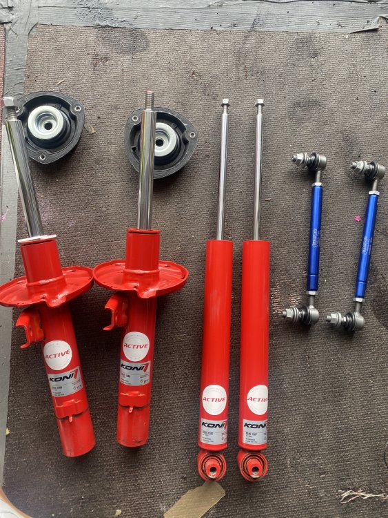

Having my special active fitted on friday.  Stock height though.  Happy to report back for those with Superb iV's.

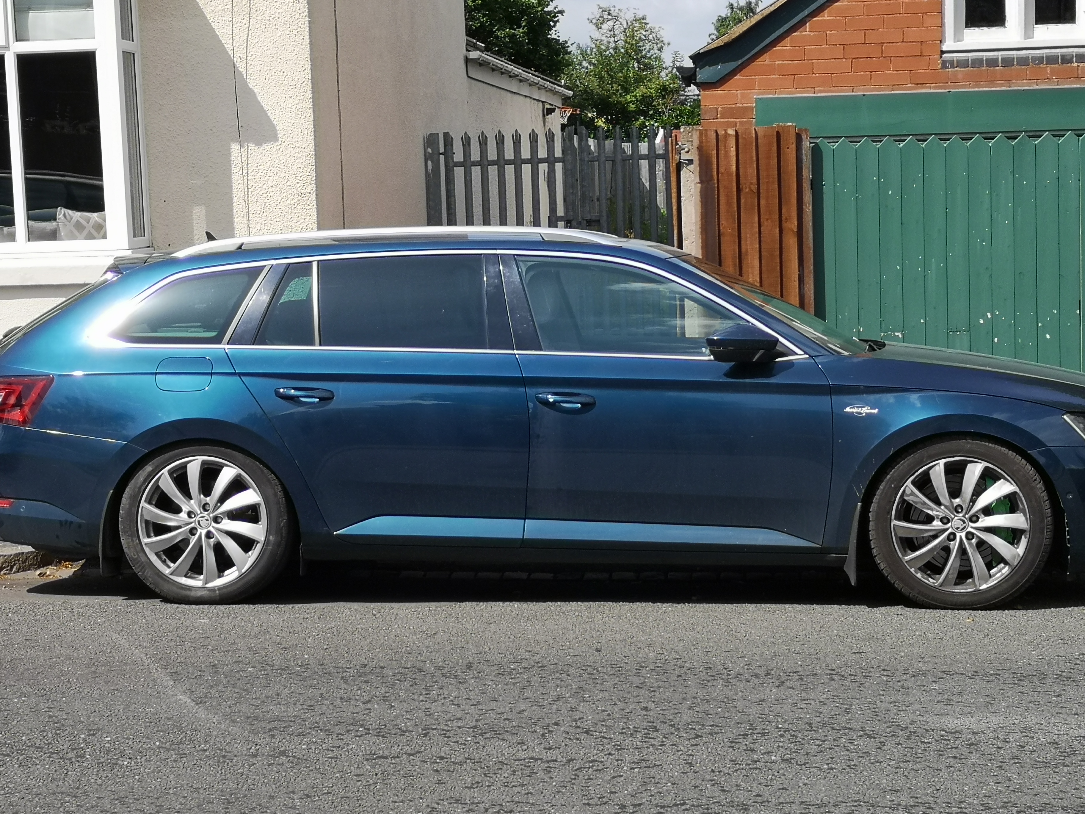

:biggrin: Think I need to get my mines raised!  Im on B16 damptronics.
Wife was complaining as the ride became bouncing at high speed.

Shocks fitted this afternoon. Only had the drive home to try it out so far and the feeling is actually similar stock over normal bumps. Support however is much better. Turn in is sharper and the reduced roll means that return after a turn is improved.
That's my 5 minute review.  I'll give it another go once I've enjoyed it for a few days/weeks.
Edit:
I do have a small handful of related mods that would add to the feel. Rubber ring spring assisters in the rear, dogbone insert, 12mm spacers front, 20mm spacers rear.
