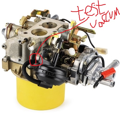

1- i sucked vaccum form second stage unit of carbruter and it worked
2-i connected vaccum gauge to 2nd stage hose house in crabruter it self and rise  throttle lever to high rpm around 4000 rpm but no readings (this confused :notme:) https://streamable.com/ngo7vm
3 rise throttle lever at high rpm no fuel squrit in second stage in top of carbruter (this confused :notme:) https://streamable.com/n5b2df

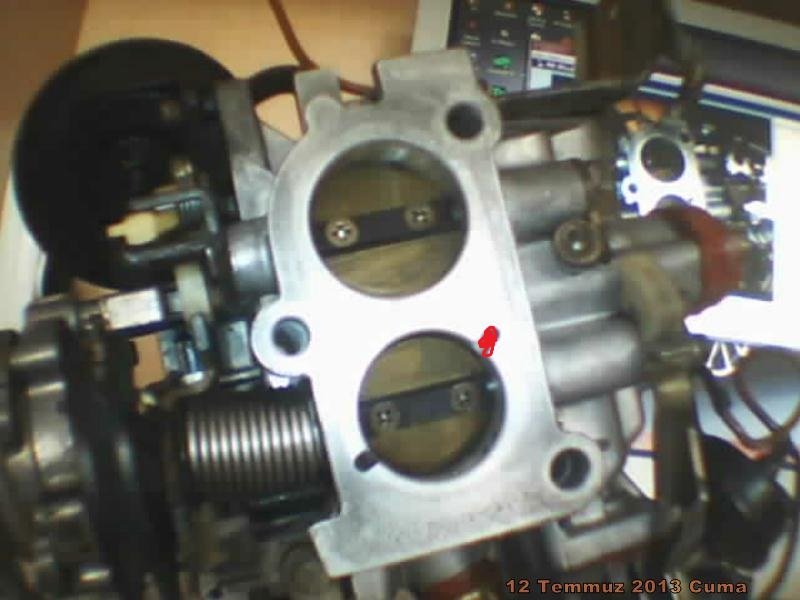

3.1 What do you mean by "it worked" ?
3.2 Not sure if you understand how 2nd stage works. The video is too blurry.
3.3 There is your problem.

Check for blockage of the "2nd stage hose house in crabruter it self".
One way to do this might be to connect a long vacuum hose to this port and suck on it.  You should not be able to form a vacuum in the hose if the port is unblocked.

3.1 :- i mean i connected vaccum tube to the 2nd stage Vacuum actuator while engine is off and make throttle gas open at max and suck the tube the second stage open and close normally https://en.hoffmann-speedster.com/bus/bus-t3/engine/carburetor-air-filter/14886/vacuum-actuator-2e3-82-92-1.9/1.6-1.8
3.2 :- there is no space to take good video but i try to know if any vaccum goes throw this pipe or its clogged by connecting vaccum gauge and rise engine rpm on neutral but no readings at all (( i dont if that is right way to test or not ))
3.3 :- what you mean that this is my problem
I said THERE is your problem, not THIS is your problem, meaning "Look! We found the cause of the low power problem."

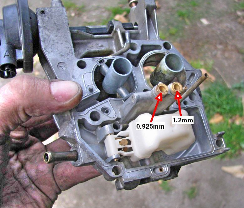

1- what is the 1st and 2nd stage screw jets number is it 0.92 mm and  1.2mm ?

1- the screws of two stages i bring from skoda part shop if they are after market they can be not calibrated as they print on it (might be tight) lets say if 2nd was 120 but really it is 110 can this affect top speed ?

Oh oh! DO that and you're liable to ruin the threads. Or did you mean jets, because those numbers look like jet sizes?
yes jet sizes i thought that after i change the big size  that carburetor Technical shop i replaced them with the correct size but i dont trust them as they are after market parts
It is vital to have the correct jet size. It affects the mixture thus the performance of the car. The size is written on the jets.

1- the jets size written as you said but how i know if its calibrated right i mean is 120 is really 120 it might be less also another jet 92.5 might be less i dont trust after market parts at all how about i bought jets from used carbruter (geniune used jets)
Don't worry about it. They are fine. They don't get decalibrated. Worst case scenario they get dirty with gunk from fuel. Clean them well. Use a magnifying glass if you think they are still dirty. Don't use steel wire to clean it.
