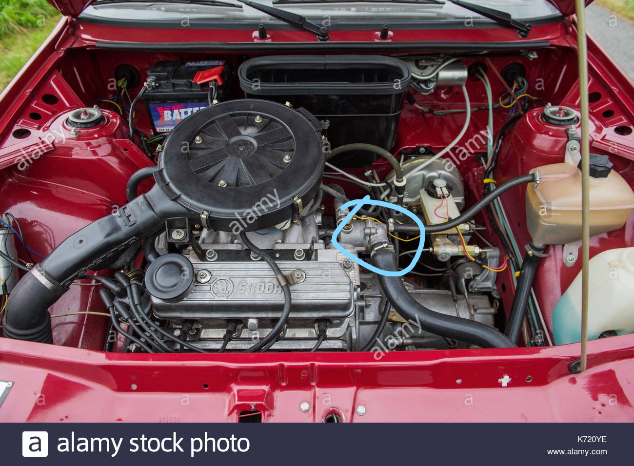

can you pickup some pictures of hoses to be more clear
1st upper rad hose
2nd lower rad hose
Inkedbakov-nad-jizerou-czech-republic-13th-sep-2017-skoda-favorit-admirer-K720YE_LI.jpg
2 hours ago, Thefeliciahacker said:
1st upper rad hose
2nd lower rad hose
step 3 you mean i stick garden hose  in thermostat housing place in engine itself ?
step 4 dont get it clear ?
step 1 to 6 while engine is off and cold ?
Yes after you remove the housing let water flow from the head downwards
So you have removed the thermostat housing and you have the upper rad hose free. One time feed water into the head so water will flow out of the upper rad hose the other time feed water to the upper rad hose so water flows out of the head
All steps cold and off only step 8 is more effective with a slightly warm engine right after turning it off (before all the solids sink)
