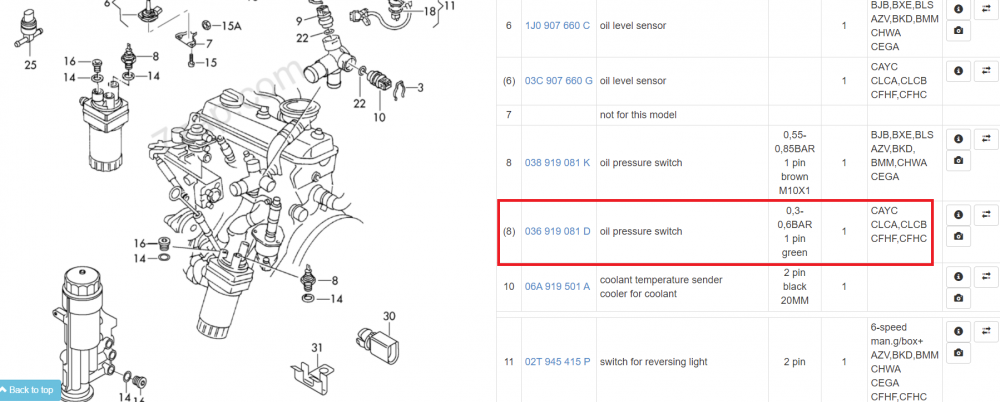

Thanks @pikpilot. So the pressure switch (marked in red. herring or otherwise :D)  has a rating described as 0.3-0.6 bar.
1945900905_Screenshot2021-07-2312_39_29.thumb.png.b30cc6313ef81a7b168c6429e26bc8db.png
So your oil pressure is dipping below 0.6 bar at around 1500 rpm sometimes, if my understanding of the warning system is right.
That's clearly not consistent with it being more than 0.8 bar at idle, as the test instructions suggest it must be.
Unless the warning system is malfunctioning, or doesn't function like I've described, but I've suggested a way to check that already.
