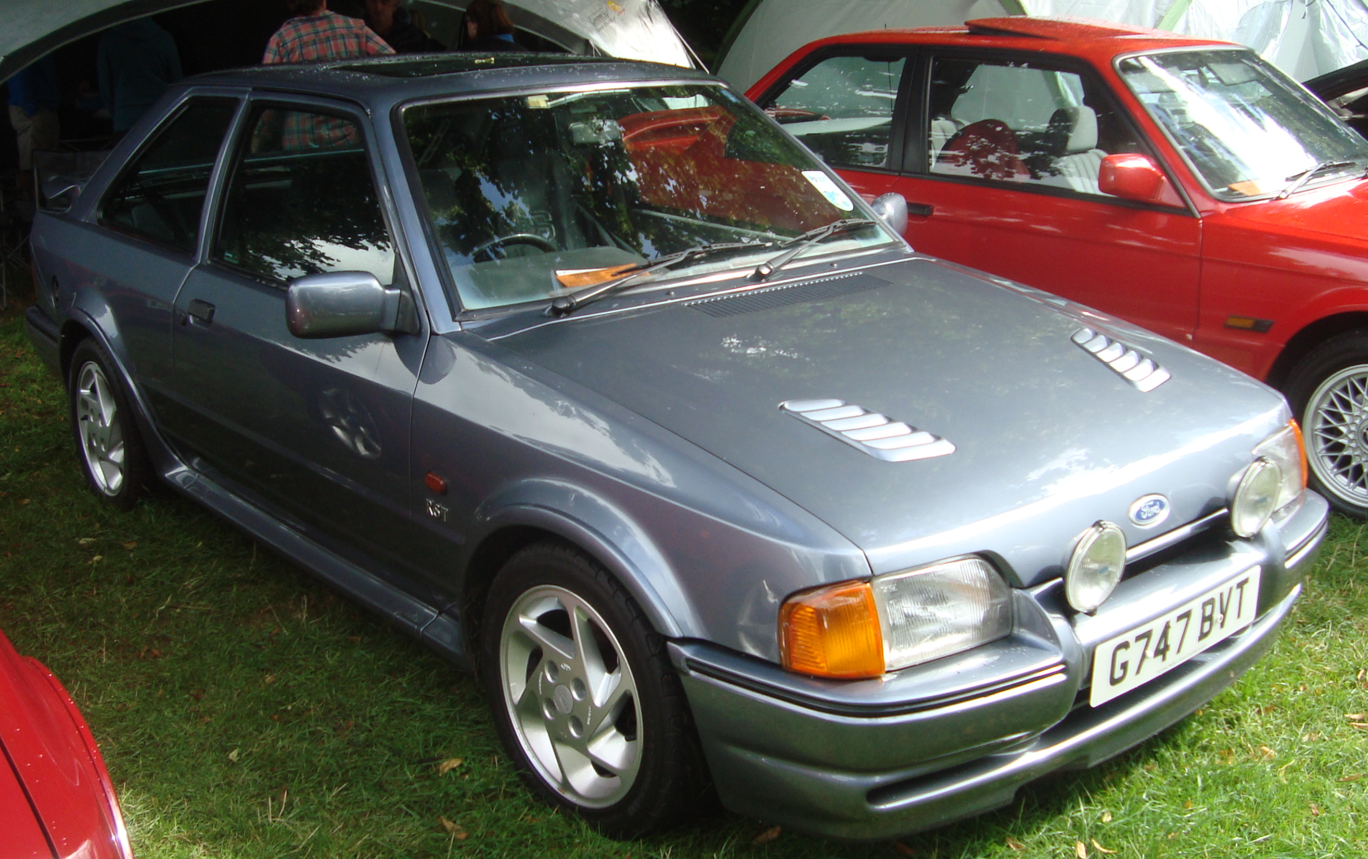

Thermostatically controlled louvres that open/close to allow cool air in and warm air out help.
I think there are already some cars with this feature on, and I think it's a great idea. I think they're normally implemented at the front, and generally to help the engine warm up quickly.
I don't see why somethign similar couldn't be implemented on bonnets.
It might be "cool" to watch your bonnet louvre vents open and close automatically from time to time in slow-moving traffic on a hot day, and genuinely useful in lowering under-bonnet temperature.
(A little off topic, but I remember the trend of people sticking fake RS Turbo vents on their bonnets, so public acceptance of bonnet vents probably wouldn't be a problem.)
