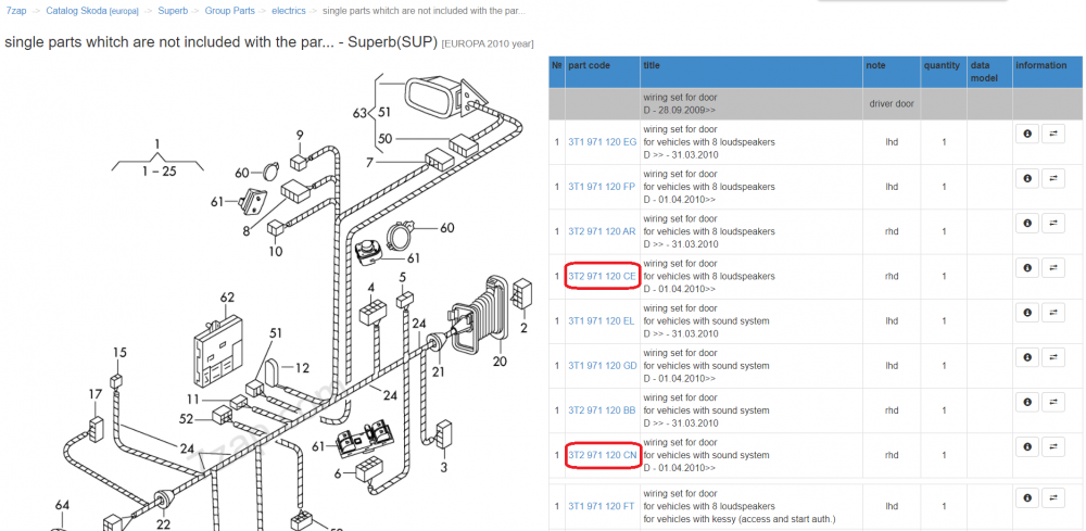

ordered a new one but it appears wrong.
I checked with 2 dealers (none local though 😡 it shut) for the right part number and then ordered it through TPS.
mine has 13 connectors the new has 12
there is 6 speaker cables on the original plug
the new has 2 cables that then go into the big speaker and come out to the tweeter by the handle.
there is no connector for the medium sized speaker.
have I got the wrong cable?
old - 3T2 971 120B
new - 3T2 971 120CE
i could just chop into the tweeter wire and run the middle but I’d prefer it to be right after forking out the dough!
any knowledge would be greatly appreciated.

The issue is not doing the job but the part itself.
2 Skoda and 1 Vag trade part supplier told me CE when thanks to that little site up there 👆🏻 it is infact CN. (I live in Basingstoke and our dealership shut down. They’re all roughly the same distance and off course the trade supplier was £30 cheaper)
all three using the cars VIN number not guessing based on year etc.

Oemwolf.com is a handy site for looking at what's been superseded by what.
I checked your old part number on there and it changed to suffix CN in two steps, with something like suffix BB in the middle.

i AM BEING INFORMED THAT i AM WRONG AND WITH THE SOUND SYSTEM IT IS SUFFIX CN not DF
sorry for the caps.
3T2971120CN
I still cannot believe you supplied VIN, and they still managed to give you the wrong part.
It literally shows up in bold, for the parts that fit, and when they go to order and see price, it shows superceded.
