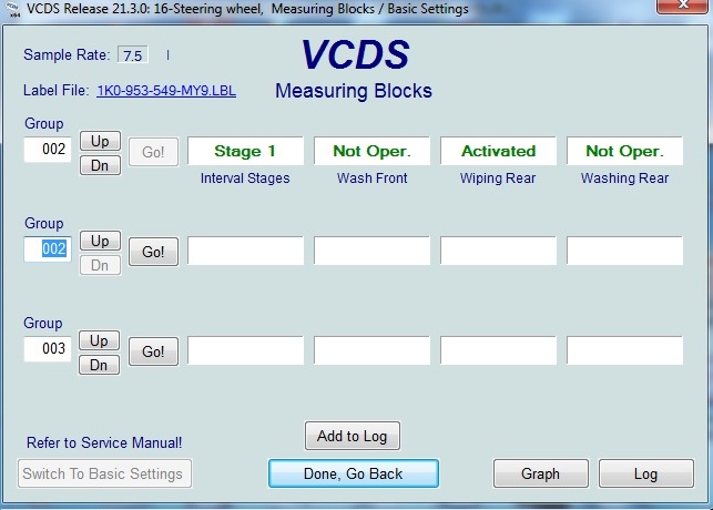

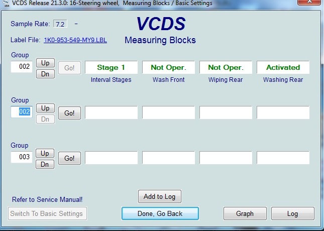

Checked out the measuring blocks....
This is really strange.
There is still no fault codes - but I can see in the measuring blocks that the lever i operated.... but the rear wiper motor nor washer operates - only when I operate it with VCDS.

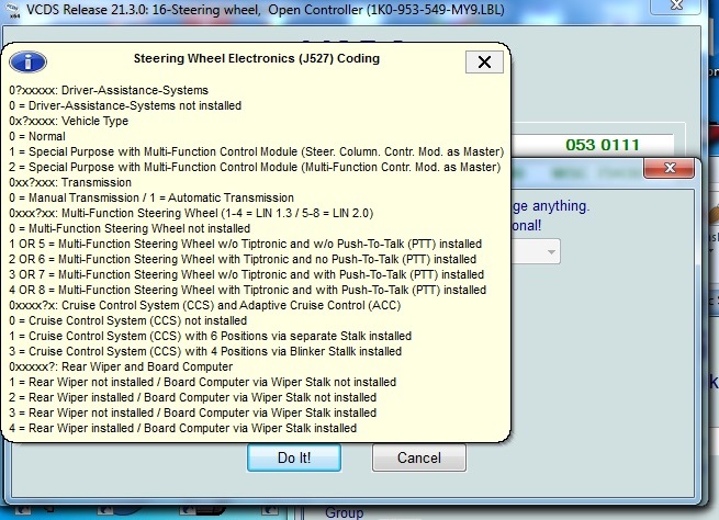

If the coding for either module had accidentally got changed to 'no rear wiper fitted' that might explain things.
No - checked the coding too - its correct at 00034:

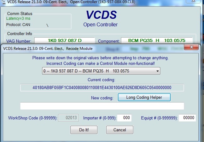

I dont know if this looks correct - Long coding for Central Electric module:

You're well into @langers2k territory with that last screengrab, I have no idea about long coding.
Me neigther =)
Ill try to contact him/her and ask.

I think the rear wiper coding is in byte 21, yours looks to be 6D which seems sensible enough - assuming I can count :D

What about the "long coding"? I dont even know what that is for?
The wires from the stalk/switch go to the steering wheel control unit.
The steering wheel control module will then send a CAN message to the BCM asking it to activate the rear wiper.
The long coding helper will help explain the long coding ;)
