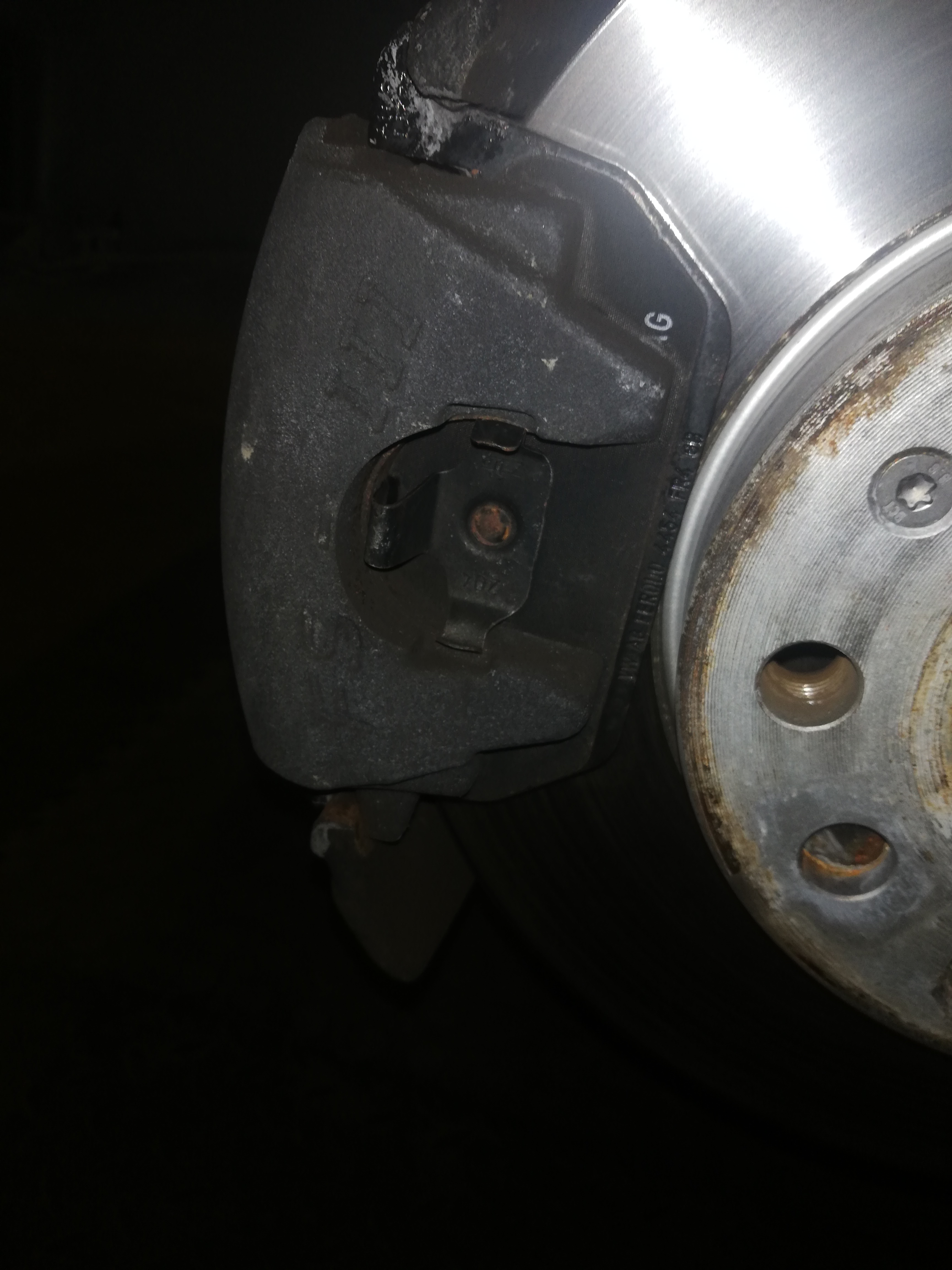

Here it is a pic.
It was factory one before the change and it looks like they used clips
You can order the correct part numbers and get the part numbers from your Skoda dealer.  Brakes are a interesting subject for MK3 Octy's - as there are different brakes/disks and calipers for all the different models within the Octavia range.....it might be the case you actually have the wrong part installed!
I don't know, because i ordered with vin number. So i checked this website and picked the analog one. I choosed the Bosch one here, with Bosch discs too.
