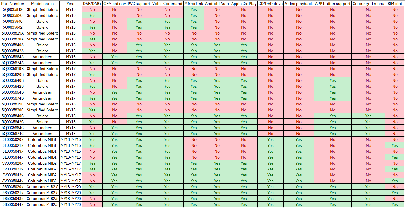

If anyone finds any issues with the table above pls let me know
Awesome .. thank you so much
Are units from VW interchangeable?.. if so would this car have the right bits for what I need?
WVWZZZAUZFW274523
