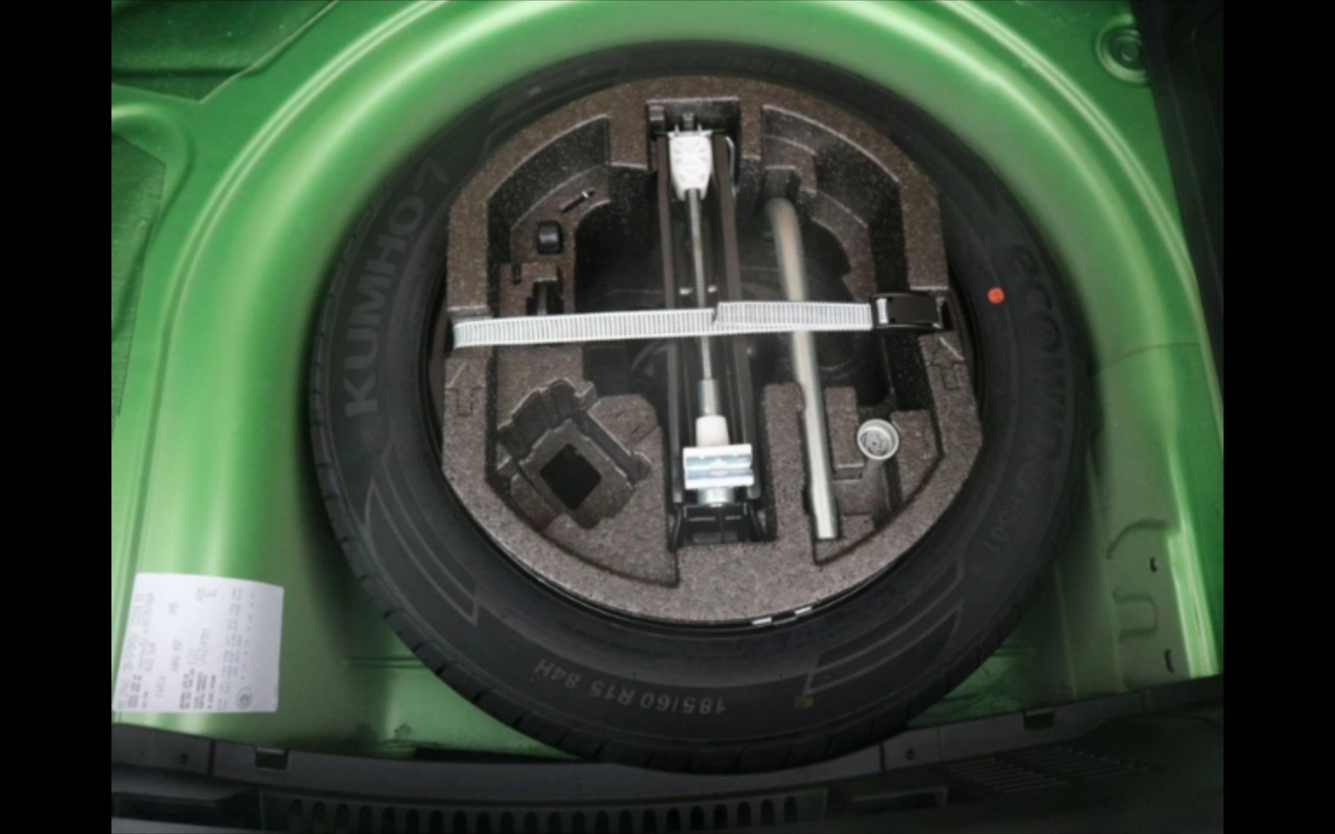

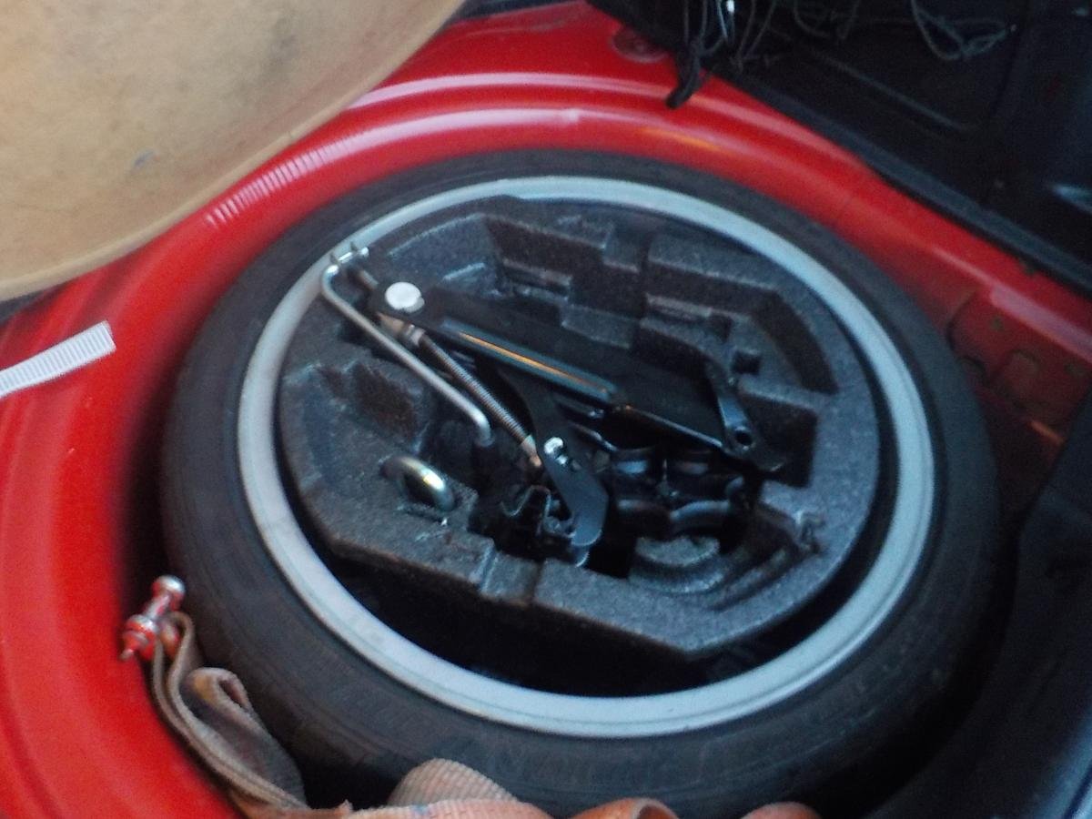

Any wheel / tyre of the correct size for the car goes in the spare tyre well and so will the tools.
If the wheel / tyre does not match exactly the one on the same axle then treat as a emergency spare and slow down. Even if there is no warning sticker.
http://briskoda.net/forums/topic/461276-spare-wheel-for-mark-2-fabia
Screenshot_20180618-191509.png.38647d1ed1128f9bb13a9b3bc36d1f34.png.9ec0a8df4aa5c2d4ec36d80d264b68ba.png
post-86161-0-71052100-1451813026.jpg.b6bafcb2307af0296069da51461be49c.jpg.a1b898de5409376618d7af4003b85b58.jpg
Thanks in particular for this, really reassuring and shows it can be done.
