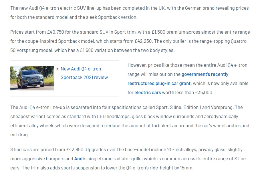

So far each of the Audi drivers i have spoken with and that is about 8 at chargers had a Tesla before the Audi and are happy as Larry with them.
Pleased to hear it, but the base price is about £10,000 more than my Enyaq so I guess it should be better !

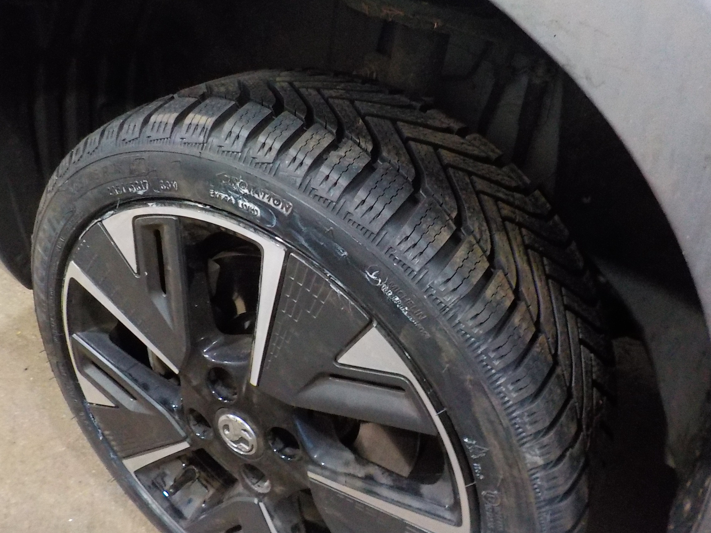

Michelin Alpin 6,
so not something you might want to run all year but i will for the next 2 years, they are not wearing 10,000 miles since fitted.

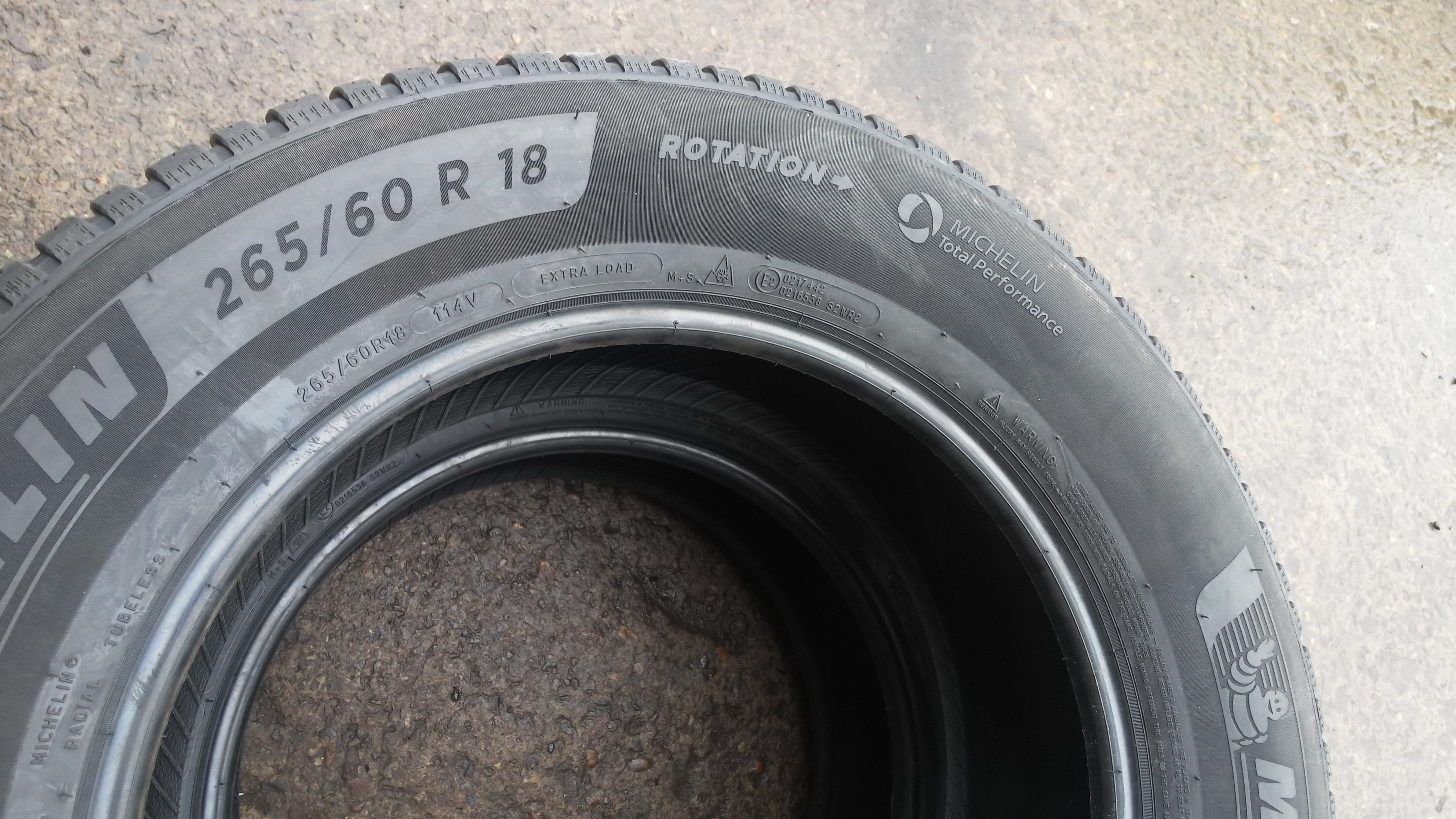

I have Michelin CrossClimate SUV.s on my SWB Shogun Van.  265/60 R 18" instead or the the standard wider 285/55 R 18's
I made a big mistake actually fitting these, but they are on so will stay, they are OK in the wet but really not good enough on snow.
If i was fitting 235 / 255 tyres (rears) to an EV it would not be CrossClimate + / SUV's that i would go with if going to be driving in snowy conditions or roads not getting well ploughed / gritted.

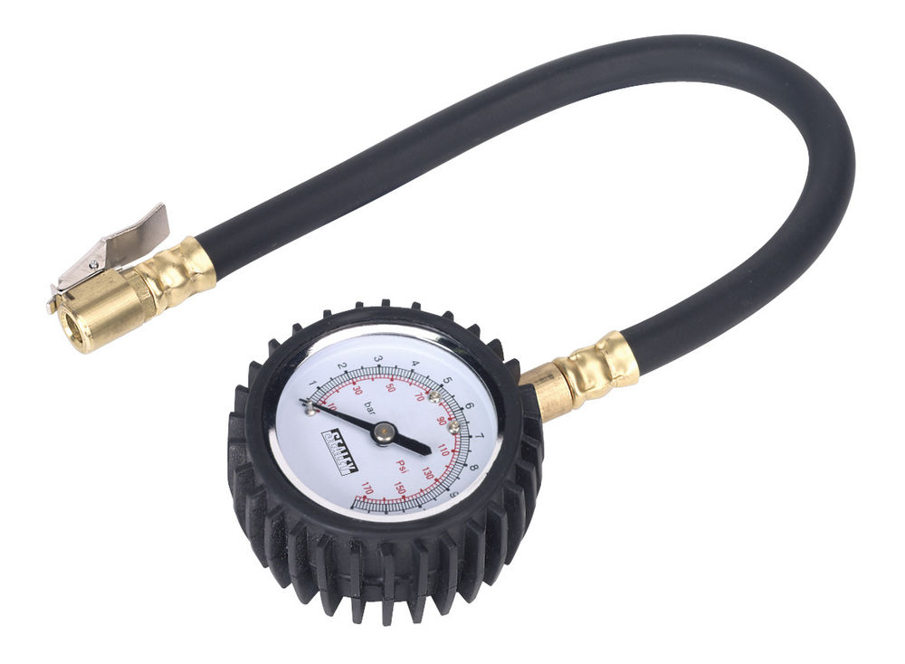

Right. I took tyre pressure readings with my hand-held tyre pressure gauge and that indicated an over-inflation, but to be sure, today I used a calibrated air line at a "local" garage.

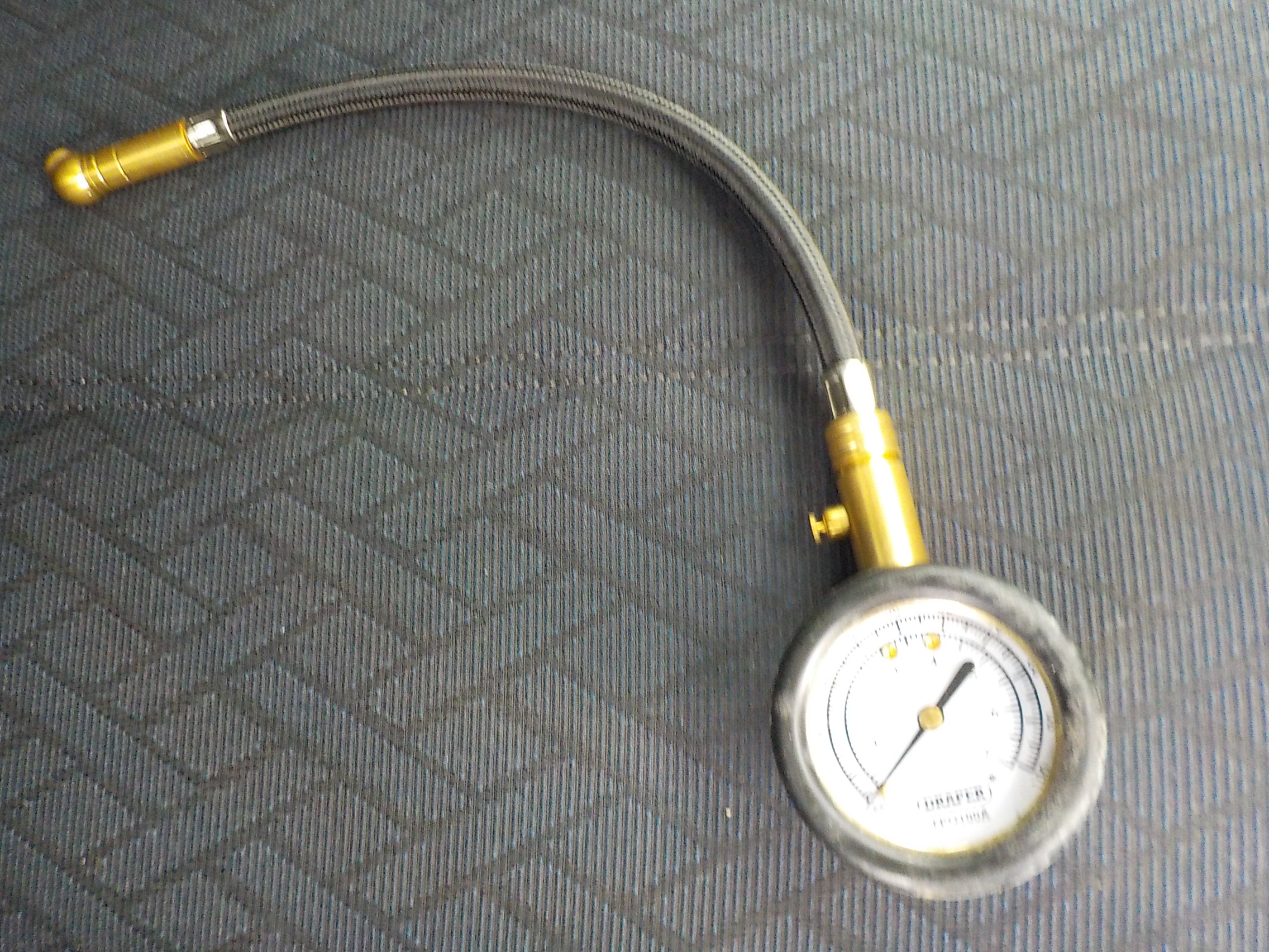

Don’t assume that any gauge is accurate. It may be consistent, but not absolutely “accurate”.
Not that it matters too much as consistency is all you need.
Once you discover what pressure on “your” pressure gauge works best for you then life is good.
@BoxerBoy  When paying 20 or 50 pence or £1 to a Multi National Company at their filling station they had better be accurate.
They are providing a service with the Air Compressors and people are trusting they are accurate.
They are checked and calibrated by the Forecourt Maintenance people.
Have you compared the pressure at a Pay to use Air Compressor with maybe your £12 digital or analogue pressure gauge and found the tyres showed a difference?
