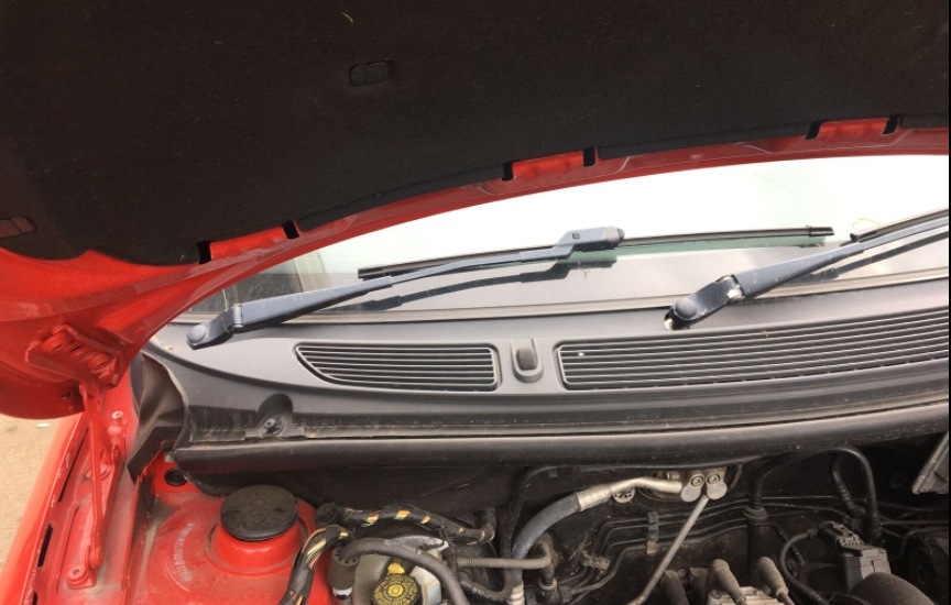

My guess is the linkage had failed as this is a fairly common issue. The little ball joints wear out and pop off and due to the way they are built (Upside down) They will always fall back off if you re-fit them. You can get new linkage arms for little money but they will fail again sooner or later. You can also buy little stainless steel clips which clip right over the linkages and stop a worn (Or non-worn, if you don't want the issue on a long journey) Linkage failing.
