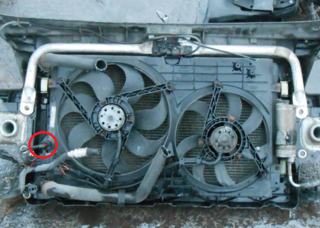

To confirm low speed function/disfunction you can unplug the loom connector from the radiator thermoswitch, and link pins 1 and 2, red/white to red wires. As long as  the relevant fuse is intact (giving 12V on pin 2), then both fans should start up at low speed.

This thing here, with the wires. :D
🤣 top man ... pics are better for me.. gonna give it a go tomorrow 👍
And, in Wino's post, based on my understanding of the Octy AC, the smaller (left hand) fan (on the right of that shot from the front) has a separate live feed from the AC power, so is always on low when the AC is on, regardless of what the radiator thermoswitch and the large fan are doing.
