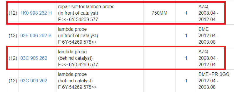

Can i have 1 more question about sensors? So there are 2 lambda sensors, one before and after the cat.
My question is are those 2 sensors physicaly identical? Do i have to buy a specific lambda sensor for pre cat or just any that fits my car and plug it in?
  • Sponsor
No, they are different. The pre-cat one has 5 or 6 wires, the post-cat only 4. the connectors are obviously different, as is the technology in the sensor itself.
Here are the part numbers assuming your car is engine code AZQ:

Good to know that my lambda sensors are different. I will have to check them.
