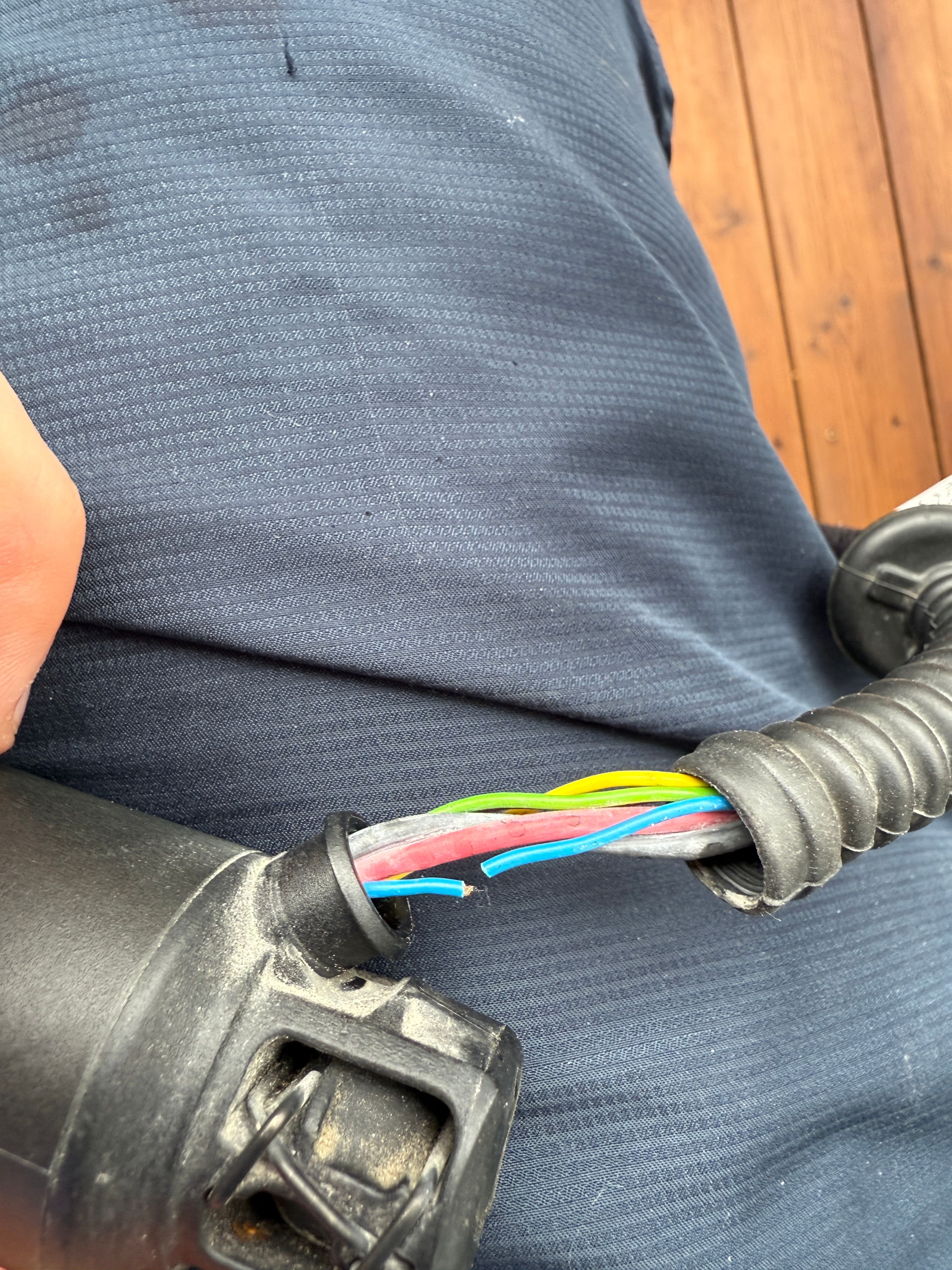

So my 2018 Superb L&K tailgate will not open or close anymore. It beeps 3 times. When the lid is closed and I try to open it with the remote control, it rises up to a maximum of 20 cm.
OBD11 gives an error message: Hall sensor in motor 1 for rear hatch - B121115
As far as I've briefly looked into the subject at the moment, it's possible that one of the wires is broken, so it's worth checking before buying new ones.
If you were to buy new ones, which manufacturer's product did you choose? I'd leave out OE, I don't see any reason to pay so much.
The new ones should be quiet and smooth! :)
Atm I'm looking at Stabilus 427627 - It is more expensive than other manufacturers, but it should be premium.
Just fix the wiring in the strut

Took the strut off and the blue wire is broken...I hop this is the issue. Going to solder it. Will post the result.
Edited by superbuser35
Yeah that’ll do it.

Update: I contacted an electronics specialist who repaired the broken cable. Then I reconnected it and it works again. Total cost 35€ - could have been cheaper, but I wanted to get it fixed today.
Really happy now D
Really happy now D
People jump to the conclusion you need to change the full strut when it’s just a wire. Bet you’re glad you posted and saved yourself some money 😅
